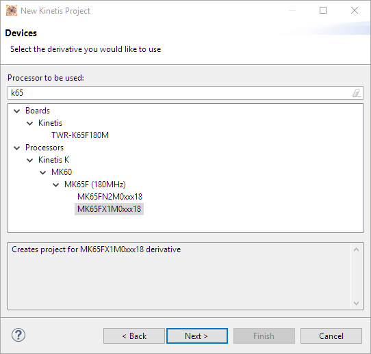

When will the following processor be added to the Processor Expert Suite?
Kinetis K65: 180MHz Cortex-M4F up to 2MB Flash (169pin) Applicable Parts:
Thank you.
The Microcontroller Driver Suite will not be extended with new parts lik the K65. You can use Kinetis Design Studio V3.x for this, see
https://mcuoneclipse.com/2015/06/28/tutorial-using-kinetis-design-studio-v3-0-0-with-iar-and-keil-id...
This offers (with the SDK V1.3) MK65 support:
With this, KDS v3.x (I recommend KDS V3.2, see https://mcuoneclipse.com/2016/04/02/nxp-kinetis-design-studio-v3-2-0/). Be aware that the future is with the Kinetis SDK and the SDK V2.0, see https://mcuoneclipse.com/2016/01/29/first-nxp-kinetis-sdk-release-sdk-v2-0-with-on-demand-package-bu....
I hope this helps,
Erich
Thank you Erich. I was able to access what I needed once I transferred to KDS V3.2 and installed SDK V1.3.
