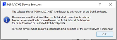

  1. About the Jlink version
The version after V7.50 will not support 8ULP.
One problem is the integrated Jlink in IAR is V7.66, so we need to downgrade it to V7.50.
In Jlink installed path, SEGGER\JLink\JLinkDLLUpdater.exe. After running the exe, Jlink in IAR will be changed to V7.50.
