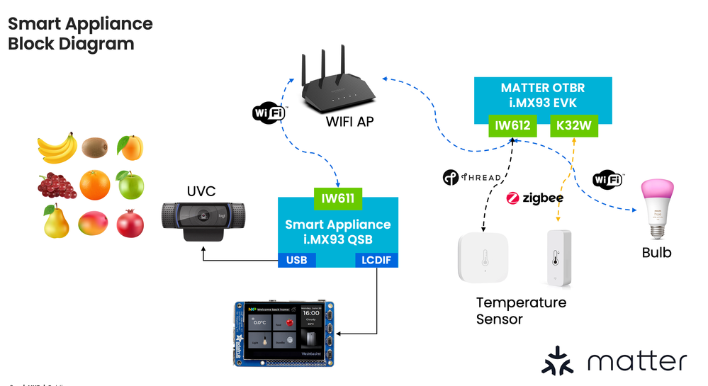

Overview
i.MX93 Smart Appliance PoC demonstrate and simulate a smart fridge by i.MX93 QSB platform, which supports low power, fast boot, lightweight GUI, AI vision for food refreshness check, MATTER connectivity and Voice control UI, etc.
Features and Block diagrams
截屏2024-11-18 14.47.53.png截屏2024-11-18 14.47.53.png截屏2024-11-18 14.48.01.png截屏2024-11-18 14.48.01.png

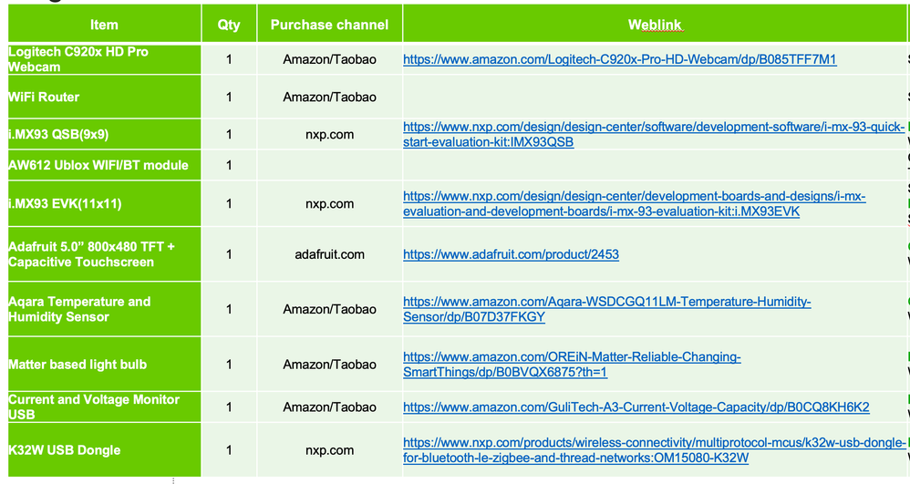

How to demo
HW list:
Guide:
Please check the README.md in https://github.com/nxp-imx-support/smart-appliance-lvgl
