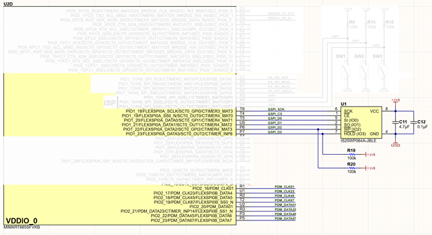

If you want to use all 8 channels of the DMIC interface,  FlexSPI B will not be available.  You must connect to FlexSPI A
I want all 8 microphone channels and wanted to make sure to clearly state this for anyone else considering the this scenario. Figure 2 shows how to connect a QSPI flash to the RT685.
Figure 2.  QSPI flash connection on the RT685.
As you can see, QSPI memory is simple to connect.    I am using a +1.8v flash device.  Typically, I arrange my schematic symbols to be group functions by power domain to reduce the chance of error.  In this case, VDDIO_0 will be powered by +1.8v from the PMIC.   I left the connections to DMICs highlighted so you can see the intersection with FlexSPI B.  MCUXpresso includes a pin tool that allows you to plan the device muxing/pinout to reveal any potential issues.  With every new hardware design, I create a skeleton MCUXpresso software project that gets included in my hardware design git repository.  The skeleton project’s sole purpose is to define all of my IO as I am working through the hardware design.

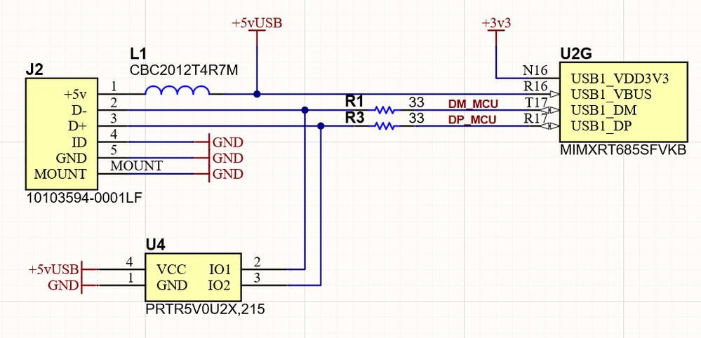

I cannot stress how important it is to have access to these pins!  In addition to the UART, I would also recommend having USB access as well.   The ROM bootloader enumerates a USB-HID device for access to the programming/test functions.    There are minimal parts required to enable the USB interface.   I always add some EMI filtering to the +5v VBUS line as well as some ESD protection to the D+/D- lines.
Figure 7.   RT600 Minimal USB Connections.

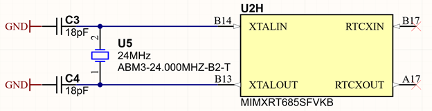

I do want to point out the minimal clocking configuration required by the ROM bootloader. A 24MHz crystal is required for correct USB operation.
Figure 8.   RT600 Minimal Crystal/Clock Configuration.
I am not using the RTC and elected to not connect a 32KHz crystal.        For the minimal configuration scenario,   a 24MHz crystal is the path to quick success.
