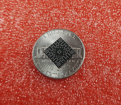

RT600 PCB Layout Consideration: The VFBGA176 Package

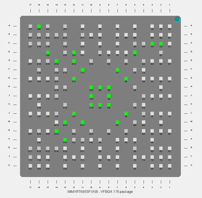

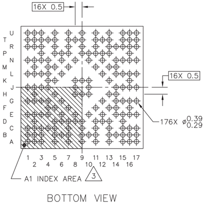

The first order of business when I approach a new hardware design is to understand the device package and any implications of the pin geometries.      For the Super-Monkey project, I will be designing with the MIMXRT685SFVKB which uses the VFBGA176 package.   The VFBGA176 is a 9mm x 9mm ball grid array (BGA) with 0.5mm pitch.     A fine pitch BGA package can be intimidating, especially for those who may only have experience with microcontrollers in QFP packages.   One of the reasons I built the “Mini-Monkey” was to demonstrate that the LPC55S69 VFBGA98 package option was doable with a 2-Layer process and low-cost design rules.   The VFBGA176 was designed to be easy to fanout and is routable with a practical 4-layer process.
Figure 1.     The VFBGA176 Package.
I enjoy studying unique BGA ball arrangements.   This package is a work of art.   Notice that this are several regions left unpopulated making it simpler to fan out.     In many cases, a 0.5mm BGA would require filled micro via-in-pad to fanout the IO.     There was quite a bit of thought put into the pinout of the RT600 and it is possible to fan this device out without via-in-pad technology.
Many of the balls on the interior are VSS connections.   Using the MCUXpresso pin tool, one  can highlight pins to get an get a rough sense of the layout strategy.

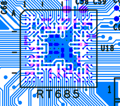

I spent some time analyzing the Gerber files from RT685EVK to get a feel for the layout.     The fanout of this package is very practical.
Figure 3:  RT600 VFBGA176 Fanout
Notice that *all* of the signal pads can be fanned out on the top layer.   The via connections (red dots) are to connect to the power & return planes on inner layers.       The vias are placed in the depopulated ball regions.      The IO fanout on the RT685EVK use 4.5mil width/ 5 mil space geometry.    The vias under the device package use 6mil drills.     These geometries are a bit tightener than what is typical required by traditional microcontrollers, but it is well within the capabilities of many PCB fab houses.     I believe the 6mil drill could possibly be increase to 8mil.  The Super-Monkey will not be using all the IO and I will be targeting a 4-layer design so routing should be straightforward.
Since the only vias use in the fanout are for power and returns, there is plenty of space to place decoupling capacitors on the opposite side of the PCB.     Figure 4 illustrates the placement of the decoupling caps on the RT685EVK.   They are nearby existing vias to direct feed the power planes.
 Figure 4:   RT6600 VFBGA176 decoupling capacitor strategy
Many 0.5mil pitch BGAs require via-in-pad technology along with blind/buried stack-ups so the fanout vias do not interfere with the decoupling capacitors on the opposite side of the PCB.  In the case of the VFBGA176, we can use lower cost processes as we do not need via-in-pad technology or a blind/buried stackup.    Fanout and decoupling capacitor placement is straightforward for the RT600 VFBGA176 package.  I really like to understand package geometry before I start a design as it can directly influence other decisions down the pipeline.   The time spent analyzing the Gerbers on the RT685EVK was well spent as I now have confidence the fanout of the part will not require any exotic PCB process technology.

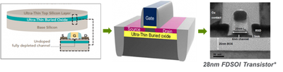

The RT600 crossover MCU power/performance ratio sits at an intersection of traditional MCUs, dedicated DSPs and application processors.     To get significant clock rate improvements over traditional MCUs,    the RT600 was built on 28nm FD-SOI process technology.   Using 28nm process technology for an MCU is a new concept that NXP has helped pioneer.
 Figure 5: 28nm FD-SOI Process technology.  Image Reference.
If you remember your EE300 coursework, all the major characteristics of a MOSFET are controlled by geometry.    FD-SOI process technology has many advantages, one being that we can bias the body of the MOSFETs dynamically.    Body biasing give us real-time programmatic control over the MOSFET threshold voltage VTH.      For MCU applications, we can move VTH up or down allowing one to increase clock frequency/performance or reduce dynamic power consumption.
From the perspective of production yield and desire increased CPU clock rates, the geometries of the transistors need to be pushed to their design rule minimums. A byproduct of small transistor geometries is a numerically small value for MOSFET VDS.        For 28nm FD-SOI process technology, the nominal MOSFET VDS has been characterized to 1.0v nominal.    This means the “core” logic needs powered from a 1.0v supply.

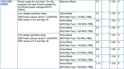

RT600 Core Power

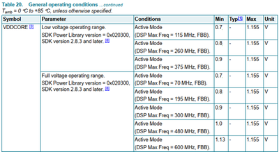

VDDCORE is used to power the internal CPU(s) and core logic.   To maximize clock rate, the CPUs and core logic are constructed from the smallest transistors allowed by the process technology design rules.    In the case of the RT600 and 28nm FD-SOI, the core voltage is nominally 1.0v.    Looking at the RT600 datasheet, the maximum allowed value does not give one much room for error in your power supply!
It is possible to operate the core power at values than 1.0v as to save power when using lower clock frequencies.   NXP provides a power library which can tune the body bias to achieve low power consumption figures at lower clock rates.
The take-away here is that by providing a separate core power supply access, the designer has flexibility in how to optimize for a particular use case.  It is important to note that the RT600 include an LDO that can be powered from a +1.8v rail.   Use of the LDO is not required but is available if the efficiency of a switching power supply is not required.

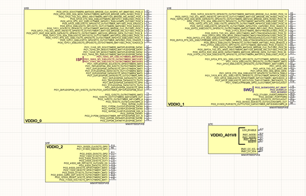

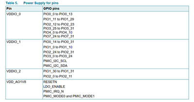

User IO
Lastly, the IO pins can be powered separately from the +1.8v functions and the core.  The IO supply range is +1.71 to +3.6v with +3.3v being the most common.   There are other circumstances however when you may want certain IO pins to use +1.8v.   For example, many high-speed double data rate quad/octo NOR flash devices operate with a +1.8v power supply.    The RT600 has 3 separate IO banks so you can have a mix of IO voltages. In a minimal configuration scenario, it would be possible to power all the IO from +1.8v reducing the number of DC-DC converters needed in a system.   However,  it is most likely one will require some IO at +3.3v.
It is important to understand all the IO power options at the outset of a design.    It is easy to make a mistake and end up with a non-functional part design.      For my own designs, I take extra steps in the schematic entry stage to ensure success.    I like to break up the schematic symbol for a part based upon a particular voltage domain.  This makes design reviews much simpler as it is easier to spot a mistake.   For example, reset in the RT600 is in the +1.8v “always-on” domain.  Make sure it is clearly marked so you do not pull it to +3.3v!
Figure 6: RT600 IO Schematic Blocks

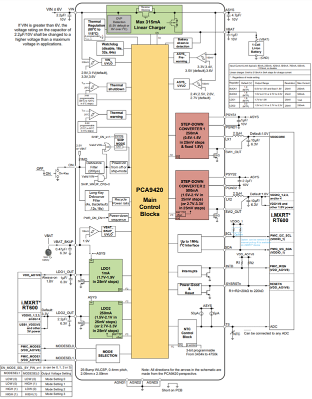

The power architecture for the RT600 is more complicated than a traditional single voltage rail MCU as a result of its flexibility.    However, once you understand the architecture, the application design is straight forward.     For example, in a minimal configuration that requires +3.3v IO, one could power the RT600 with +3.3v and +1.8v using the internal LDO for the core.
NXP offers an integrated solution that makes powering the RT600 much simpler: the PC4390 Power Management Integrated Circuit (PMIC).     A PMIC is essentially a handful of DC-DC converters, LDOs and control circuitry integrated into a single package.

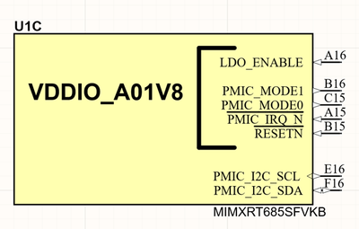

 Figure 7:  The PCA9420 PMIC
In the case of the PCA9420, it has been specifically designed to power the RT600.   The out of the box configuration will perform all the necessary sequencing to bring up the device correctly.     It is package in a 24-pin QFP package which is extremely compact given the number of functions it is providing.    The PCA9420 also provides reset control and has an I2C interface that allows the supplies to be tuned for the different clocking configurations.
 Figure 8.  RT600 Dedicated PMIC Interface
I highly recommend using the PCA9420, especially if this is the first design iteration using the RT600.    A designer is certainly free to use other power management solutions but the PCA9420 is a path to ensure success.  If your application requires any power management and sleep functions, then the PCA9420 is an optimum choice.  The Super-Monkey design will be using the PCA9420 to simplify the power supply.  I plan on using the PCA9420 on the Super-Monkey as the module will powered with a single +5v rail.
