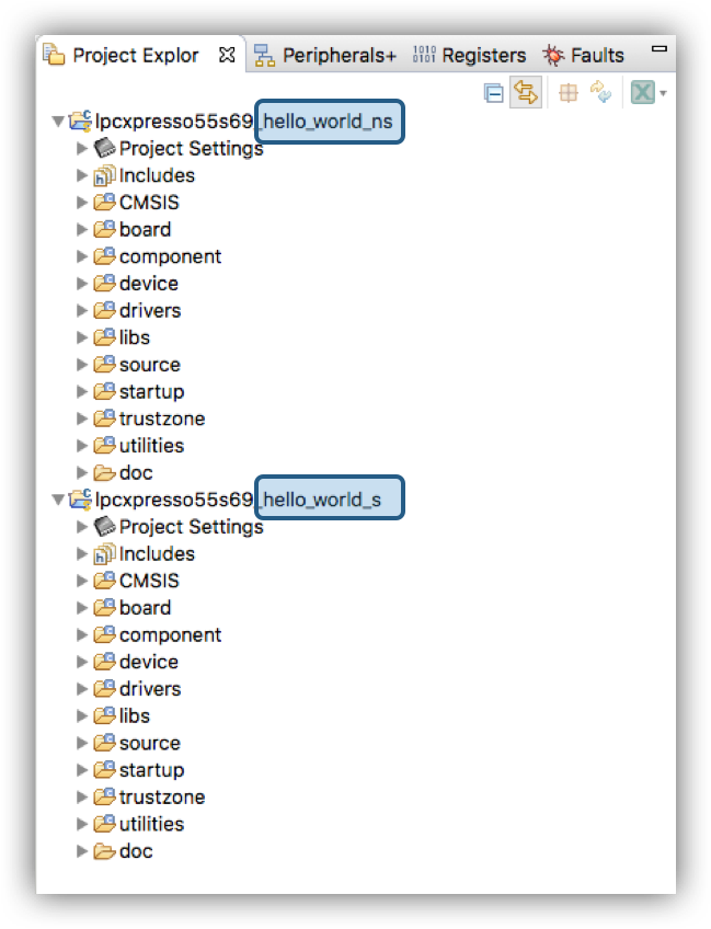

Importing (Linked) Example Project
First, ensure you have installed version SDK version 2.6 for the LPCXpresso55S69 EVK board into MCUXpresso IDE. Once installed it will be visible within the Installed SDKs view and its version shown as below:
From the Quickstart view, launch the 'Import SDK example(s)' Wizard, then select the LPCXpresso55S69 board and click <next>
Expand the trustzone examples and click either of the Hello World projects. Since these projects are linked, both the Secure (_s) and Non Secure (_ns) examples will be selected. Click <finish> to start the import.
Note: Linked projects are coloured yellow within the wizard. This project linkage is set because the Non Secure project relies on Secure project for access to allowed Secure operations (calls). Where as the Secure project references the Non Secure project for debug operations (flash programming).
Once imported, you will see the Project Explorer view contains the projects as expected.

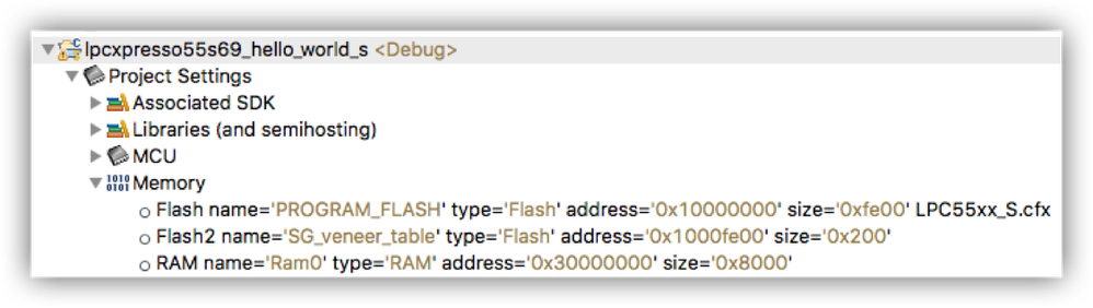

Memory Configuration
The memory allocation of each project can be seen in the Project Explorer view by opening the Project Settings Node and then the Memory Node. From here you can see the input memory ranges set for the managed linker script mechanism (for each project):
Apart from the veneer table, these projects can be considered as separate entities and must have non overlapping memory regions.
Secure: A feature of the address space security is that the setting of address bit 28 signifies a secure location (odd numbers in the most significant nibble).
The flash region PROGRAM_FLASH at 0x10000000 specifies the secure LinkServer flash driver LPC55xx_S.cfx.
The SG_veneer_table block at 0x1000FE00 is used for code to provide a gateway to (certain) secure functions and inherits the same flash driver. Note: the name SG_veneer_table is a 'magic' string recognised by the IDE as an option for veneer placement (see later)
Non Secure: For these addresses, bit 28 is not set signifying non secure locations (even numbers in the most significant nibble)
The flash region PROGRAM_FLASH at 0x10000 specifies the non secure LinkServer flash driver LPC55xx.cfx.

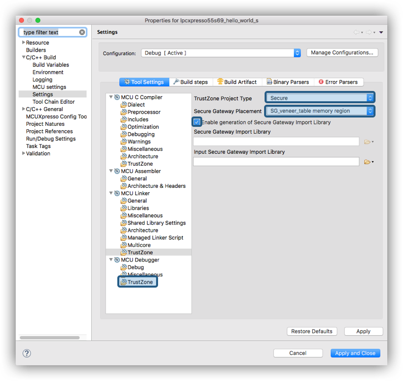

Project Properties
Trustzone capable MCUs have a number of dedicated Project Properties primarily addressing linkage and debug.
A project set to be Secure will have further options available, including a setting for the location of the Secure veneer table, and check box to cause the generation of the Import Library. An additional Secure Gateway Import Library can also be specified.
Secure: Below is shown the MCU Linker -> Trustzone properties dialogue.
Note the Secure Gateway Placement (Secure veneers to shared secure operations) is set to use the 'magic' flash memory region (mentioned in the previous section) for placement.
Also observe the MCU Debugger -> Trustzone option. If used (as in this example), this takes the name of the associated non secure project which will then automatically be (built and) programmed when the Secure project debug operation is performed. In addition the symbols for this associated project will be added to allow source level debugging of both projects.
When selected, it will look like below:
Non Secure: Below is shown the MCU Linker -> Trustzone properties dialogue: Note the Secure Gateway Import Library references the Secure projects generated library location.

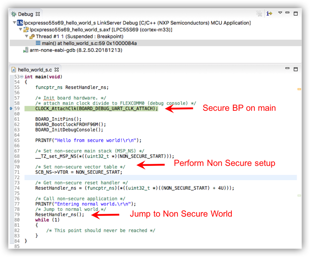

Once programming is complete, you should arrive at the default Breakpoint on main within the Secure world as below:
Click Run and this project will first perform some board/MCU initialisation, print a greeting (as below), then setup the environment for the Non Secure project to execute.
Note: this step is necessary because the non secure project is not run from reset, so cannot rely on the default hardware behaviour for initialisation of Stack, Interrupt handlers etc. This is essentially the same operation that a bootloader would perform.
Next, a jump will be made to the Non Secure world.

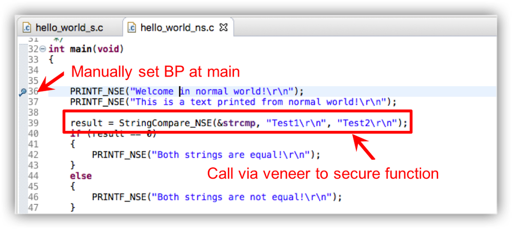

Note: since the non secure project is not debugged directly, it will have no default breakpoint on its main function. To explore the execution, it is recommended to open the Non Secure projects Source -> hello_world_ns.c and manually set a breakpoint as shown below:
Reminder, since we have the option set to enable the pre-programming of the Non Secure binary this also enabled the loading of Non Secure symbols (which can be observed in the Secure projects debug launch configuration (shown below). It is the loading of these symbols which enables source level debug of the Non Secure project while we are actually debugging the Secure project.

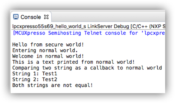

Finally, click Run to run this example to termination and observe the output.
Note: the significance of this example is that the String Compare operation was supplied to the Non Secure project by the Secure project and accessed securely via the Non Secure Entry (NSE).
