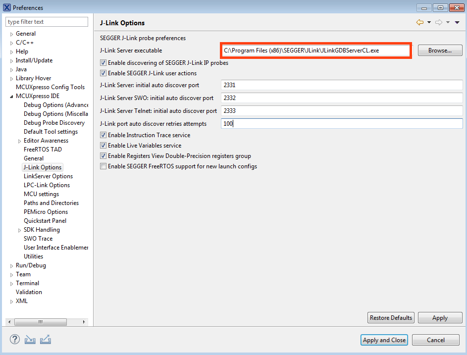

A user installs and wishes to use a newer version of SEGGER J-Link with MCUXpresso IDE
Previously, when a new workspace was created, the newest SEGGER installation would automatically be selected for use. Alternatively, Windows -> Preferences -> MCUXpresso IDE -> J-Link Options -> Restore Defaults could be used to automatically search for the latest installation and update the path to the required server.
Now to use the new install the user must manually browse to the new server location via the preference at:  Windows -> Preferences -> MCUXpresso IDE -> J-Link Option and select:
C:\Program Files (x86)\SEGGER\JLink\JLinkGDBServerCL.exe
This must be done for any existing workspace or when a new workspace is chosen, otherwise the most recent install using the old scheme will be selected for use.
All existing SEGGER J-Link installations have been uninstalled and a new installation has been performed
Previously, the IDE would have recognised that its SEGGER path information was incorrect and automatically searched for a latest install. However, this mechanism will not find an installation using the new default location. Therefore the user must manually browse to select the Server as described above.
