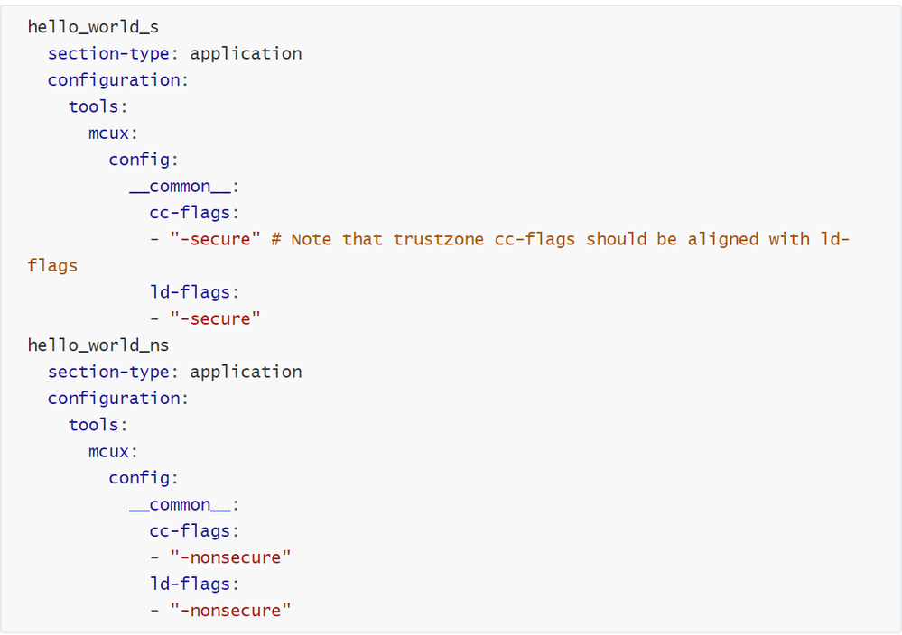

To configure trustzone feature for mcuxpresso IDE, you need to add cc-flags and ld-flags like this:
cc-flags and ld-flags could be set to:
  • -secure
  • -nonsecure
  • -none
These flags will be set in mcuxpresso IDE:
