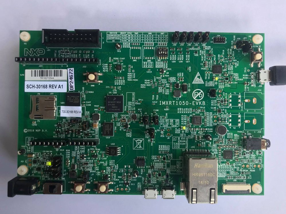

In order to extend the usage of this Operating System, we created support for a new board: the i.MX RT 1052 EVKB, which features an ARM Cortex-M7 processor with a 600 MHz frequency and up to 512 kB Tightly Coupled Memory.

4. The result
Through this process, we managed to create a working Tock OS instance on the i.MX RT 1052 EVKB board and created a pull request on Tock OS github in order to make the code be available for everyone to use. The functionalities implemented were tested using a simple C application in userspace, with which we interact through the serial line (using the Lpuart module) and through which we can turn the User LED on or off using the GPIO module (Figure 2), or print information from the accelerometer sensor (through the I2C module).

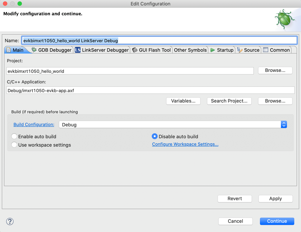

In order to flash the application on the board, we need to use the MCUXpresso IDE and the SDK for the IMXRT1050 board. We import an SDK example such as Hello World in order to generate the hierarchy for the project. Next, we copy the app image from target/thumbv7em-none-eabi/debug/imxrt1050-evkb-app.axf to the Debug folder in MCU Expresso via drag and drop (Figure 3).
Figure 3. Importing the app image.
Afterwards, we modify the LinkServer in order to point to the Tock OS binary instead of pointing towards the hello_world example as depicted in figure 4.
Figure 4. Edit LinkServer.
Finally, we simply press debug in order to flash the application on the board and enjoy!
