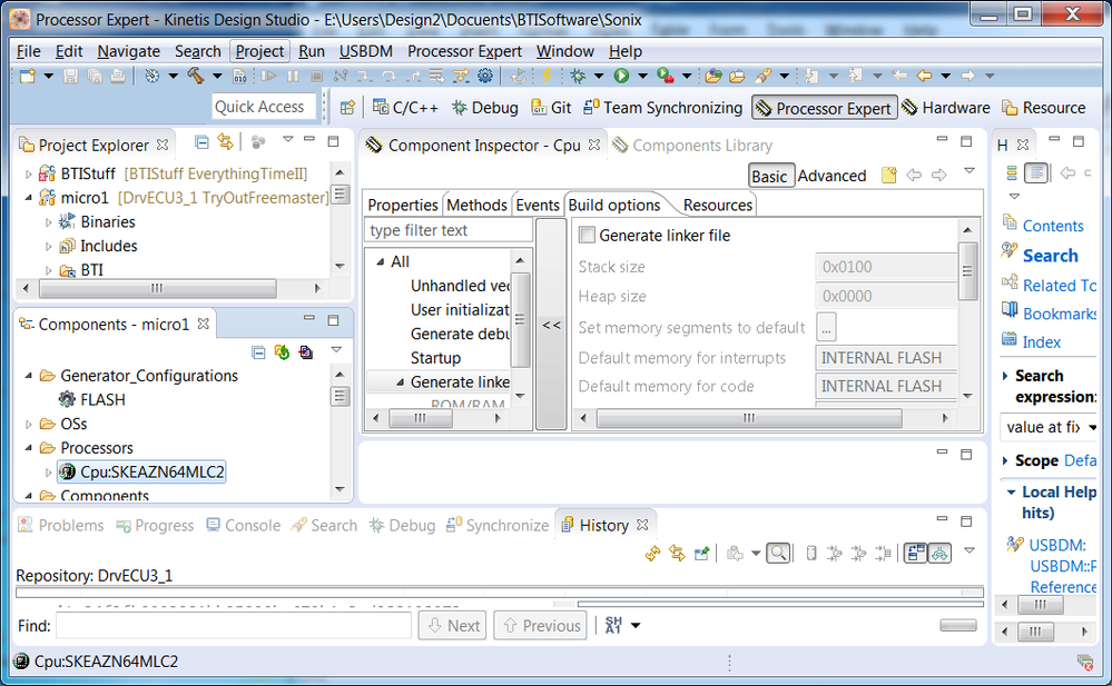

Figure 1: The processor expert tab with the processor selected
Go to the processor expert tab and click on your processor. In my case the processor is a SKEAZN64MLC2.

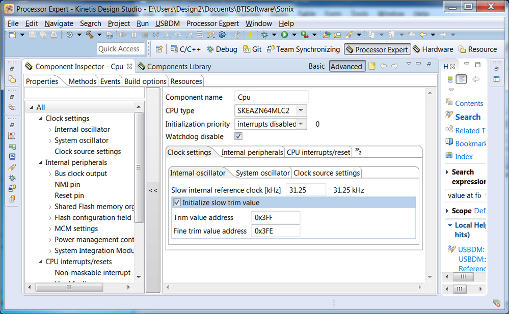

Figure 2: Adding code to initialize trim values from known memory locations
Maximize the component inspector so that you can see all the settings. Click on the Advanced tab, and put a check mark in the “Initialize slow trim value” box.
Clicking the “Initialize slow trim value” box writes the following code in the generated file CPU.c in order to load the trim value from addresses 0x3FE and 0x3FF.
if ( *((uint8_t*) 0x03FFU) != 0xFFU) {
ICS_C3 = *((uint8_t*) 0x03FFU);
ICS_C4 = (ICS_C4 & 0xFEU) | ((*((uint8_t*) 0x03FEU)) & 0x01U);

Still in processor expert with your processor selected, go to the build options tab and select Generate linker file. If the check box for "Generate linker file" is not checked check it (after saving your linker file by checking it into git so that you can compare changes and restore any prior modifications). Add a Rom/Ram area by clicking on the “+” button—my new section is called “m_init_clks_debug”. Set the qualifier to RX so the linker knows it is for flash memory. Since memory is in 4 byte units on this chip, set it at address 0x3FC and make it 4 bytes long.
Adding the line to the ROM/RAM areas in the CPU component declares a memory location for a new section by adding the line
m_init_clks_debug (RX) : ORIGIN = 0x000003FC, LENGTH = 0x00000004
to the linker file ProcessorExpert.ld,

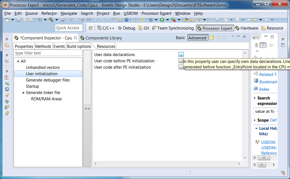

Initialize the memory locations.
Figure 4: Initializing the memory location values.
Go to the Build-options tab and select the filter User initialization. Click the three dots next to User data declarations to brings up a dialog where data declaration code can be written. Fill in the dialog with
const __attribute__ ((section (".init_clks_debug"))) uint8_t dbg_clk_init[4] =
0x00,
0x00,
0x00,
0x9A
to create an array "dbg_clck_init[4]" in section ".init_clks_debug" and initialize its values in memory. The value 0x9A is the trim value, which will be unique for each chip.
Code written in the “User data declarations” dialog box is written in the beginning of the CPU.c file every time the component is regenerated. If you add the code manually to the CPU.c file, the code will be erased each time the file is regenerated.

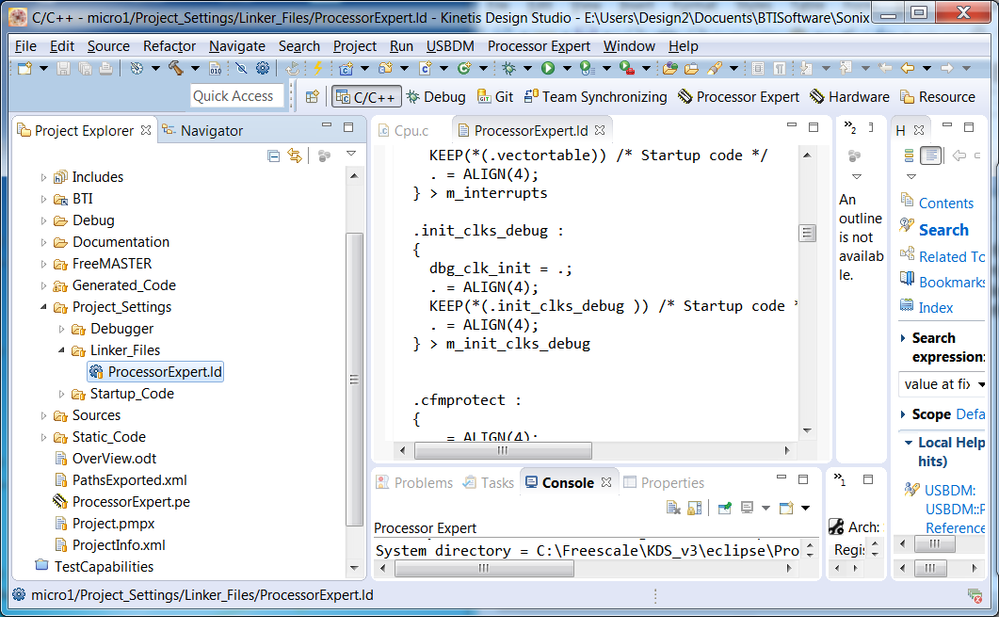

Make the ".init_clks_debug" section in the linker file.
Figure 5: Editing the processor expert linker file
I have found no way to do this through processor expert, so generate your processor expert code to add all the changes made in the earlier steps into your generated c code. Then go back to the <Processor Expert> <Build Options><Generate linker file> tab (Figure 3) and un-check the “Generate linker file” check box. This will prevent further modification of your linker file, and allow you to create the necessary section manually.
Open the linker file and add the following code to create the necessary section to put your initialized dbg_clk_init array into.
.init_clks_debug :
dbg_clk_init = .;
. = ALIGN(4);
KEEP(*(.init_clks_debug )) /* Startup code */
. = ALIGN(4);
} > m_init_clks_debug
