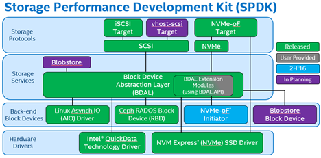

Following is the software stack of SPDK:
Subcomponents
NVMe Driver
   lib/nvme
Provides direct, zero-copy data transfer to and from NVMe SSDs. It controls NVMe devices by directly mapping the PCI BAR into the local process and performing MMIO. I/O is submitted asynchronously via queue pairs.
NVMe over Fabrics Target
   lib/nvmf
User space application that presents block devices over the network using RDMA. It requires an RDMA-capable NIC with its corresponding OFED software package installed to run.
iSCSI Target
   lib/iscsi
Implementation of the established specification for block traffic over Ethernet. Current version uses the kernel TCP/IP stack by default.
Block Device Abstraction Layer
   lib/bdev
This generic block device abstraction is the glue that connects the storage protocols to the various device drivers and block devices. Also provides flexible APIs for additional customer functionality (RAID, compression, dedup, and so on) in the block layer.
It defines:
  • a driver module API for implementing bdev drivers
  • an application API for enumerating and claiming SPDK block devices and performance operations
  • bdev drivers for NVMe, malloc (ramdisk), Linux AIO and Ceph RBD
Blobstore
   lib/blob
A persistent, power-fail safe block allocator designed to be used as the local storage system backing a higher level storage service, typically in lieu of a traditional filesystem.
This is a virtual device that VMs or databases could interact with.
BlobFS
   lib/blobfs
Adds basic filesystem functionality like filenames on top of the blobstore.
vhost
   lib/vhost
It extends SPDK to present virtio storage controllers to QEMU-based VMs and process I/O submitted to devices attached to those controllers
Event framework
   lib/event
A framework for writing asynchronous, polled-mode, shared-nothing server applications.
