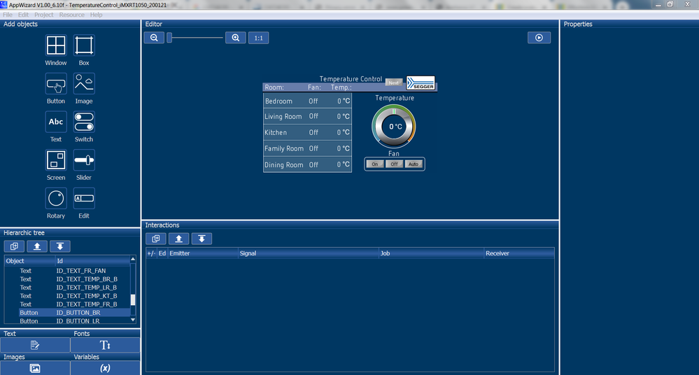

The purpose of this Blog is to assist new users of the AppWizard to create and run their first project. The AppWizard is a tool for creating complete and ready-to-use emWin applications. The tool makes it very easy to build an application, manage resources and even define the application’s behavior.
Managing resources of an application is also made incredibly easy since the user simply has to add their resources to the project. All of the rest is done by the AppWizard, this means the user doesn’t have to fiddle around with dozens of resource files anymore.

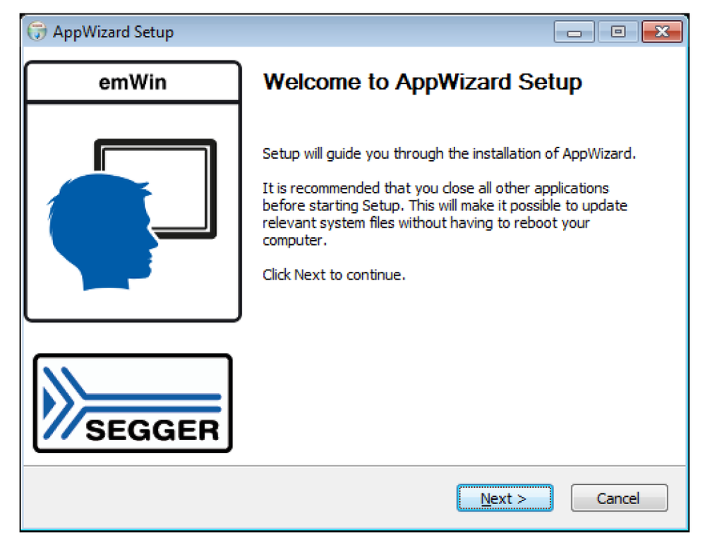

Installation
You can find the download link for the Tool from the below link.
NXP emWin Libraries | NXP
To install the AppWizard, simply run the setup wizard which will guide you through the installation. It comes with all required components without having to download nor install further tools.
