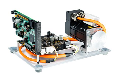

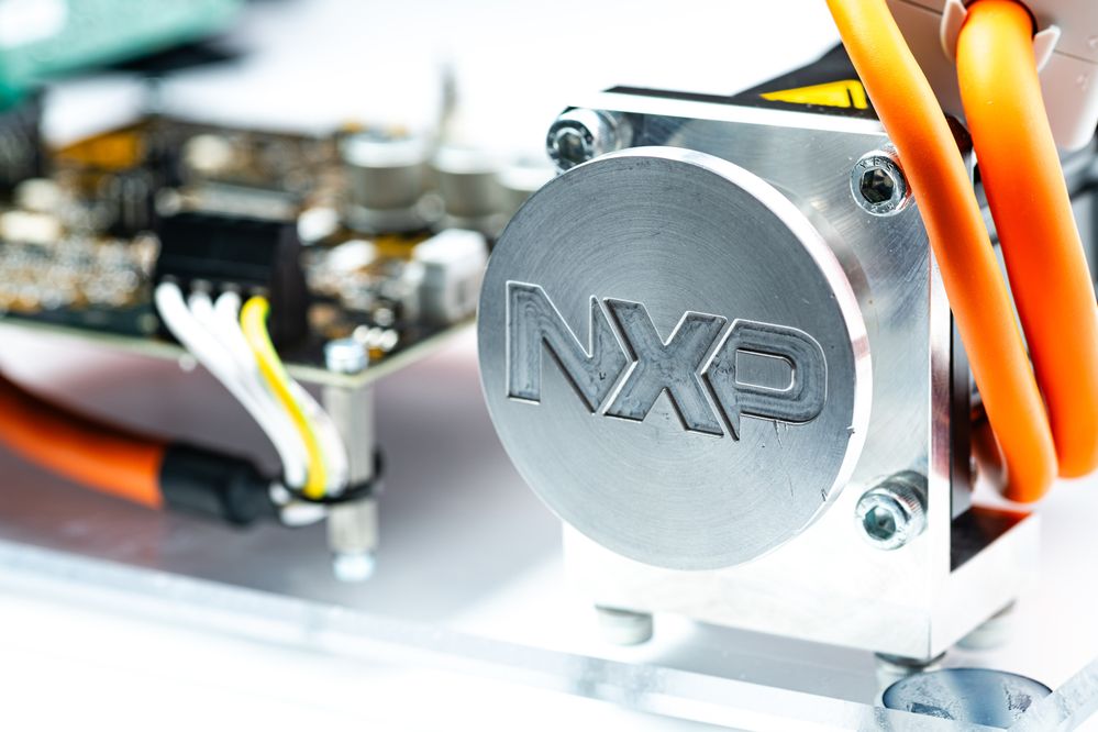

The S32K396 motor control kit with 3-phase PMSM is the newest version of NXP's motor control kits. It creates compatibility between the 3-phase low voltage source inverter and NXP's S32K396 MCU, which is part of the S32K39/37/36 family for electrification applications. The power stage incorporates the MC33937 3-Phase Field Effect Transistor Pre-Driver, offering a comprehensive set of functions and condition monitoring capabilities. The following are the main features of the motor control kit:
 Fig. 1. S32K396 motor control kit with 3-phase PMSM
SYSTEM CONCEPT
The system is designed to drive a 3-phase PMSM, using the following NXP components:

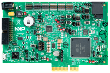

  • Designed for compatibility with the S32K396 (see Fig. 2)
Fig. 2. S32K396 microcontroller for electrification applications

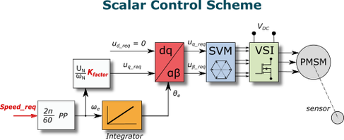

SCALAR CONTROL
The Scalar Control (see Fig. 4) is primarily used to debug the position sensor signals and verify the phase currents measurement since these variables do not provide any feedback to the control structure. The input to the scalar control scheme is the required speed in rpm (Speed_req) which is further recalculated to the required electrical angular velocity ωe in rad/s. This variable is multiplied by Kfactor to provide the required q-axis voltage uq_req for the PMSM and also integrated to receive the required electrical position θe needed for the Inverse Park Transformation. The required d-axis voltage ud_req is set to zero which means that the stator voltage lies in the motor q-axis. The dq voltages are then further transformed with the Inverse Park Transformation to the stationary reference frame αβ. These voltages are inputs into the Space Vector Modulation (SVM) to create duty cycles for the Voltage Source Inverter (VSI) which provides PWMs for PMSM.
 Fig. 4. Scalar Control structure

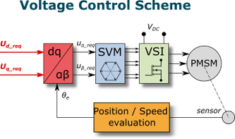

VOLTAGE FOC
The Voltage FOC can be turned on when the position sensor signals are debugged properly in Scalar Control. As evident from Fig. 5, the feedback from the position sensor is now set back to the Inverse Park Transformation to transform required dq voltages to the stationary reference frame αβ. Requesting the d-axis voltage ud_req, the PMSM will align to the nearest d-axis position. Requesting the q-axis voltage uq_req, the PMSM will start to spin in a forward or backward direction based on the amplitude of the required voltage.
  Fig. 5. Voltage FOC structure

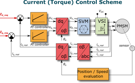

CURRENT FOC
In the Current FOC, dq currents are used as feedback to the control loop. Firstly, phase currents in the 3-phase stationary reference frame abc need to be transformed to the 2-phase stationary reference frame αβ using the Clarke Transformation. Afterward, the Park Transformation needs to be employed to transform the αβ currents to the rotational reference frame dq. In this reference frame, the currents are DC values and can be easily controlled by simple PI controllers. In the Current FOC scheme, the application user can choose to control d- or q-axis current. Requesting the d-axis current, the PMSM will align to the nearest d-axis position similarly as in the Voltage FOC scheme. Attention needs to be paid when choosing the required q-axis current. Firstly, it is recommended to hold the shaft of the PMSM before demanding any current in the q-axis. Afterward, the required q-axis current can be demanded, which will provide torque to the PMSM. Thus, the machine will try to rotate in a forward or backward direction based on the amplitude of the required current. The measured q-axis current Iq_real can be compared with the required q-axis current Iq_req in the FreeMASTER project panel as well as the d-axis currents.
  Fig. 6. Current FOC structure
In the Current FOC, the feedback currents can be calibrated with the real currents measured on the shunt resistors of VSI. Requiring the d-axis current will align the rotor to the d-axis position. Since the d-axis position is aligned with phase a, the measured d-axis current as watched in the FreeMASTER should be the same as the current measured directly on phase a of VSI. If not, the current scales should be calibrated properly for accurate FOC operation.

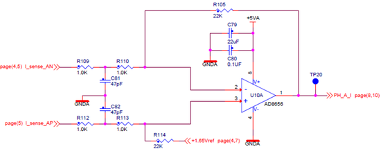

Fig. 9 shows a gain setup and input signal filtering circuit for the operational amplifier which provides the conditional circuitry and adjusts voltages to fit into the ADC input voltage range.
 Fig. 9. Phase current measurement conditional circuitry
