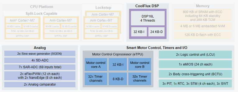

Motor Control on S32K39 Using the eTPU
The Enhanced Time Processing Unit (eTPU) is a programmable I/O controller with its own core and memory system, allowing it to perform complex timing and I/O management independently of the CPU. The eTPU module is a peripheral for 32-bit S32K39 Electrification MCUs.
The eTPU is used as a co-processor, specialized for advanced timing functions, such as motor control.
It has 2 engines each with 32 channels. The eTPU core is capable of running at frequency up to 320MHz.
Fig. 1: Subset of S32K39 block diagram showing the motor control peripheralsFig. 1: Subset of S32K39 block diagram showing the motor control peripherals
S32K39's eTPU is the most advanced design we have had:
  • The highest clock frequency
  • The largest memory sizes
  • Supported by professional, production-ready, safety qualified, software drivers (early access release available, RTM release available from 07/2024)

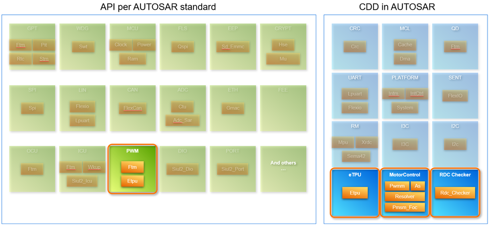

eTPU SW Overview
Four plugins are available as Real-Time Drivers (RTD) to speed up enablement using the eTPU:
  • eTPU – provides initialization and configuration of the eTPU global setting, e.g. clocks.
  • MotorControl – provides main motor control functionality such as PWM generation, Analog Sensing, Resolver processing, Field-Oriented Control and Quadrature Decoder for encoder processing.
  • RDC Checker - Safety Mechanism for resolver position reading. RDC Checker algorithm runs on CPU and checks the resolver processing of the eTPU.
  • Pwm – provides general purpose PWM generation. The generation may be done either by the eTPU or other timer peripheral available on the MCU.
Fig. 2: eTPU SW Plugins as part of Real-Time Drivers (not a complete list)Fig. 2: eTPU SW Plugins as part of Real-Time Drivers (not a complete list)

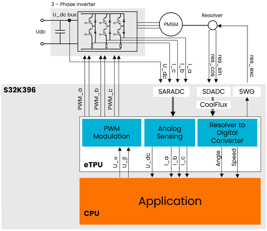

 2. I/O functions are running on the eTPU and FOC control is running on CPU.
Fig. 4: Block diagram of motor control application with control running on CPUFig. 4: Block diagram of motor control application with control running on CPU
Arbitrary combination of MotorControl functions running on the eTPU is possible. For example:
  • Analog Sensing and Resolver running on the eTPU. PWM may be provided by different peripherals.
  • Just Resolver on the eTPU. All other functions are provided by CPU and available peripherals.
  • Or others.

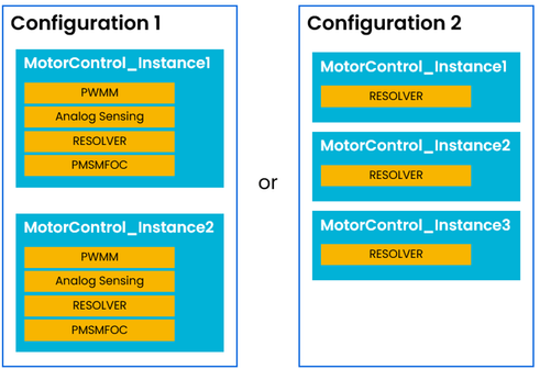

Motor Control Instances Concept
Each motor control instance can consist of one or more function blocks described above – PWMM, AS, RESOLVER, QD, PMSM FOC.
MotorControl plugin then supports configuration of one or more motor control instances, that may be unique. The most common usage would be dual PMSM motor control (configuration 1). Configuration 2 on the figure below shows 3 motor control instances processing signals for 3 physical resolver sensors.
Fig.5: Examples of possible MotorControl plugin configurationFig.5: Examples of possible MotorControl plugin configuration
