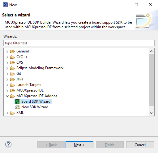

Starting from another SDK, you must first create a new project and adapt it for your own board (with updated pins/clock settings), making any board related changes by adding/modifying files in the project’s board folder. Once the changes are completed, in order to create a board SDK, select File -> New Project… from MCUXpresso IDE’s menu bar and select Board SDK Wizard under MCUXpresso IDE Addons category.

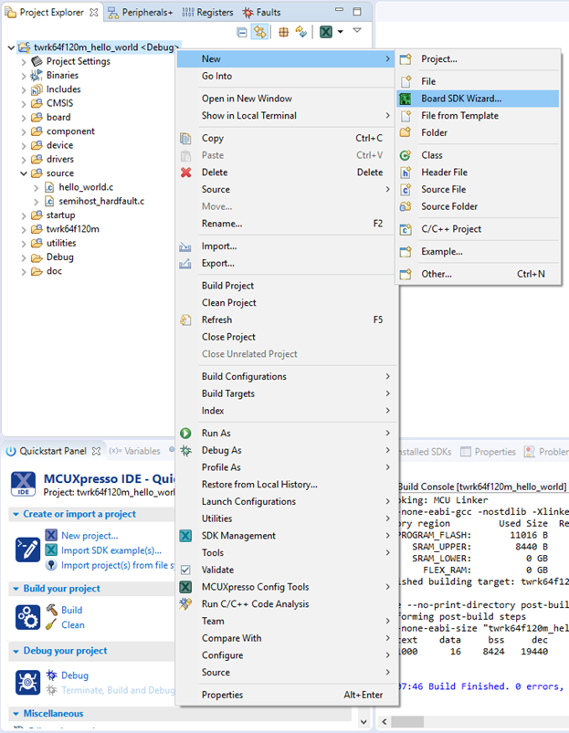

The wizard is also available in the right-click menu in the project explorer.

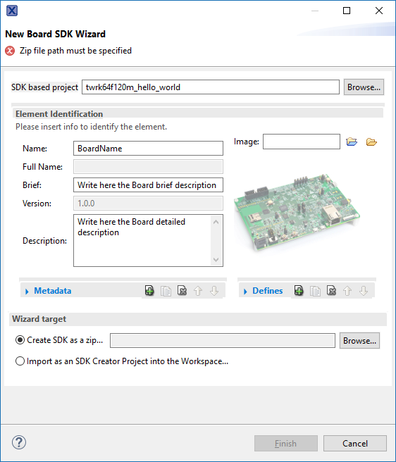

Once started the following dialog will be shown.

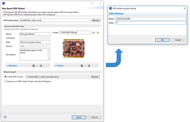

The base project will be automatically set if it was already selected in the Project Explorer view. The user interface allows you to define a few basic characteristics of the new SDK being created, such as the name of the custom board, an image of the board, and both brief and more detailed descriptions.
If the code requires new C/C++ preprocessor definitions, you can add them using the Defines section
Once everything is completed you can choose one of two options under the Wizard target section. The first option asks for a name and location for the SDK zip file.  The second option will open the newly created SDK as a project into the current workspace in MCUXpresso IDE, allowing for more advanced customizations of the SDK.

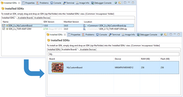

 After selecting first option and pressing “Finish” button, the SDK will be automatically imported into the IDE and a zip file for it will be generated. In order to install it on other computers, simply drag & drop the newly created SDK over the “Installed SDKs” view. Note: original SDK (the one used to create the custom SDK) must have been installed first (the image below shows this, with a custom SDK built from the Kinetis K64F Tower Board SDK.)

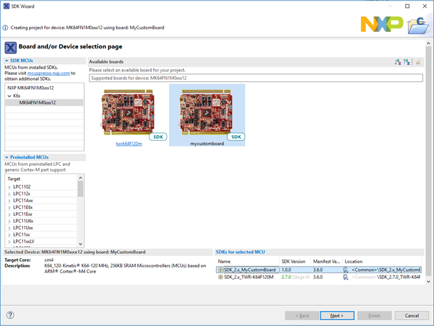

Once installed you can create a new project using the new SDK. The new SDK will appear in the SDK Wizard dialog, as seen for standard SDKs from NXP (see example below).
From the SDK Wizard select the new board, making sure to select the new SDK in the “SDKs for Selected MCU” section (bottom right corner of the window). Choose “Next” and “Finish” to close the wizard and close the project. The project will contain all the changes you have made in order to support your custom board.
