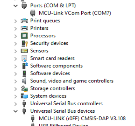

The Getting Started guide for the MCU-Link Debug Probe is currently the latest version. However, there is a small change in section 1.3 of the guide.
Section 1.3 of the guide refers to an older version of drivers used. The current release for MCU-Link firmware uses WinUSB instead of HID for higher performance. When referencing section 1.3 in the Getting Started guide, the user will not see the MCU-Link devices enumerate under HID devices in device manager (for Windows hosts) unless running an older version.
Instead, the user can verify by examining in USB devices as seen below:
If you are using an older version of MCUXpresso IDE, please reference page 6 of the MCU-Link user manual for compatible versions. This user manual is available for users to download in a pdf version for quick reference.
