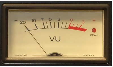

To kick the proverbial tires, I wanted to put together a simple demonstration using the available I/O on the Mini-Monkey Since the Mini-Monkey has a MEMs microphone, I thought that building a simple audio VU Meter using the LVGL gauge widget would be an effective demonstration.
Figure 1.  A "Classic" VU Meter

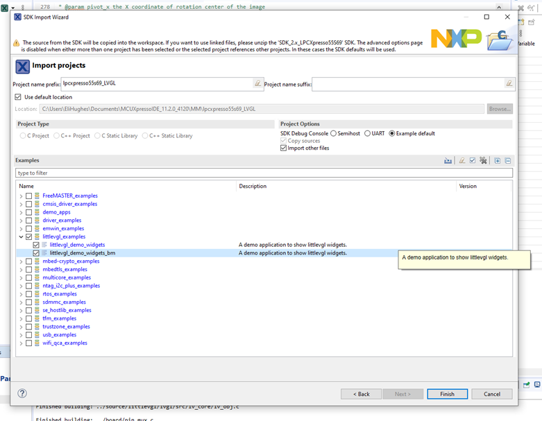

Since I already had code to initialize my IPS display and the microphone on the Mini-Monkey, all I had to do was write a simple driver layer for LVGL.   This task was simplified for me as LVGL is built into MCUXpresso SDK and there is an example for the LPC55S69 using FreeRTOS or a bare metal environment.
Figure 2.  LVGL Examples built into the LPC55S69 SDK

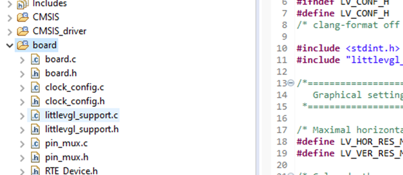

I generally prefer to pull in code directly from the GitHub repositories, but using the version from the MCUXpresso SDK was a useful starting point to observe a basic LVGL port.  Once you bring the LVGL source tree into your project,  porting to a new screen is straightforward.      In the MCUXpresso example, a file littlevgl_support.c is provided as an example.
Figure 3.  LVGL Port Layer in the MCUXpresso SDK example.
In addition actual driver port, you need to provide some configuration files to enable/disable features in LVGL.  You can pull the templates from the MCUXpresso example.
Figure 4.  LVGL Configuration File.
Since I was familiar with the interface to the Mini-Monkey IPS display through previous development with my own graphics library, I was able to get the SDK example ported in about 30 minutes.    LVGL provides a “demo widgets” example which shows how to instantiate some common user interface widgets.   I used this as a starting point to verify that I had things ported OK.      The LPC55S69 has plenty of RAM for LVGL’s working buffer.   LVGL recommends a 1/10 screen sized buffer but you could provide a 1:1 sized back-buffer with the large amount of RAM available in the LPC55S69.

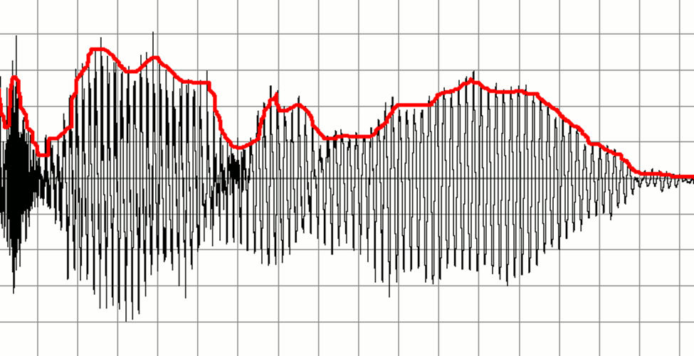

To implement my VU meter, I decided to use an envelope detector and map the output to an LVGL gauge.
Figure 5.  Envelope Detector Algorithm (Image Source is from Wikipedia.org)
The are several methods for detecting the envelop of a signal but I chose to use a simple single-pole filter applied to rectified version of the input signal with programmable attack and release times.

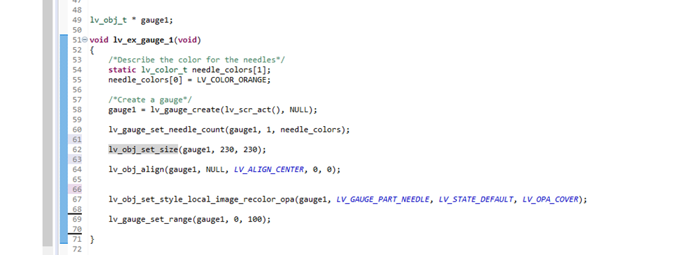

Setting the a gauge in LVGL is straight forward.
 Figure 6.  LVGL Gauge Setup.
Updating the gauge value is a one-liner with LVGL:
lv_gauge_set_value(gauge1, 0, EnvelopeOut);
In my demonstration code,  EnvelopeOut is computed on a per sample basis in an IRQ routine.    To keep things simple, I simply ran my main program “open loop” to update the display as fast as I could.   LVGL only updates areas of the screen that have actually changed so animations can be very smooth!   You can find my LPC55S69 LVGL VU meter code here.
