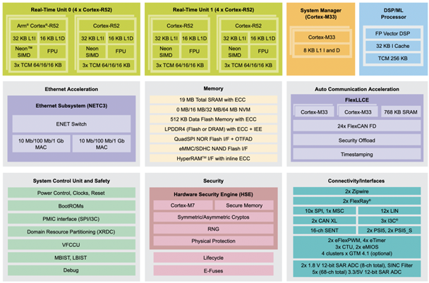

With the introduction of the new GreenBox 3 real-time development platform, NXP offers a game-changing platform that promotes ECU consolidation for enabling the future of automotive electrification. With its offering of eight (8) Arm Cortex-R52 cores, lockstep Arm Cortex-M33 cores, and a dedicated DSP/ML accelerator, the S32E288 was developed according to an ISO 26262 ASIL D-level process for safe, high-performance compute that facilitates parallelization of multiple real-time applications. These applications could range from motor control to steering and chassis management, thus allowing developers the opportunity to reduce the complexity and cost of their designs by limiting the number of dedicated MCUs necessary. In order to showcase these advantages and the possible use cases of the GreenBox 3, we developed a consolidated ECU demo that highlights the performance of the S32E288 under heavy loads and spotlights the functional safety capabilities of the device.
Fig. 1: S32E2 Real-Time Processors Block Diagram

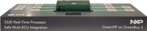

At its heart, this consolidated ECU demo aims to showcase the types of applications that a user could reasonably expect to run on the GreenBox 3 hardware. Historically, applications such as motor control, battery management systems, and inverter algorithms would reside on dedicated MCUs found distributed throughout the vehicle. However, as the industry tends towards domain-based and zonal-based vehicle architectures and as the performance of MCU cores increases, the viability of consolidating all of these previously disjoint functions begins to offer new ways of thinking about how software is deployed on the vehicle.
Fig. 2: S32E Real-Time Processor Safe Multi-ECU Integration Demo Platform
With this change, we first identified the types of algorithms that may be running on a typical electric vehicle (EV) and hybrid-electric vehicle (HEV) as part of the systems that help to control the overall powertrain domain. At first glance, applications like field-oriented control (FOC) motor control and battery management system (BMS) algorithms are the first types of powertrain applications to come to mind. However, these are not the only real-time, high-compute applications that could be running in the powertrain domain. Other powertrain-related applications could also include torque control, stability control, energy optimization, on-board charging, and power conversion.

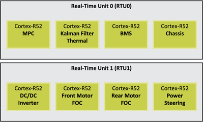

Powertrain Domain Applications per Core
With these applications in mind, we ultimately chose eight of them that could each be executed on a single Cortex-R52 core and would offer a unique set of performance and timing requirements. These applications include the following:
  • EV Range Optimization with Model Predictive Control (MPC)
  • Kalman Filter Thermal Monitoring
  • Battery Management System (BMS) State of Charge (SOC) Monitoring
  • Chassis Control
  • DC/DC Inverter Power Conversion
  • Front and Rear Motor Field-Oriented Control (FOC)
  • Electronic Power Steering
Fig. 3: Powertrain Domain Applications per Core

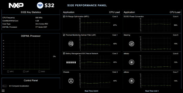

Fig. 4: GUI of S32E Real-Time Processor Safe Multi-ECU Integration Demo Platform Highlighting Applications Running on Each Core
With these applications in mind, let’s now explore a bit about how each one is applicable to the powertrain domain, what type of performance and resources they need, and how we implemented them on the GreenBox 3:

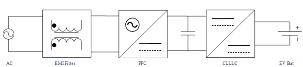

Through the transition to EVs, one of the new systems that are introduced to the powertrain domain of a vehicle is the On-Board Charger (OBC) system. OBCs are primarily responsible for power conversion between the charger side and the vehicle side. This often consists of converting an AC input from the charger into DC to facilitate. As part of this conversion process, you will often find 3 main components:
  1. Electromagnetic Interface (EMI) Filter,
  2. Power Factor Conversion (PFC), and
  3. CLLC (Capacitor, Inductor, Inductor, Capacitor) or LLC (Inductor, Inductor, Capacitor) Converter
To support this conversion process, a powertrain MCU is needed in order to perform safety-related monitoring and sampling.
Fig. 5: Main Components of an AC to DC Power Conversion System for OBC
In this demo, a 6.6 kW OBC is implemented with a forward control loop and a backward control loop. With each new ADC sample, the control loops will perform current detection, provide over voltage (OV) and under voltage (UV) protection, provide the PFC current Proportional-Integral (PI) controller along with the PFC voltage PI controller, perform AC RMS calculations, and many other functions. Overall, a single Cortex-R52 core is able to handle multiple control loops of varying frequencies that are all running in parallel while meeting strict timing constraints for reacting to faults like over voltage (OV) and under voltage (UV) to ensure a safe charging environment.

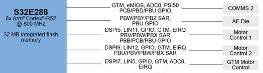

Front and Rear Field-Oriented Control (FOC)
Field-Oriented Control has become one of the de facto types of applications that users may decide to implement within the powertrain domain since it is the driving force behind traction control and the overall power plant of the vehicle. When controlling a 3-phase DC motor, Clarke and Park transforms are utilized for converting time domain components of a 3-phase system into an orthogonal stationary frame that is then converted to an orthogonal rotating reference frame (i.e. rotor flux reference frame). Ultimately, this allows you smooth control over the speed and torque of the motor across various ranges. When implemented in conjunction with a motor inverter board and 3-phase Permanent Magnet Synchronous Motor (PMSM) such as those from NXP’s MCSPTR2A5775E, development and testing of FOC applications can be performed on a GreenBox 3. With the inclusion of enough ports to support dual motor control and GTM motor control on the S32E288, meeting the demands of dual motor control on a single processor is possible.
Fig. 6: Peripherals Supported in the S32E288 and Exposed on the GreenBox 3 to Enable Dual Motor Control
Safety-oriented and software-based resolver solutions are implemented in this demo to provide accurate motor position sensing based on resolver inputs without using expensive external components for Analog to Digital Conversion (ADC) and timing. In addition, use of the Automotive Math and Motor Control Library (AMMCLib) ensures compatibility and easy bring-up when used in conjunction with other NXP motor control hardware like the NXP MCSPTR2A5775E.

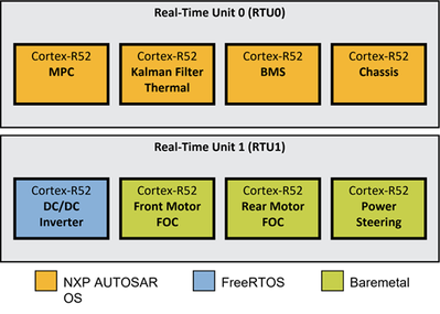

Operating System
When deploying each application on the GreenBox 3 as part of this demo, we wanted to showcase the flexibility of supported operating systems (OS) that a user could utilize on the S32E288. As a result, we split the cores into 3 main OS groups:
  1. AUTOSAR 4.0.x Classic with NXP AUTOSAR OS
  2. FreeRTOS
  3. Baremetal
Fig. 7: Breakdown of OS Deployed on Each Core
On cores where an OS is running, the main task is running alongside background tasks of lower priority such that we can utilize the execution time of the background tasks to help determine the overall CPU load of the main task.

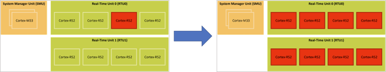

In a traditional powertrain setup, applications like the ones previously mentioned would be distributed throughout the vehicle on MCUs that would primarily focus on running just that one application. By having disjoint MCUs, two main advantages were offered: (1) physical isolation and (2) easier incorporation of outside products. By deploying an application on its own, lower-powered MCU, the developer could easily manage the other applications that are running on that MCU and help ensure that a QM application could not affect a safety application during runtime. Along these same lines, an OEM could also incorporate products and applications from a Tier 1 into their design by deploying them onto their own MCUs in order to ensure that black-box algorithms cannot inadvertently affect other applications on the vehicle.
Once you move to a consolidated ECU design, one of the main concerns that a developer may have is how they can continue to promote isolation between applications of different safety levels during runtime and how can they easily incorporate applications from outside sources like a Tier 1. To solve this challenge, the S32E288 offers a System Manager Unit (SMU) through the lockstep Cortex-M33 pair that acts as the safety cores for the system. These cores will utilize two main components of the S32E288 in order to promote isolation and to be able to bring the system back to a safe state in case something happens during runtime: (1) XRDC and (2) per-core reset generation.

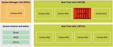

Fig. 8: Without Isolation, Faults in One Core Could Lead to Faults in Other Cores within the Processor

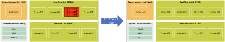

The Extended Resource Domain Controller (XRDC) allows you the ability to dictate which cores have access to which memory and peripheral resources supported by the processor such that you can restrict the amount of access an application may have during runtime. For example, in this demo we showcase an application that encounters issues during runtime to the point that it starts to attempt write accesses to code areas for other cores. In a system without an XRDC, the lack of resource restrictions would allow the core running the faulty application to possibly affect memory regions and peripherals used by those other cores. In this case, the faulty application in this demo is able to overwrite the code and data areas for the other cores on the processor and is able to cause runtime errors in all of the other cores. If this were to happen, the only way to recover back to a safe state would be to reset the entire system.
However, once you properly configure the XRDC such that a core only has access to the resources it needs, you can prevent situations where a faulty application can affect the runtime execution of other applications on other cores. In the case of our demo, when the faulty application starts attempting to read and write to the code and data areas of the other cores, the XRDC will block all accesses to those memory regions since they were not assigned to that core. This prevents the faulty application from affecting the operation of the other cores and helps to contain the possible impact to just the one core.
Fig. 9: With Isolation, Faults can be Isolated to only the Core with the Fault
Once accesses are blocked and the faulty application has been identified, you will want to have the ability to bring that application or core back to a safe state. To do this, the SMU cores have the ability to identify the fault during runtime through their constant monitoring of the system and will then issue a reset to the faulty core in order to bring it back to a safe state. Through the Reset Generation Module (MC_RGM) found on the S32E288, you can reset individual cores on the device without affecting the execution of the other cores. The XRDC and per-core reset generation ultimately allows you to maintain the integrity of the entire system and gives you the ability to return back to normal operation without having to reset the entire MCU.
Fig. 10: With the Fault Isolated, the System can Return to a Safe State through Resetting the Individual Core with a Fault
