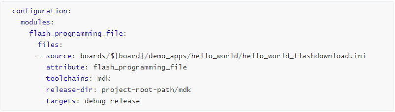

SDKGEN-831 Support to define flash programming script for Keil

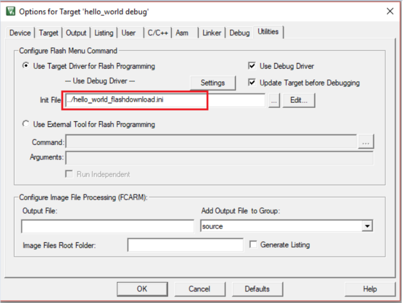

  • Flash programming file is supported to configure for Keil. To set script, a tag named flash_programming_file should be set in yml. In release mode, this file will be copied to release directory.
    For example:Untitled.png
    And this setting will show as below:
