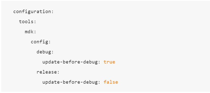

  •  SDKGEN-1053Enable "Update Target before Debugging" option for mdk
        The "Update Target Before Debugging" option downloads your program to target hardware only when your project          changes. This option does not run initialization script files until after your target program downloads.
        To enable or disable this option, a tag named update-before-debug should be set in yml.
        Besides, to make this setting effective, .uvoptx template file must be provided.
        Here is a yml example:
        And this setting will show as below:

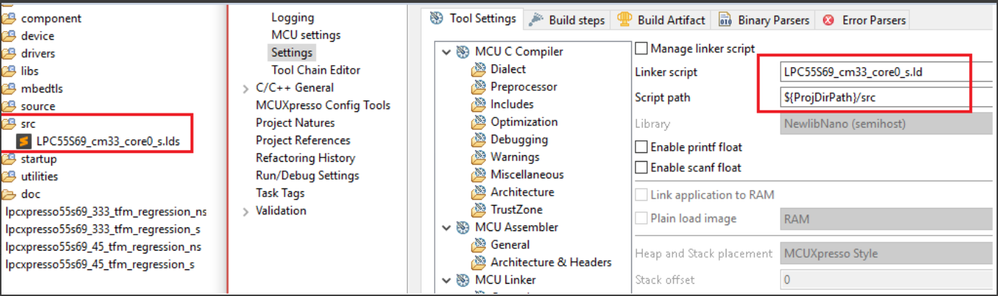

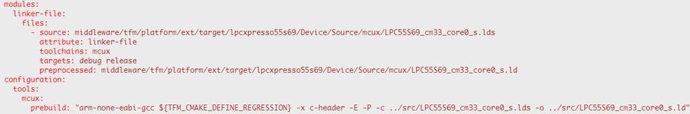

  •  SDKGEN-1004Support to configure preprocessed linker scripts for mcux
        For mcux, generator support to configure user specific linker scripts which is generated by prebuild command.
        To use the feature, a tag named "preprocessed" need to be added for source file, which means the file generated            after being preprocessed.
        Here is an example:
