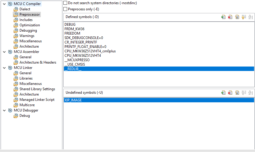

         mcux-undefine tag has been enabled in yml setting for Mcuxpresso IDE.
         For example:
         In yml file:
         And this macro will show in Undefined symbols:
