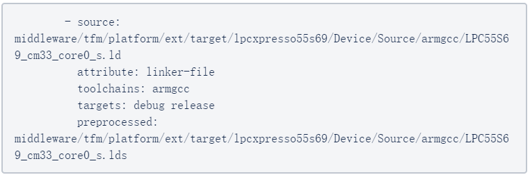

  •  SDKGEN-915Support to add preprocess cmd in cmakelist
        There is a requirement which needs to preprocess the original linker file with commands. For this reason, the         CMakeLists needs to call preprocesser.
        To add preprocess cmd in cmakelist file, need to add 2 flags in yml:
           ○ preprocessed: give the path of preprocessed linker file
           ○ Prebuild: give commands to preprocess linker file
        Here is an example:
