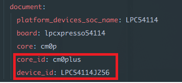

       KPSDK-25334 Improve the "core_id" in board yml
       The core_id tag must be set in related ymls under document tag for multi-core device. Previously, the core_id             tag is actually a combination of core id and device id which is not a good format, such "cm33_core0_LPC55S69"         and "cm0plus_LPC54102J512".
       This JIRA separates core_id and device_id independently. Just a kind reminder that these two tags are only                 required for multi-core device and should be set in pairs. For example:
       We have already updated all ymls with it.
       More, this update is backward compatible: the old format core_id is still supported but we highly recommend to           set new core_id and device_id for future development.
