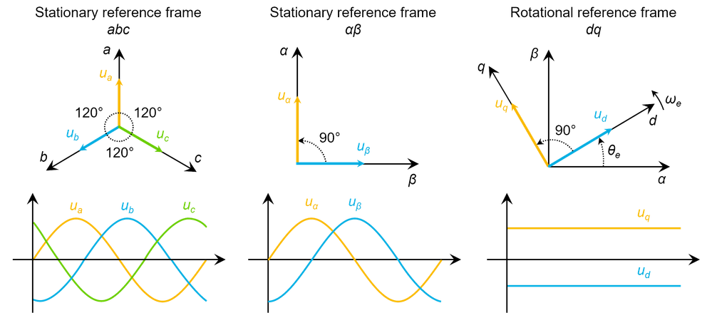

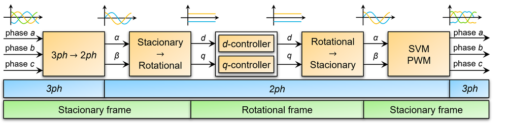

PARK & CLARKE TRANSFORMATIONS
In order to decompose currents into torque and flux producing components (id, iq), the position of the magnetizing flux has to be known. This requires knowledge of the accurate rotor position as being strictly fixed with magnetic flux. A transformation of the controllable motor quantities, such as current and voltage, from the stationary abc to the rotational reference system dq must be conducted.
Fig. 2 illustrates the fundamental structure of the vector control algorithm for PMSMs. To perform vector control, it is necessary to take the following four steps:
  • Measure the motor quantities (DC bus voltage and currents, rotor position/speed).
  • Transform measured currents iabc into the 2-phase orthogonal system αβ using a Clarke transformation (1). Second, transform the currents in αβ coordinates iαβ into the dq reference frame using a Park transformation (2).
iα = ia      iβ = ib1/3 - ic2/3      (1)
id = iα cos(θe) + iβ sin(θe)      iq = -iα sin(θe) + iβ cos(θe)      (2)
  • The stator current torque (iq) and flux (id) producing components are separately controlled in the dq rotating frame.
  • The outputs of the controllers' are the required dq voltages and they are transformed by an inverse Park transformation (3) back from the dq reference frame into the 2-phase orthogonal system αβ fixed with the stator. The other options are to transform αβ voltages directly to the abc reference frame by means of (4) or using a Space Vector Modulation (SVM) to generate 3-phase voltages with 3rd harmonics for improved DC bus voltage utilization.
uα = ud cos(θe) - uq sin(θe)       uβ = ud sin(θe) + uq cos(θe)      (3)
ua = uα       ub = -uα1/2 + uβ3/2      uc = -uα1/2 - uβ3/2      (4)
The Clarke/Park transformations and SVM discussed above are part of the NXP's Automotive Math and Motor Control Library (AMMCLib) set.
 Fig. 2. FOC transformations

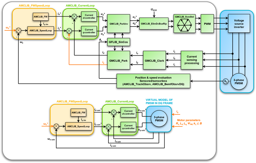

SOFTWARE IMPLEMENTATION OF VIRTUAL PMSM FOC
Fig. 3 presents a comprehensive block diagram illustrating the entire motor control architecture. This diagram is segmented into three principal components:
  1. Virtual Model of PMSM FOC: This section details the operations executed directly on the MCU pertinent to motor control. Notably, it encompasses the virtual PMSM FOC, which operates in parallel with the primary PMSM FOC that governs the actual motor.
    The inputs necessary for proper virtual PMSM FOC operation in the speed loop are highlighted within the figure: required electrical angular velocity ωe*, measured q-axis current iq, and precise motor parameters discussed in the previous section.
  2. Software Part: This intermediary layer ensures seamless integration between the software and hardware segments. It manages data flow, command execution, and real-time adjustments crucial for optimal motor performance.
  3. Hardware Part: This includes the Voltage Source Inverter (VSI) and the 3-phase PMSM equipped with a resolver. The three-phase PMSM serves as the terminal motor control node, directly interacting with the control system to execute precise motor operations.
Each of these components plays a vital role in the overall motor control system, ensuring efficient and accurate motor performance. The software part ensures sophisticated control algorithms are applied, the control interface facilitates effective communication, and the hardware part actualizes the motor control commands into real actions.
  Fig. 3. Motor control architecture with virtual PMSM FOC

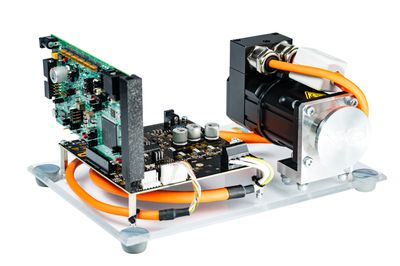

MCSPTR2AK396 MOTOR CONTROL DEMO

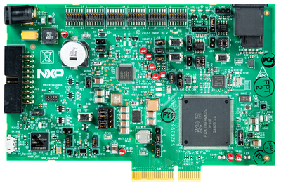

This section walks you through the digital twin and physical demo ran in the MCSPTR2AK396 3-Phase Motor Control Kit with S32K396 (see Fig. 4).
 Fig. 4. MCSPTR2AK396 3-Phase Motor Control Kit with S32K396
The S32K396 product series is a part of the S32K39/37/36 family for electrification applications. It further extends the highly scalable portfolio of Arm® Cortex®-M7 K3xx MCUs in the automotive industry. It features:
  • The Cortex-M7 core at a higher frequency.
  • Advanced motor control coprocessors.
  • An extended analog interfaces, including a high-resolution PWM.
S32K396 is developed to meet the next generation SiC traction inverter requirements and to enable high efficiency, low latency, and system-level BOM cost savings. Because of its versatile architecture, the S32K396 is also well suited to address a wide range of electric vehicle applications.
Fig. 5. Microcontroller S32K396 with PCIE connection

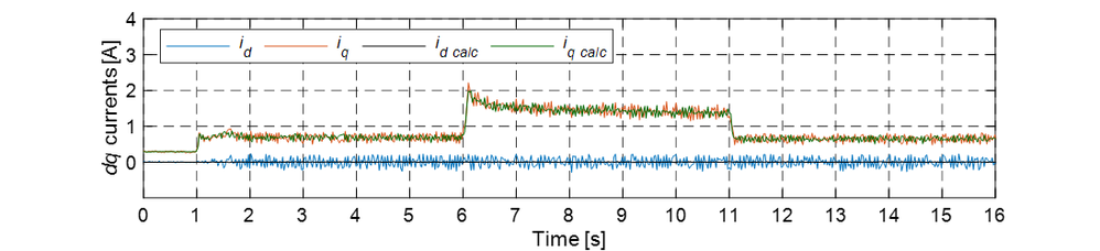

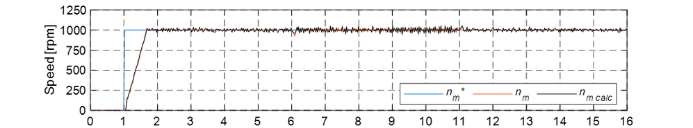

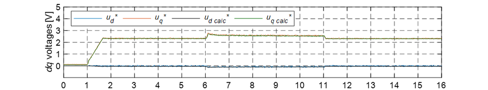

The FreeMASTER Run-Time Debugging Tool is used to control the application and monitor variables during run time. It can be employed to watch and compare the variables between the real and virtual PMSM FOC. The Motor Control Application Tuning (MCAT) Tool is part of FreeMASTER and allows real-time control structure parameter tuning.
Fig. 6 shows the data extracted from the FreeMASTER tool. It shows the comparison between real and virtual PMSM FOC running in parallel as shown in Fig. 3. In t = 1 s the PMSM is started in the speed loop with the required speed of 1000 rpm. The load is provided to the PMSM from t = 6 s to t = 11 s. It shows the control performance under load conditions. The comparison reveals an accuracy of more than 95 % between a real and virtual model of PMSM FOC.
michalvidlak_3-1716556785993.pngmichalvidlak_3-1716556785993.pngmichalvidlak_4-1716556789874.pngmichalvidlak_4-1716556789874.png
Fig. 6. Comparison between real and virtual PMSM FOC on MCSPTR2AK396 with S32K396
