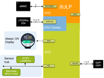

The i.MX8ULP features the energy flex architecture which consists of the Application domain, Flex domain and Real Time domain. Different power modes can be achieved by the dedicated power management system to optimize the power consumption.
In the Sensor Hub use case, the Application and Flex domain are shutdown, while preserving the Real Time domain only.
After the boots up, The Linux suspends(A-core) and M33(M-core) enters deep sleep mode and the screen turns off. When we tilt the board(simulate wrist lifting), the gyro sensor LSM6DSO will send an interrupt signal to M33, M33 will wake up and acquire the sensor data and display it on the screen. After 3 seconds, the system enters deep sleep mode again.

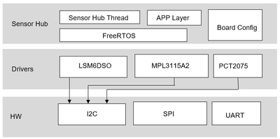

Software Architecture

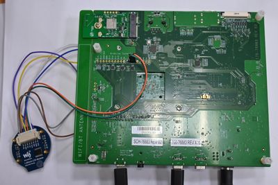

Hardware Changes to the EVK:
EVK:
For the hardware rework, we first need to weld some rows of pins on :
J23,J26 on the board back, but we leave the longer pin in front
J21 on the board back
Another hardware rework, we need to remove R161 R167, and connect a 0 ohm resistor at R160, R166(Or short circuited)

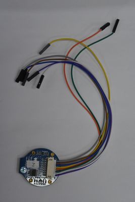

Panel:
Pin Mapping
OLED PIN
i.MX8ULP PIN
BOARD PIN position
VCC
3.3V
4th pin in J22
GND
GND
6th pin in J22
DIN
PTA21
7th pin in J21
CLK
PTA22
6th pin in J21
CS
PTA15
1st pin in J23
DC
PTA6
6th pin in J23
RST
PTA24
5th pin in J23
BL
PTA18
4th pin in J23
