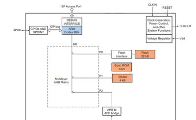

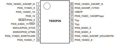

Figure 1. The NXP LPC804
The LPC804 is based on a 32-bit ARM Cortex M0+ CPU with peripherals attached to implement useful glue logic. This component is available in an easy-to-use TSSOP20 package. In production quantities, a price tag of $0.42 makes it a very attractive part. This type of application generally screams “8-bit” but the easy to use package, price and features make it a no-brainer to go with a 32-bit microcontroller. A couple of other things I love about this part:
  1. It has a bootloader baked in ROM. This means you can program this part over a UART to ease production programming.
  2. It has flexible pin mapping. Instead of a pin-mux, the peripherals can be mapped to any GPIO IO pin.
  3. A small amount of programmable logic.
This chip is truly awesome for these types of glue logic applications. With 32 KB of Flash memory and 4 KB of SRAM, you can get quite a bit accomplished. If you have not moved into the 32-bit space, the LPC804 is a great way to learn 32-bit ARM Cortex-M0+ architecture. It is approachable for a beginner from both the hardware and software aspects. Many modern 32-bit based MCUs come with reference manuals that have thousands of pages. A part like the LPC804 is a great way to get initiated into the 32-bit ARM cortex ecosystem without being overwhelmed.

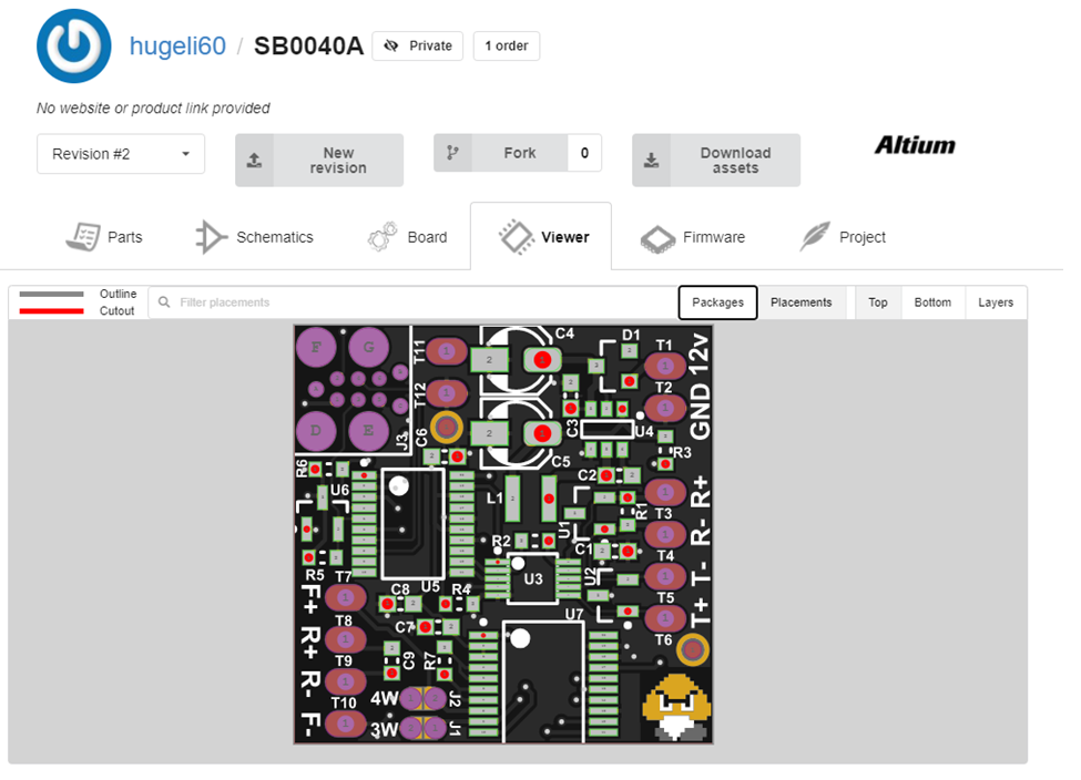

While this particular design did not have a large number of components, I could quickly wrap up a couple of days in ordering parts, building and testing the boards. This time could be better spent working on firmware, coordinating with the customer on specific interface features and everything else that will make us money. I turned to CircuitHub for fabrication. In a previous article, I used the turnkey service PCB.NG to build the “Mini-Monkey”. Like PCB.NG, CircuitHub has an excellent online interface to upload files and manage the design.
Figure 3.  The CircuitHub interface after uploading design files
Figure 4:  CircuitHub board specification adjustment for on-demand manufacturing
Having visibility into the manufacturing and process is a key benefit for me. With traditional CMs, you often dump a documentation package and wait days (or even weeks) to know the price, delivery, etc. I even compared volume pricing through CircuitHub with some designs I already have been produced at traditional CM’s. At our volumes, the price was on par with my existing providers. The key take-away is that an on-demand manufacturing services gives you the price right away, you don't have to go through the trouble of working up your own manufacturing estimate. There is a convenient “slider” to help you understand volume pricing instantly.

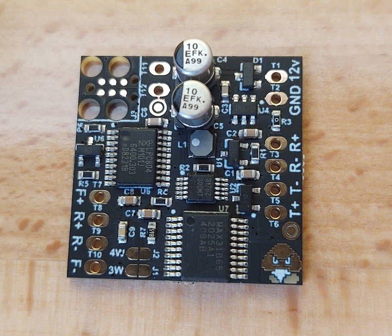

So, how did these on-demand prototypes turn out? Take a look and see for yourself!
Figure 5: The Completed Smart Cable Circuit Prototype.
As always, there is plenty of room for neat artwork!
(マイビデオを表示)
The result was fabulous, and the prototypes were delivered on time. Another nice feature was that all communication occurs through the web interface. There was one part I needed to substitute, and having a centralized location for communication was beneficial when there are several people involved in a project. As icing on the cake, they provide a photo of the completed assembly before they ship. I found that to be a particularly nice “warm and fuzzy” benefit of the process.
