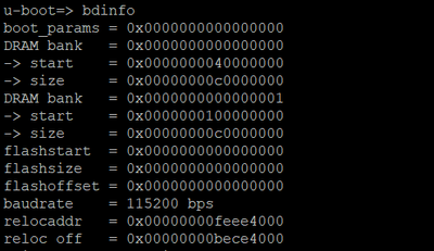

2. Run uboot and get relocate offset
Program flash.bin to eMMC or SD card, boot uboot and "Hit any key to stop autoboot". Run command bdinfo to get uboot reloc off value.

3.2 relocate offset
We have got relocate offset in step 2, replace the value in SYMbol.reloc command.

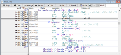

4. Attach i.MX8MP board to TRACE32 debugger
Connect TRACE32 to JTAG port, open TRACE32 ICE Arm USB, then from “File->Run Script...”, run imx8mp-uboot-attach.cmm, you will see below window, TRACE32 is attached to i.MX8MP uboot.

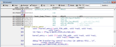

If you want to debug some function, such as boot_jump_linux, you can set break point with command
break.set boot_jump_linux
Then press Go button in TRACE32 PowerView, and run boot command in uboot, uboot will continue to run and stop at boot_jump_linux, as shown in below figure.
