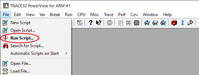

Connect TRACE32 to JTAG port, open TRACE32 ICE Arm USB, from “File->Run Script...”, run imx8mp-linux-attach-temp.cmm.
In TRACE32 install folder, there is a template script which can get the Address Translation information. Suppose you have installed TRACE32 software in C:/T32 folder, from “File->Run Script...”, run "C:\T32\demo\arm\kernel\linux\board\generic-template\detect_translation.cmm", you will get below output, copy to your temporary script, rename it to imx8mp-linux-attach.cmm.

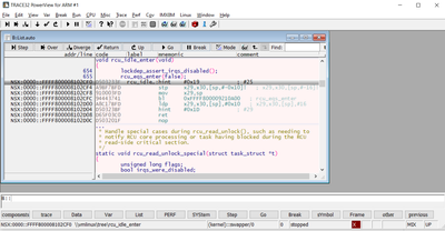

  • Stat TRACE32 ICE Arm USB, run script imx8mp-linux-attach.cmm. You should see below window, TRACE32 is attached to i.MX8MP Linux. You can press "Mode" button to switch to C language view.
If you find below warning message in View->Message Area window, the debugger can't find Linux source files. Please check your /STRIPPART and /SOURCEPATH setting.
If you get below bus error, please check if you have disabled cpu idle mode.
If your TRACE32 PowerView can't parse kernel symbol, please check if your kernel is 6.1.x, you must disable KASLR in uboot bootargs for Linux-6.1.x.

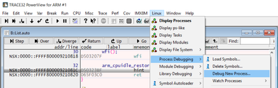

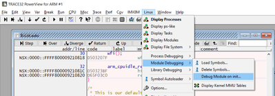

3. Debug Linux module
By default, imx8-media-dev.ko in rootfs/lib/modules/.../imx/ will be insmod automatically after Linux bootup, but since we have change kernel configuration, we need to rebuild Linux module and insmod the imx8-media-dev.ko manually, this example will show how to debug module when insmod it.
1. Rebuild Linux module and copy drivers/staging/media/imx/imx8-media-dev.ko to your board.

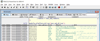

2. Follow "2. Attach TRACE32 to i.MX8MP Linux" to connect TRACE32 to i.MX8MP Linux, then press Go button.
3. Press Linux->Module Debugging->Debug Module on init..., In a popup window, input module name imx8-media-dev.
4. In i.MX8MP Linux terminal, insmod the module
insmod imx8-media-dev.ko
5. In TRACE32 window, a Searching symbols window will popup. Browse and open imx8-media-dev.ko, you will see below window. You can switch to source code view by pressing B:List.auto Mode button.
4. Debug Linux App
We will use a simple example hello.c to show how to debug Linux app, you can get the source code in attachment.
1. Set cross compiler and build app with -g compiler option to enable debug information, copy app hello to your board.
$(CC) -g -lpthread -o hello hello.c
2. Follow "2. Attach TRACE32 to i.MX8MP Linux" to attachTRACE32 to i.MX8MP Linux, then press Go button.
3. Press Linux->Process Debugging->Debug New Process, In a popup window, input process name hello
4. In i.MX8MP Linux terminal, run app hello
5. In TRACE32 window, a Search symbols windows will popup, browse and open app hello, you will see below window, you can switch to source code view by pressing B:List.auto Mode button. Now you can start to debug the app.
