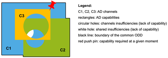

Figure 2. Conceptual illustration of overlapping functional insufficiencies and capabilities of multiple AD channels from [5]. Capabilities of the AD channels can be complementary. By selecting a proper AD channel at runtime, insufficiencies can be mitigated.

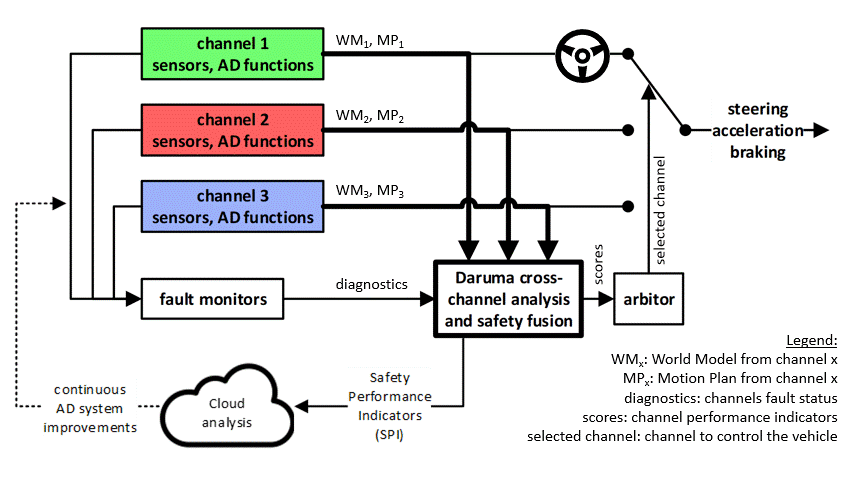

Figure 3 below presents the architecture of the Daruma design pattern. The AD channels provide high-level channel state information to the Daruma module, including the world model, motion predictions, ego trajectory and detected traffic rules. Daruma operates independently of the AD channels, staying compatible with innovations in sensor fusion, neural networks, and heuristic algorithms. The channel state information is analyzed using three major types of algorithms: similarity, risk analysis and preferences. The cross-channel analysis produces various safety and availability metrics that are fused with the output of classical fault monitors, ODD monitors, etc. Subsequently, the aggregated score per channel influences the high-level arbiter decision on which channel to select for driving at runtime. In Figure 3 below, Daruma switches over from the risky channel 1 to the more reliable channel 2 while the ADS was free from faults. Note that the Daruma world models (WMx) can include traffic rule restrictions identified by the channels. More information on the Daruma design pattern can be found in [5].
Figure 3. High-level system architecture of an ADS with three heterogeneous AD channels and the Daruma module. The high-level information with the world model and ego vehicle trajectory from the channels is forwarded to the Daruma module along the thick arrows. The Daruma feeds the arbiter with an aggregated safety and available score per channel. If channel 1, for example, has a lower score than channel 2, the arbiter can select channel 2 for driving the vehicle.
Noteworthy, Daruma is uniquely positioned in the ADS to derive Safety Performance Indicators (SPI) [14] shown in the figure above. Indeed, Daruma can correlate the channels' world models and motion plans to identify low safety performance. For example, Daruma can spot repeated disagreements in object classifications between the main and backup channels, even though Daruma is not certain which channel is right. The SPIs and associated driving scenarios are uploaded to the cloud, where they are combined and analyzed across the whole vehicle fleet to create Over-The-Air updates of the firmware, software, and related data in the vehicle. So, if the object classification insufficiency spotted by Daruma in our example above is consistently registered in many vehicles, the ADS manufacturer can retrain the associated neural model and deploy it in the fleet. Ultimately, the SPI statistics can help design new ADS generations and improve AI-based components.
The Daruma design pattern is an ADS extension using cross-channel analysis to select a channel that continues safe automated driving towards destination. Thanks to its channel-agnostic nature and Service-Oriented Architecture design of the Daruma module, it can be instantiated inside the high-performance computer or in the powertrain domain controller of the vehicle, see Figure 4 and Figure 5 below with a red Daruma doll representing the Daruma module. The advantage of the powertrain domain controller instantiation is, for example, independence from faults occurring in the main computer. Note, that Daruma should be close to the vehicle actuators for steering and acceleration depicted with a steering wheel icon in the illustrations.

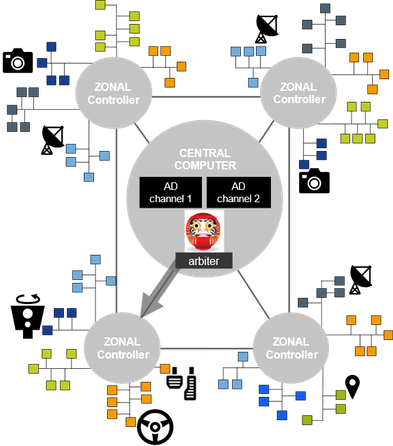

Figure 4. Daruma cross-channel safety analysis in the high-performance central computer (HPC). Multiple AD channels are implemented in the HPC. The red doll represents the Daruma safety analysis module. The Daruma arbiter selects the safe and available channel that will communicate vehicle control setpoints to the zonal controller. The zonal controller uses the setpoints to control steering, braking and acceleration actuators accordingly.

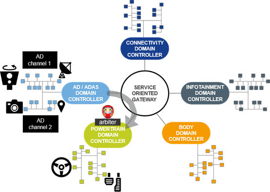

Figure 5. Daruma cross-channel safety analysis in the powertrain domain controller. The red doll represents the Daruma safety analysis module. In this architecture, the domain controller includes the AD channels that send the high-level information to Daruma for cross-channel analysis. The arbiter then selects a safe and available channel to let the powertrain domain controller convert steering, braking and acceleration setpoints to electrical control signals for the actuators.

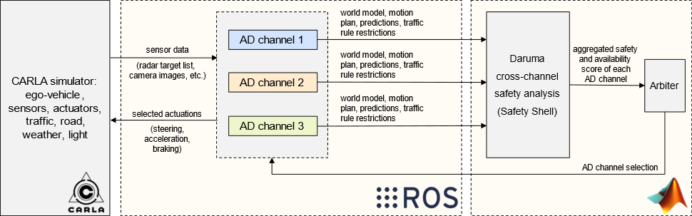

The Safety Shell algorithm implementation is validated on the NXP multi-channel AD testbed with the CARLA simulator [6]. The testbed architecture is illustrated in the Figure 6 below. On this testbed, we integrated AD channels that can operate in scenarios of the CARLA Autonomous Driving Leaderboard [8]. The CARLA Leaderboard is an open platform to evaluate the performance of automated driving agents in realistic traffic scenarios provided by CARLA. The AD agent performance is evaluated against multiple CARLA Leaderboard metrics [9] considering various factors such as the route completion, collisions with pedestrians or other vehicles, running a red light or stop signs, etc. Obviously, the route completion factor influences the AD agent’s availability. We integrated three open-source AD channels in our testbed: LAV [10]  and Transfuser [11] from CARLA Leaderboard submissions [8] and Autoware.Universe, a leading open-source automated driving software stack [12].
Figure 6. Multi-channel AD testbed with Daruma cross-channel safety analysis implementation (Safety Shell) and the CARLA simulator. The Carla simulator models the ego vehicle, traffic, the road and environment. The vehicle sensor data is fed into the AD channels the produce the high-level information, such as the world model and ego motion plan. Daruma analyzes the motion plans against the world models to compute the aggregated safety and availability score for the arbiter. Finally, the arbiter selects the channel to send actuators to the modeled vehicle in CARLA.

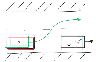

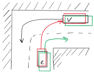

1. How does Daruma deal with channel disagreements? Channels can disagree on perception or motion plans, while being safe and available. So, in contrast to other safety mechanisms that suffer from disagreement, Daruma can benefit from them, see examples below:

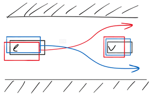

a) Motion plans disagreement 1. In the birds-eye-view figure below, two channels red and blue control the ego vehicle e to avoid the collision with another vehicle v. In black we have the ground truth. The arrows specify the computed motion plans of the red and blue channels, which are substantially different, so that majority voting mechanisms based on margin or envelope will signal disagreement and disengage automated driving or mark channels as unsafe. In contrast, Daruma analyzes red and blue motion plans in the other world models and concludes there are no safety conflicts. So, any motion plan is good to use.
b) Motion plan disagreement 2. As illustrated in the last availability video above, we can select a safe trajectory to unblock the ego vehicle that suffers from a functional insufficiency in the red channel’s motion plan. Below is the bird’s-eye view of the scenario, in which we temporarily switch to the green channel to make a sharp turn and then back to the red channel, which is more advanced in majority of the scenarios.
c) Perception disagreement. If two channels see no object, while the third one does, then the classical majority voting mechanism will select the two channel’s motion plan. Instead, Daruma can evaluate cross-channel risks and notice the safety conflict of the agreeing channels with the third one’s world model. A bird’s-eye view illustration is shown below. Within a certain margin the red and blue channels agree and do not see vehicle v in front. So, they propose to drive straight. Nevertheless, Daruma selects the green channel, because it is compatible from the safety perspective with all channel’s world models, and it continues driving towards the destination instead of halting. By the way, in our demo videos above you can literally see disagreements between red, green and blue channels that perceive the world differently and plan the motion differently.
d) In the end, Daruma doesn't know, which channel is closer to the ground truth, but it can select a safer one through comparative cross-channel analysis of motion plans, as shown in our ESV paper [5] in Figure 11. In general, we distinguish three types of algorithms that fit the Daruma cross-channel analysis: motion plan risks analysis, similarity/agreement, and preference. We covered these algorithms in more detail in our ESV paper in section "Daruma: architecture design pattern".
