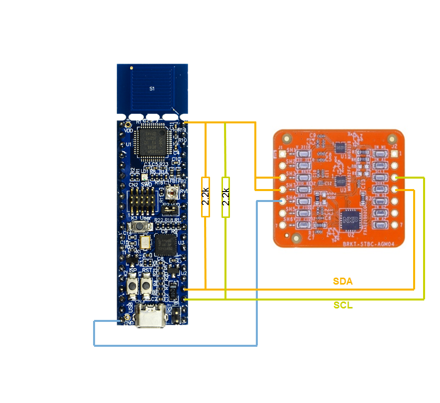

Refer to the table for the hardware Connections for this application:
The NXP MMA8652 3-axis accelerometer on the breakout board (NXP BRKT-STBC-AGM04)can be connected using I2C protocol. SCL, SDA lines and can be powered via VDD, VDDIO and GND pins.
Connect pins of I2C master and slave as below:
Master   Slave
Pin Name Board Location Pin Name Board Location
SCL  CN1-23 SCL  J2-3
SDA CN1-22 SDA J2-4
VCC CN1-40 VDD/VDDIO J1-3/4
GND  CN1-20 GND  J1-5
