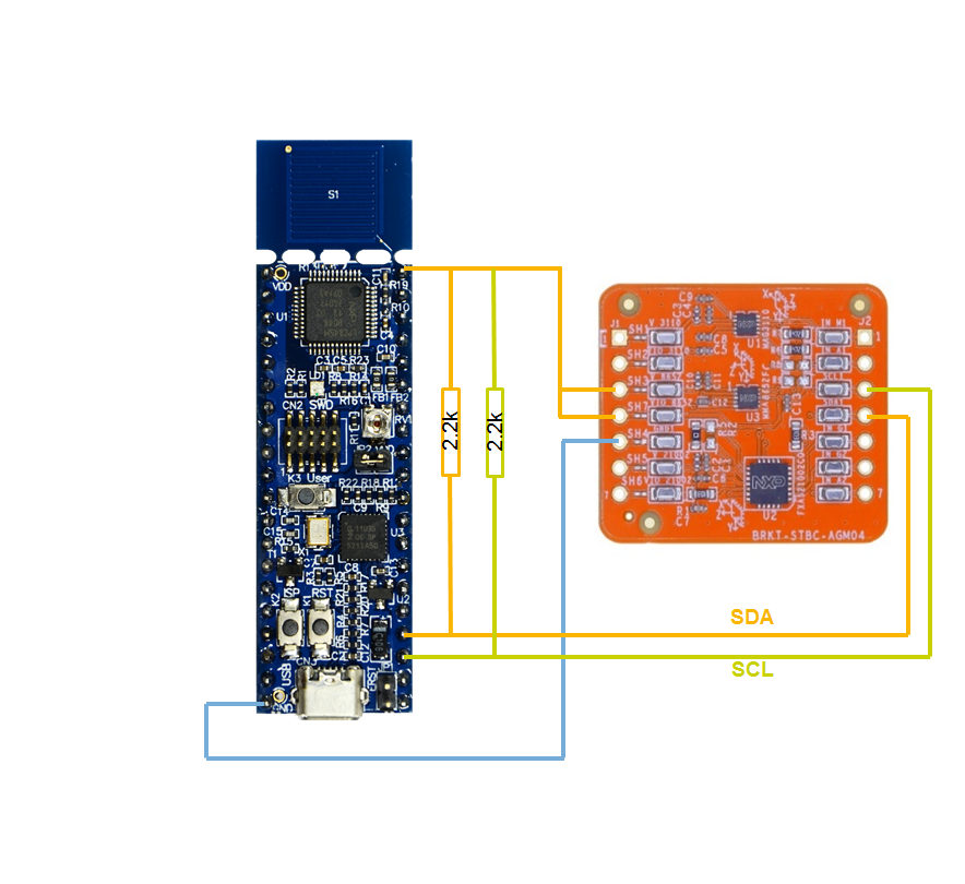

Refer to the table for the hardware Connections for this application:
The NXP MMA8652 3-axis accelerometer on the breakout board can be connected using I2C protocol. SCL, SDA lines and can be powered via VDD, VDDIO and GND pins.
Connect pins of I2C master and slave as below:
Master   Slave
Pin Name Board Location Pin Name Board Location
SCL  CN1-23 SCL  J2-3
SDA CN1-22 SDA J2-4
VCC CN1-40 VDD/VDDIO J1-3/4
GND  CN1-20 GND  J1-5
