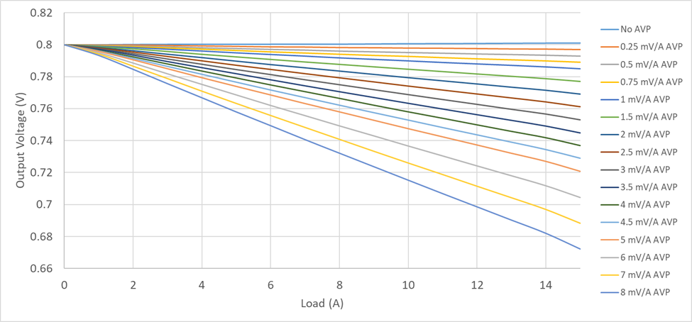

    With smaller processor nodes, the allowed window within which the power supply must regulate gets smaller. The tolerance window must be met during steady state (DC) as well as transient conditions (AC). While the steady state regulation is governed by accuracy of internal circuits such as bandgap reference and current sense accuracy, the transient tolerance is governed by the loop bandwidth and amount of output capacitance. It is important to select a DC-DC converter with low DC accuracy specifications as well as one that offers a high loop bandwidth.
    The PF53 family offers a +/-1% DC accuracy and bandwidth as high as 400kHz. In addition, it offers programmable load-line capability. Also known by other terms such as adaptive voltage positioning (AVP) and droop control, AVP lowers the output voltage at higher load currents. The benefit of this feature is increased margin for AC tolerance as showed in  Figure 2. Figure 3 shows the PF53 AVP performance. The user can choose the AVP for a given application based on the total tolerance window available.
    Figure 2. Benefit of AVP
    Figure 3. PF5300 AVP Characteristics

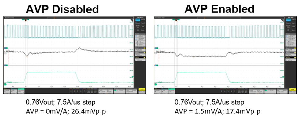

    Using AVP and the high bandwidth loop, the PF53 can regulate within a 3% tolerance window that includes DC and AC tolerances with just 150 uF of capacitance. Figure 5 shows the transient response of the PF53 with only 150 uF of capacitance. This complies with the requirements for a leading vision processor.
    Figure 4. Transient Response with and without AVP; Cout = 150 uF

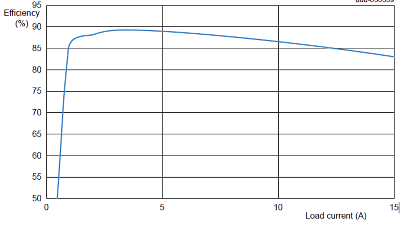

  3. Efficiency
    Power not sent from the input to the output is dissipated as heat. Efficiency, thus, directly affects thermal performance of the system. As power levels increase, efficiency also must increase to maintain a reasonable power dissipation. Thick MOSFET metallization, packaging, high quality inductors, optimization of the switching times and dead time, MOSFET resistance and gate charge are all critical factors affecting efficiency. It is important for a power solution to incorporate these while offering a solution in the market.
    With advances is MOSFET and switching design, the PF53 provides high efficiency across load currents in a low thermal resistance package. Figure 5 shows efficiency of the PF53 for loads up to 15 A. Refer to the PF53 datasheet for more performance curves.
    Figure 5. PF53 efficiency at 3.3V input and 1.0 V output
