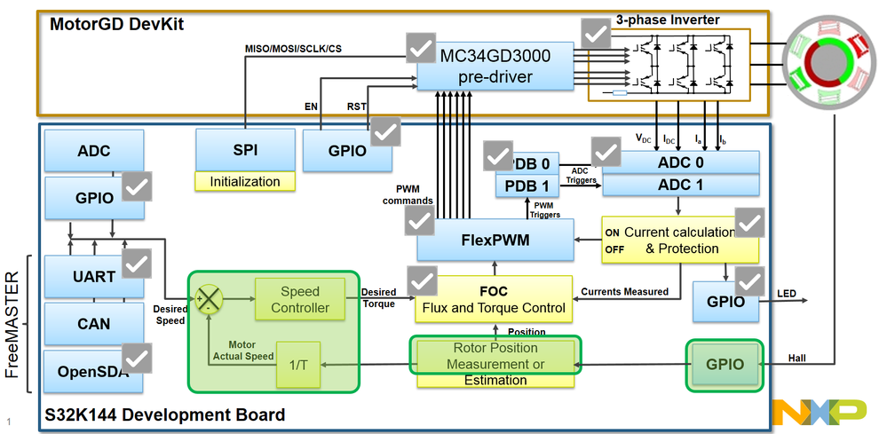

In Fig. 1, which represent the global application mapping diagram as discussed in Module 3: System Partitioning , are shown the new hardware blocks that are going to be configured and used to perform the PMSM Sensored Speed Control highlighted in green relative to the ones already configured so far in the previous modules of this workshop. This time we are going to configure the GPIO to generate interrupts each time the Hall sensors change their state allowing us to compute the rotor position and motor speed using a simple estimation approach based on counting the time between Hall transitions.
Furthermore, we are going to reuse and enhance the model developed in Module 7: Torque Control . The interactions between host PC and hardware will be done via OpenSDA serial communication that will be used to download the code generated from MATLAB and to visualize various control signals with FreeMASTER. In addition, the user can start and control the motor speed from the SW2 and SW3 push buttons that are present on the S32K144 Evaluation Board|NXP . A three color LED will be used to signal the control states and faults.
Fig. 1:  Application Mapping -  new HW & SW modules used for Sensored Speed Control are highlighted in green

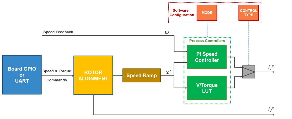

In Fig. 2, is shown the block diagram of a typical closed loop speed control system proposed for implementation. The control system is made of two cascaded loops that use information about currents and rotor position to regulate the PMSM rotor speed to a desired set point.
Fig. 2: Closed loop speed control system - Block Diagram

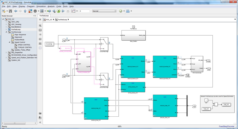

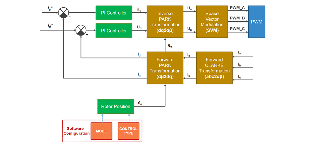

The Field Oriented Control shown in Fig. 3, is computed in the FAST CONTROL LOOP block that is executed based on a ADC triggers at each 100 microseconds. This subsystem receives the reference values for currents in Q (torque) and D (flux) axis and use as feedback the Ia,Ib and Ic currents measured from the ADC that are transformed from the fixed reference frame (abc) to the orthogonal rotating frame (dq) based on the angle θ provided from position sensors and PARK and CLARKE transformations. The FAST CONTROL LOOP outputs via the Space Vector Modulation technique the PWM duty cycles commands that control the 3-phase inverter which applies the corrective voltages directly to the PMSM windings.
Fig. 3: Field Oriented Control - Block diagram

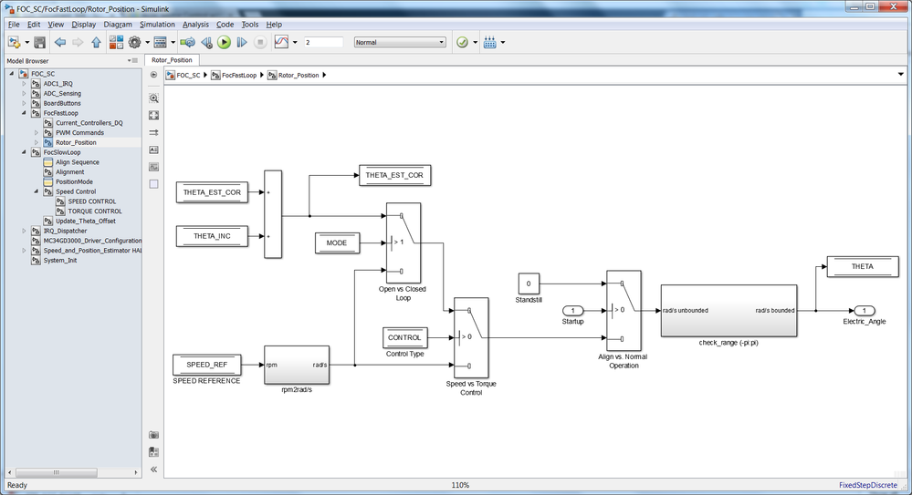

For flexibility, the actual electric angle θe used in FOC calculations is derived from the position sensor measurements and estimations based on application software configuration global variables: MODE and CONTROL TYPE.
The CONTROL TYPE global variable allows users to choose between:
  • SPEED CONTROL = 1 that performs the closed loop speed control based on sensor feedback
  • TORQUE CONTROL = 0 that performs the control system designed in Module 7: Torque Control
The TORQUE CONTROL operation is very important at this time because it will allows us to perform various tests with the speed and position estimator prior of closing the speed control loop.
The second global variable, MODE is generated internally by the software algorithm and it is used to control the motor startup process and zero crossing during change of rotation direction. Since we are dealing with an estimator we need to cope with low speed ranges and 0 crossing when changing the motor speeds from clockwise (CW) to counter clockwise (CCW) directions. This variable has three possible values (see Fig. 27 for a graphical representation):
  • FORCE MODE = 0 where the motor is control in open loop with an imposed electric angle reference
  • TRACKING MODE = 1 where the motor is still control in open loop but the speed controller will act in parallel to charge the integral part in order to deal with handover from open to closed loop transition
  • SENSOR/SENSORLESS MODE = 2 where the motor operates as a closed loop system and the electrical angle is derived from the actual rotor position sensors.
We will discuss about the importance of these modes in the next workshop modules where we will focus on SENSORLESS control system.

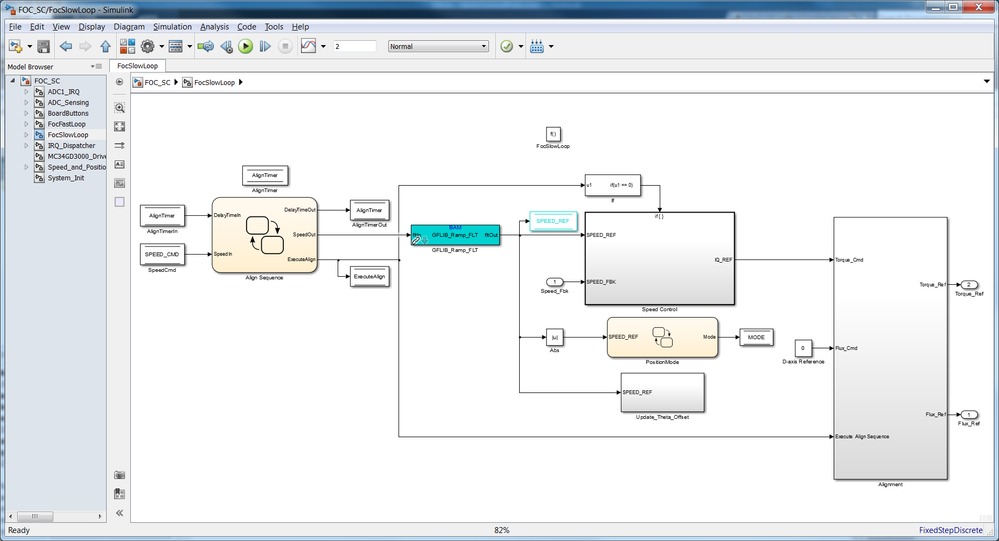

Furthermore, the Toque (Iq*) and Flux (id*) references are computed in the SLOW CONTROL LOOP block that is triggered at each 1 millisecond based on the same ADC events.

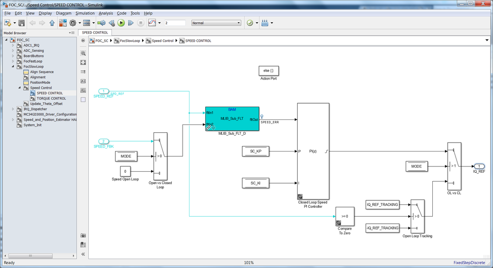

The block diagram of the SLOW CONTROL LOOP is shown in Fig. 4. As can be seen, the same software configuration based on MODE and CONTROL TYPE is used here as well to select between TORQUE and SPEED control types. The speed commands ω* are received via the UART or from on board push buttons and feed into a PI controller together with the actual rotor speed feedback ω. The PI Speed Controller implements a standard Simulink PI parallel controller that takes as input the error between the speed set point and the actual rotor speed and computes the appropriate torque command Iq* that compensates for the speed error.
Fig. 4: Closed Loops Speed Control - Block diagram
As can be seen in Fig. 2, Fig. 3 and Fig. 4 the key information needed for speed closed loop control is the actual rotor position information. Therefore, lets see how can we obtain such information.

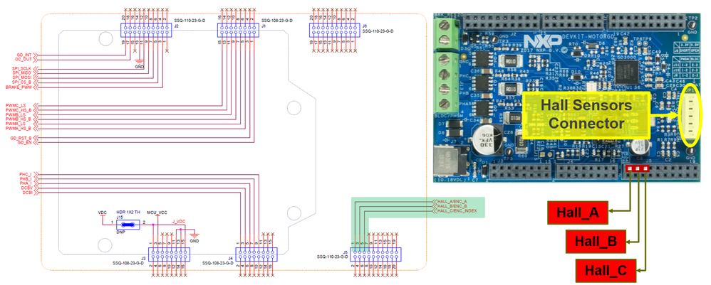

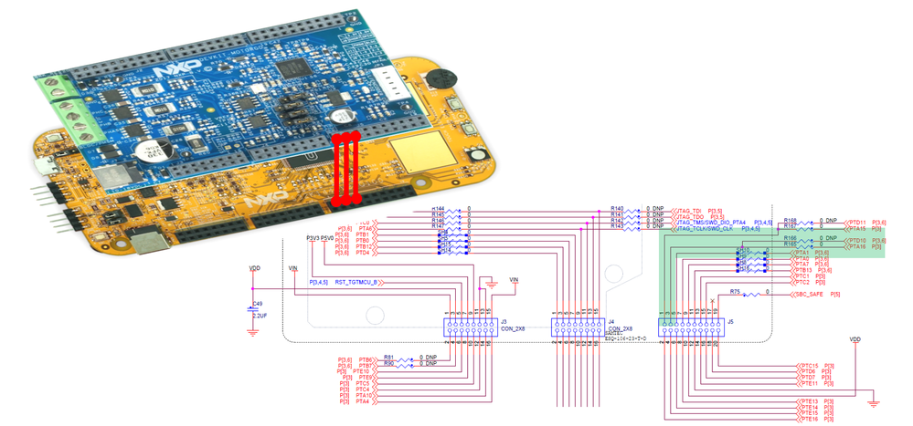

In case of the DevKit MotorGD the Hall sensors are connected via JP1 connector on the motor shield as shown in Fig. 5. The JP1 connector provides 5V power supply to the motor Hall sensors and reads back the digital signals in range of 0 - 5V.
Fig. 5: DevKit MotorGD pins used for Hall sensors
The signals from Hall sensors are then sent to the S32K144 Evaluation board via the J5 header as shown in Fig. 6 and the S32K MCU will read those from the PTA15, PTA16 and PTA1 digital inputs pins.
Fig. 6: S32K144 Evaluation Board MCU Signal Assignment

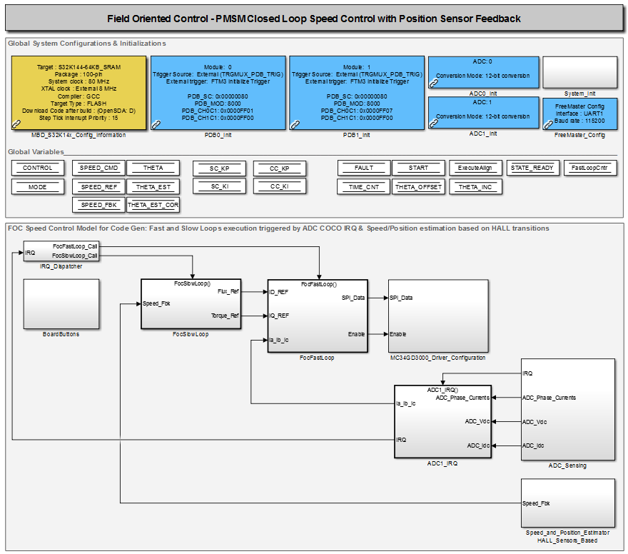

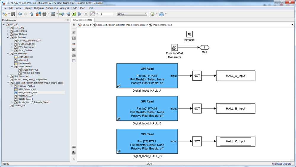

Getting the actual values of the Hall signals is a piece of cake when using the NXP Model-Based Design tools. Using a simple digital input block you can read each hall signal individually and store it in a global variable as shown in Fig. 7.
Fig. 7: Simulink model for reading the Hall Sensors with S32K14x MCU
On S32K14x Evaluation Board these signals are inverted. To get the same logic value as the true Hall input we need to invert the acquired value in software.

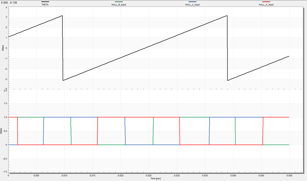

Using the Simulink model shown in Fig. 7 we can read the Hall signals variation in time for a PMSM rotating at a constant speed. Fig. 8 shows the three Hall signals that are phase out with 120 electrical degrees in between each other while each hall signal is ON/OFF for 180 electrical degrees.
Fig. 8: HALL sensors signals
Based on these considerations, it is easy to understand that for each 360 electrical degrees (THETA) we will have six Hall sensor transitions as shown in Fig. 9. These six transitions give us the possibility to measure the position of the PMSM rotor with an accuracy of 60 electrical degrees for any speed range.
Fig. 9: Hall sensors transitions versus one complete electrical rotation (-pi: pi) radians

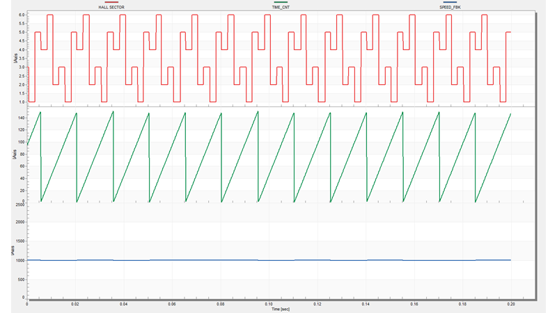

In Fig. 10 we have captured such use-case. On the top of the figure we have the Hall sensors variation captured as a Hall sSector representation in decimal form and on the bottom we have the timer values for each Hall sensors transitions. In this capture you can see that even if the motor is commanded to spin in torque control at constant speed the time counted between consecutive hall transitions presents a variation.
Fig. 10: Hall sector change timings
This variation is mainly cause by the undefined installation error of the three hall sensors which are not at a perfect 120 electrical degrees apart of each other. If we would try to build a speed estimator based on this approach we will have to deal with a lot of variations that are induced by this poor mechanical hall installation that might vary from one motor to the other.

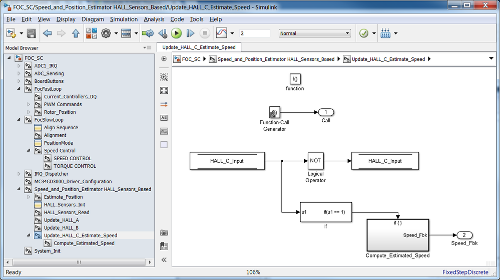

The new Simulink model that is supposed to handle this scenario is shown in Fig. 12. Each time there is transition from HIGH to LOW on the HALL C (is has been selected since from PCB point of view it is all the time routed to the MCU) the new estimated speed is getting computed.
Fig. 12: Simulink model used to compute the estimated speed based on one hall signal transitions
The formula implemented in the Compute Estimated Speed block is based on:
where:
  • ∆t is the time passing between 2 transitions of Hall C signal or 360 electrical degrees.
  • pp is the motor pole pairs
  • 0.0001 is the fast loop sampling time of 100 usec since the TIME_CNT is incremented in that loop
Eq. 2

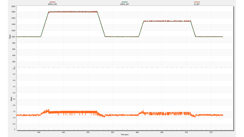

Using this approach we can estimate the actual motor speed far more cleaner that before. Fig. 13 shows the estimation results in the same conditions as the one from Fig. 11.
Fig. 13: Speed estimation by counting the time between one Hall signal transitions over 360 electrical degrees

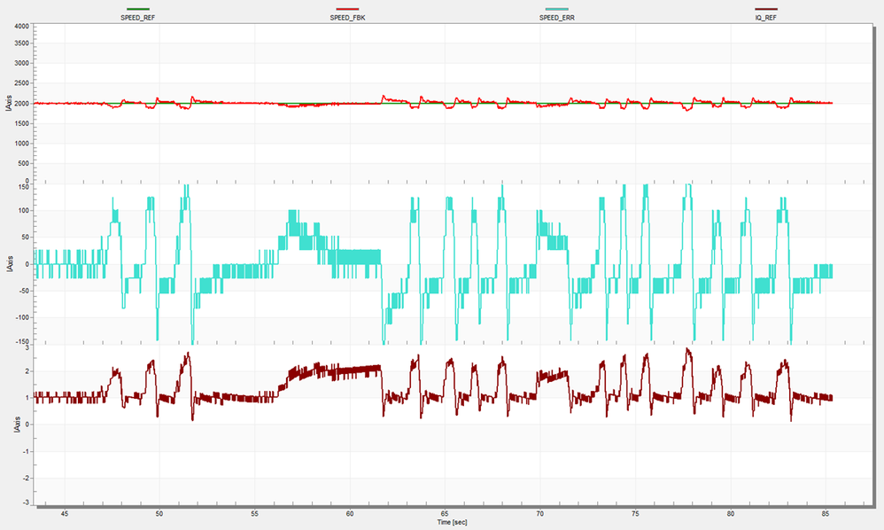

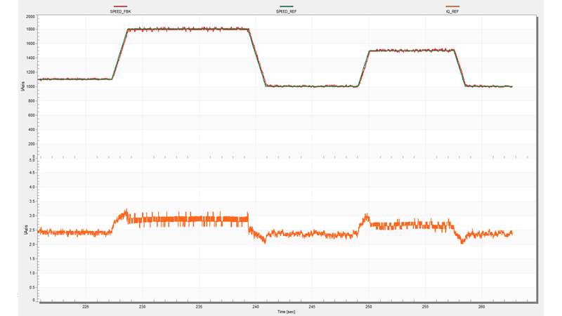

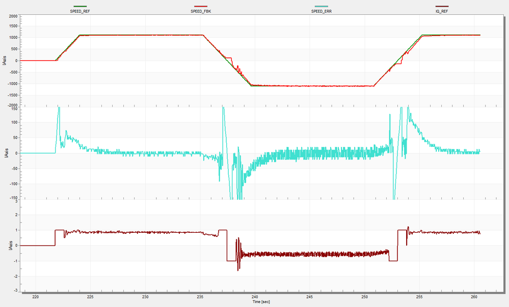

The dynamic results of the Speed Estimator are shown in Fig. 14 and Fig. 15 for startup and change of direction with zero crossing.
Fig. 14: Top: Reference (green) vs Estimated (red) Speeds, Bottom: Speed error between the reference and estimated speeds during motor startup
As can be seen, we have an expected larger error at startup until the motor starts to move constantly. Then during acceleration and steady state regime the error between the reference and estimated values are quite small +/-20 rpm which I think is quite good for this kind of approach relative to solution costs.
Fig. 15: Top: Reference (green) vs Estimated (red) Speeds, Bottom: Speed error between the reference and estimated speeds during change of direction with zero crossing
At this point I think we can say the speed estimator based on a single Hall sensor signal transitions is accurate enough for our purpose. The next question that rise now is: how to obtain the electrical angle that is used for FOC transformations that ultimately controls the rotor position?

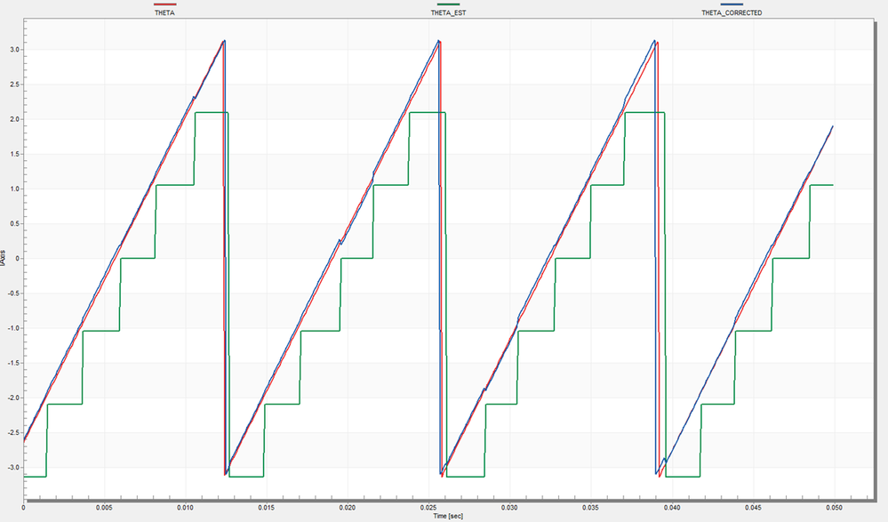

Applying all these knowledge we can compute a more accurate rotor position based on actual Hall sensors transitions and the estimated speed of the PMSM. Fig. 21 shows a comparison between the ideal rotor position (THETA) and the predicted position (THETA_CORRECTED) based on the algorithm discussed above.
Fig. 21: PMSM rotor position comparison:
(red) represents the ideal rotor position which is imposed in open loop Torque Control
(green) represents the coarse estimated rotor position with a 60 electrical degrees resolution based on Hall sensors transitions
(blue) represents the rotor predicted position based on Eq. 3 that includes the speed prediction
If we check the Fig. 21, we can spot a few things that needs to be addressed:
  • the predicted position (blue) must be scaled to be withing the (-pi:pi) radians range.
  • compensate the offset between ideal (red) and predicted (blue) positions

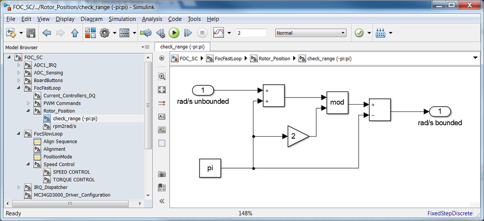

The first issue can be easily addressed in software and Fig. 22 shows how to deal with such aspects in Simulink.
Fig. 22: Bounding the estimated rotor position to (-pi:pi) radians using standard Simulink blocks

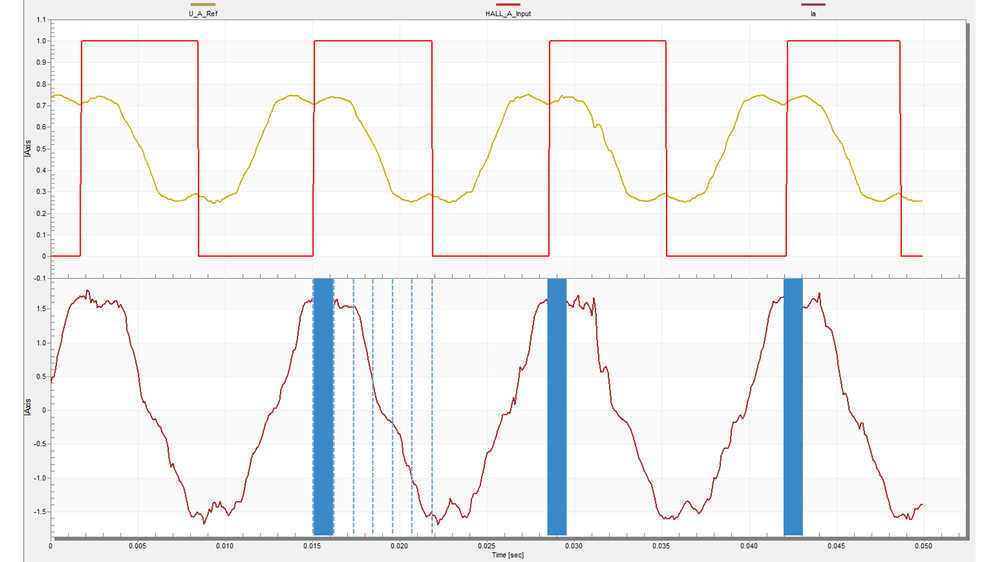

One of the most important control system design challenges is the phase lag between the commanded phase voltage impose via SVM and the resultant sine-wave phase current for that naturally occurs in an PMSM/BLDC motor. The PMSM can operate satisfactorily, but the overall efficiency will be reduced (as shown in Fig. 39), defeating much of the purpose of implementing a FOC control scheme that by definition should drive the motor at its optimal operating point.
The source of this inefficiency is not the phase lag between motor phase voltage and phase which some might think but rather the phase lag between phase current and the induced back-EMF voltage as it is shown in Fig. 23.
The Hall sensors are mounted in such way that when the induced back-EMF reaches its maximum value a Hall transition will happen. In this case, since we can measure directly the back-EMF with our model, it is safe to assume that back-EMF is synchronized with Hall transitions.
Fig. 23: Phase lag between phase voltage (U_A_Ref) and phase current (Ia) and the Hall A transitions that are synchronized with back-EMF in phase A
In order to eliminate this lag between the back-EMF (Hall A) and the phase current (Ia) we need to introduce a phase-angle advance to the sinusoidal drive current to ensure its peak coincides with that of the back EMF (Hall transition). This phase-angle advance can be easily deducted based on the FreeMASTER recorded captures and in my case it seems to be 1/6 from a Hall half period (the dotted areas) which can be translated in a pi/6 radians or 30 electrical degrees.
In general, the phase-angle advance is typically set to increase linearly with the phase command voltage, which determines the motor speed. Since our scope is to introduce general concepts and show how to implement them with Simulink rather than building a dedicated speed control system targeted for a particular motor - in this module we are going to use a constant electrical angle offset to compensate for this lag and drive the motor to its peak efficiency within a specific speed range.
Depending on your application you might need to consider this aspect.
The compensation of the electrical angle (Fig. 24) for clockwise and counter clockwise direction is implemented on the slow control loop and uses constant offsets that are added to the corrected electrical angle as shown in Fig. 21.
Fig. 24: Electric angle offset calculation for phase lag compensation
By using all these tricks we should be able to predict the rotor position quite accurately in both clockwise or counter clockwise directions as shown in Fig. 25 and Fig. 26.
Fig. 25: PMSM rotor position corrected (blue) with phase-angle advance of 30 electrical degree for clockwise direction
Fig. 26: PMSM rotor position corrected (blue) with phase-angle advance of 30 electrical degree for counter clockwise direction
Fig. 26 shows a 180 degrees angle shift between the coarse angle obtained from Hall sensors (green) and the electrical angle corrected due to the mechanism used for calculations. To keep the same algorithm implementation for both directions, the corrected angle is shifted in software with (pi-pi/6) radians
As can be seen in both Fig. 25 & 26, there is a small jitter present on the predicted rotor position which is due to keeping the same angle increment over 360 electrical degrees and small variations with the estimated speed, but that should not be an issue for the control system.

Fig. 30: FAST CONTROL LOOP Simulink Model: Note the Rotor Position subsystem that computes the angle needed for PARK transformations.
Fig. 31: Rotor Position Conditioning for addressing all application use-cases:
- Speed Control vs. Torque Control
- Open Loop vs. Closed Loop
- Normal Operations vs. Rotor Alignment
The actual speed control is implemented as normal in the slow loop using the Simulink model shown in Fig. 32.
Fig. 32: SLOW LOOP CONTROL Simulink Model
The speed is regulated with the help of standard parallel form PI controller that is setting the motor torque reference  IQ_REF based on the error between the SPEED_REF computed as the output of the RAMP block and the actual motor speed estimated from HALL C sensor transitions (SPEED_FBK). The controller output is limited in order to avoid a high current thru the motor and anti-windup based on clamping strategy is enabled.
Fig. 33: PI Speed Controller implementation with additional signal conditioning for handling startup and zero crossing
The final model used for closed loop speed control is shown in Fig. 34. This model is more or less universal and represent the basic form of any speed control system based on Field Oriented Control and cascaded loops for dealing with electrical and mechanical parts of the PMSM or any motor in general.
Fig. 34: Simulink model of the Closed Loop Speed Control system for PMSM with S32K14x MCU

The next figures shows the closed loop system response under various conditions. Fig. 35 & 36 shows the system response during startup and various speed levels. Note how the PI speed controller is able to maintain the rotor speed with very good precision with a narrow band of less that +/- 100 rpm during accelerations, decelerations and steady-state regimes.
Fig. 35: System startup: TOP- reference vs. actual motor speed [rpm], MIDDLE - speed error [rpm], BOTTOM - PI Speed Controller output torque reference [Amps]

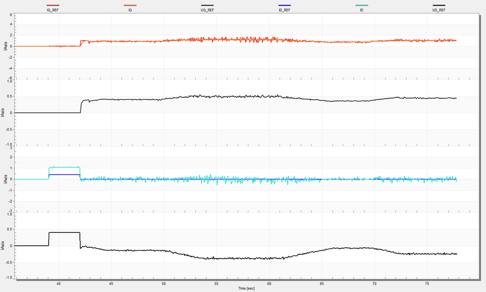

Fig. 36: Field Oriented Control algorithm responses for the profile shown in Fig. 36
- TOP 2 graphs: Q Axis Torque Controller inputs (IQ_REF, IQ) and output voltage command (UQ_REF)
- BOTTOM 2 graphs: D Axis Flux Controller inputs (ID_REF, ID) and output voltage command (UD_REF)
Fig. 36, demonstrates how the current controllers operates under acceleration and deceleration regimes. Note how the D-axis current controller is adjusting the control voltage in D-axis to compensate for additional back-EMF in oder to keep a zero magnetization current ID.
Fig. 37, shows the system response during startup and change of direction. Note how the handover is done between closed loop and open loop control strategies and how the rotor stops for a moment when changing directions.
Fig. 37: Motor Startup and Zero Crossing (same quantities as in Fig. 35)
If all the results above were perform under no load conditions, the Fig. 38, shows the system response under the effect of disturbances. The motor is kept at a constant 2000 rpm speed level when suddenly random load torque are applied on the rotor shaft. The Speed Controller reacts very quickly increasing the demanded torque to compensate for the lost in speed.
Fig. 38: Speed Controller perturbation rejection

My Hall Sensors PINs were not connected the proper way. Seems like HALL_A is on PTD11 and HALLB is on PTD10.
I can make the motor spin now, but it is surely behaving odd.
Firstly, for a reference <300 RPM, the motor spins CW. After that value, the motor starts to spin CCW. Also, the motor is making a strange noise, not like the one heard when using the Torque Control Project that works completly fine.
I cannot hold the motor at 1000 RPM more than 10 sec because it enters in the FAULT mode.
Also, my signals look strange. Can you have a look, please? Do you have any suggestions?

For that I've this simulink model:
But any time I activate the "Test Pin" Option of the "Speed [rpm]" Signal the code isn't running any more.
Also a additional testpin at any other place leads to the Problem.
The three testpins DSPI Receive, Angle and Angle [rad] are fine.
Without the additional test pin everything is fine and the Motor spins at 1000rpm.
What is wrong here ?

So I wanted to implement a if Action Subsystem at the value 4095 which is the greatest possible value of the Encoder.
But if i comment in the estimated Speed Subsystem the code doesn't run any more.
The Content of the Subsystem doesn't madder, it could be empty.
For the Moment it is this:

Now here is my result for alignment, +1000rpm and changing direction to -2500rpm

I changed the model a Little bit to become clearer.
It works until I activate the marked test pin, so I expect a Problem in the add block ??
How could that be ?
Also I've found a Memory block in the library.
where is the difference between the delay and the Memory ?
Also if I want to store the actual value in a Memory block the code isn't running.
I don't know what to do and hopefully you could help me ?
best regards
Leon
43,058件の閲覧回数
lethuer
Contributor V
Hallo dumitru-daniel.popa‌
could you give me some recommendations or do you have an idea why the code isn't running after download to the target if I activate the test pin or want tp use a data store memory block ?
How would it be possible to store the last values for calculations ?
Only using the Delay or Memory block works and also I'm able to see the values with FreeMaster.
But if I want to store the actual value in a data store Memory there are some bad circumstances.
Also if I want to activate the test pin Option for freemaster.
Leon
43,059件の閲覧回数
lethuer
Contributor V
because I'm not able to connect with freemaster any time I have a add block in the model for dspi I think that the add block is the problem.
I tried to change some Settings in the add block, obviously without having success. I tried all of the integer rounding methods.
For example I simple want to add "1" like in the post above.
https://community.nxp.com/thread/471093#comment-1009815
Any help for me ?

wangxuan
Hi,@dumitru-daniel.popa
  Thank you for your hard work. It's very valuable to us. There is one point I didn't understand:
   There is a hint in the article.
    Why is there a 180 degree shift, can you explain it further?
wangxuan
43,057件の閲覧回数
Daniel_Popa
Hi wangxuan,
To answer your question i'm going to use on picture from a motor manufacturer catalog - to be easier
Keep in mind that we are using the Hall sensors just to get the motor position coarse angle. For that we have built a table shown in Fig 16 to know which hall patterns corresponds to a clockwise direction. The hall pattern: 1-5-4-6-2-3 (same as the one shown in above picture but from right to left).
Now, look at the rotor magnetic field N-S poles. If you want to change the direction - then you need to reverse the poles - which are at 180 electrical degrees one of the others.
Hope this helps!

The setup used to run the M8 Simulink model is shown below:
Make sure the motor and phase/sensors connections are correct.
Steps to run the application on  S32K144 3-phase PMSM Development Kit|NXP
  1. Connect the microUSB between S32K EVB and PC
  2. Power on the MotorGD with 12Vdc
  3. Build and Download the Simulink model attached to the M8 module. Make sure you are using the latest MBDT and all patches are installed
  4. Press the RESET button on S32K EVB - the green LED shall be green
  5. To start the application press on SW3 once. The motor align procedure shall start and the LED shall blink green
  6. The motor shall start spinning in clockwise direction. The LED will blink blue if the motor is spinning otherwise will stay blue
  7. Use SW2/SW3 to change the motor speed
Using FreeMASTER project attached you can visualize the motor behavior in real time:
  • Startup speed comparison and speed error for clockwise direction
  • Speed controller response
  • Current controllers response in case of disturbance
Due to motor backEMF, the limited amount of DC voltage and the current measurement technique, do not exceed 1200rpm with the current setup since the motor might stall due to voltage saturation.
