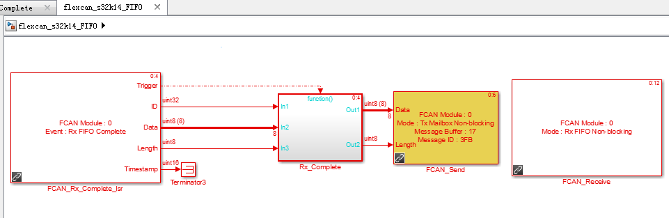

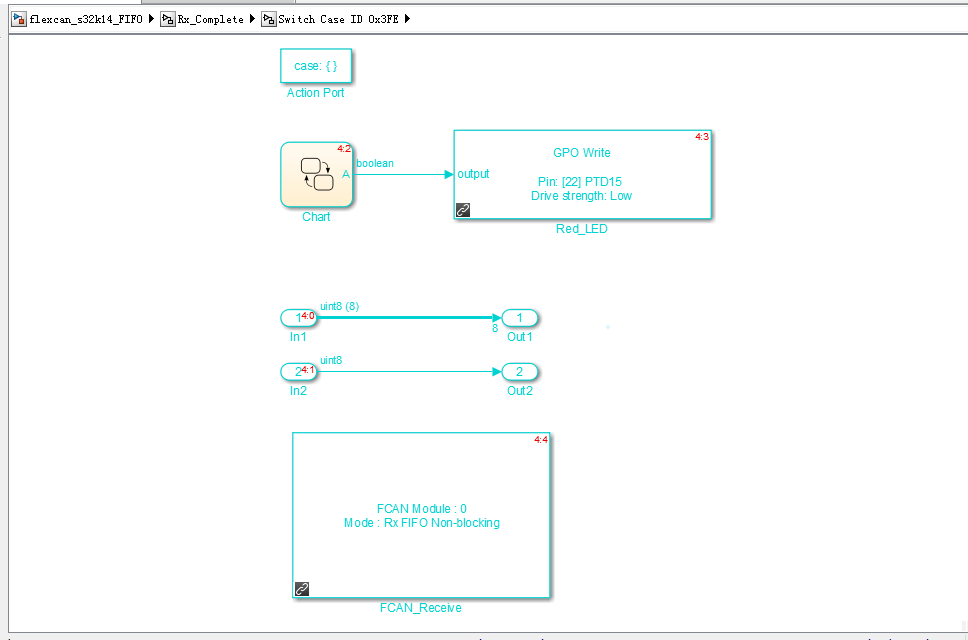

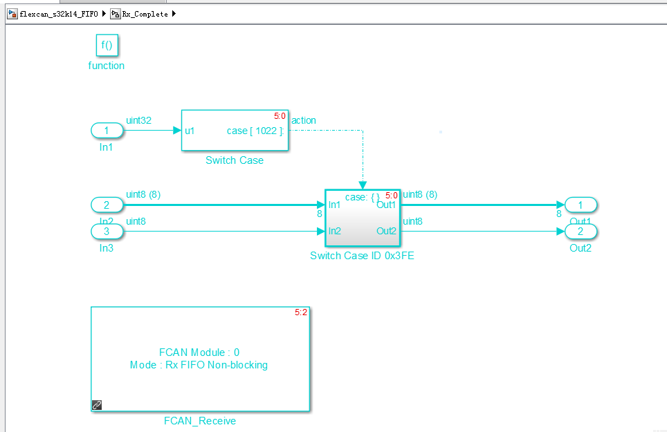

Hi:
   I 'm using FlexCAN Model in MBD ToolBox, I change the example model flexcan_s32k14 like this: pastedImage_219.png
pastedImage_225.pngI send a Message (ID:0X3FE) to the S32k144 EVB. It send the message (ID:0x3FB) back.The question is why the data in message EVB sends out(ID:0x3FB) always the last Data it receievd, how to make the data be zeros or a default value while I didn't send Message for longer.

Hello 李风heart‌,
Can you share your model? Or just the part with CAN that is of interest? I'd like to take a look and get a better understanding of what you are doing versus what you want to achieve and looking into the model would help.

Hi constantinrazvan.chivu,
   This is my demo model, I just want to make the data in Message '0X3FB' be zeros while I didnot Send '0x3FE' to S32K board.

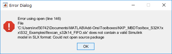

Hello 李风heart‌,
Can you check you have sent the correct model? I'm having trouble opening it - I've tried in MATLAB R2017b, 18a, 19a, and the error is the same.
It would be good if you could export the .slx to .mdl format.
