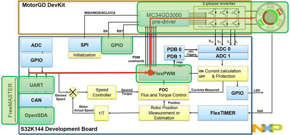

In Fig. 1, which represent the global application mapping diagram as discussed in Module 3: System Partitioning , are shown the main hardware blocks that are going to be configured and the control path we are going to follow (with red line). To achieve V/F scalar control we are going to configure the S32K FlexTimer peripheral to generate six PWM signals that are used to control the MotorGD Development Kit DC to AC power inverter via a dedicated MOSFET pre-driver chip: MC34GD3000. To enable the MC34GD3000 chip operation we will need to control two additional signals : Enable and Reset via dedicated GPIO.
The interactions between host PC and hardware will be done via OpenSDA serial communication that will be used to download the code generated from MATLAB and to visualize various control signals with FreeMASTER.
Fig. 1: Application Mapping -  HW & SW modules used for V/F Scalar Control are highlighted in green
After the control algorithm verification & validation but prior to connecting the PMSM Linix motor, we are going to check the PWM signals with an oscilloscope. This will ensure we are following all hardware recommendations and since we do not have yet active protections, it will spare us from unpleasant surprises.

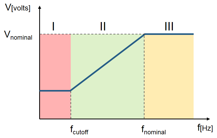

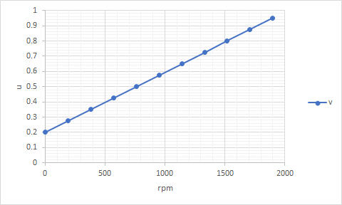

In V/F scalar control method the frequency of the stator magnetic flux is set according with the desired synchronous rotor speed while the magnitude of the stator voltage is adjusted to keep the ratio between them constant. No control over voltage or current vectors angles is utilized, hence the name scalar control.
The V/F ratio is calculated from the nominal values of the PMSM voltage and frequency parameters. By maintaining a constant V/F ratio between the amplitude and frequency of 3-phase voltage waveforms, then the stator flux of the PMSM can be maintained relatively constant in steady state. However, in practice a typical V/F profile is not constant over the entire range of motor speed.
As can be seen in Fig. 2, the V/F profile may be divided in three main regions:
  1. Compensation – a higher than normal voltage is required to compensate the voltage drop across the stator resistance that was neglected for simplified mathematical model
  2. Linear - follows the constant V/f relationship as derived from (eq. 5)
  3. Field weakening - constant V/f ratio cannot be satisfied due to the stator voltages limitation at the rated value in order to avoid insulation breakdown
Fig. 2: V/F profile practical aspects

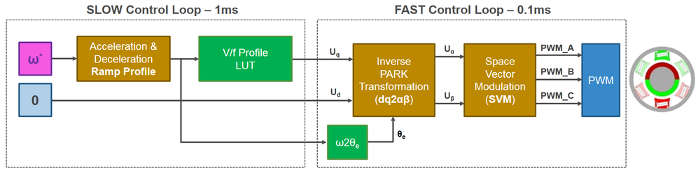

In case of PMSM, both open and closed-loop control of the speed can be implemented based on the V/F scalar control. Open-loop control is used in applications where system dynamic response is not a concern. For such use cases, the frequency is determined based on the desired speed and the assumption that the rotor will ultimately follow the synchronous speed.
Throughout this module we are going to implement an open-loop control system topology for a 3-phase PMSM using V/F scalar control as the one shown in Fig. 3. Such control structure will allow us to control the PMSM speed without any feedback of motor parameters or rotor position. The motor is driven by the conventional 3 phase voltage-source inverter via MotorGD DevKit. The NXP's S32K MCU is being used to generate the six PWM signals using a modified SVM PWM technique with 3-rd harmonic injection.

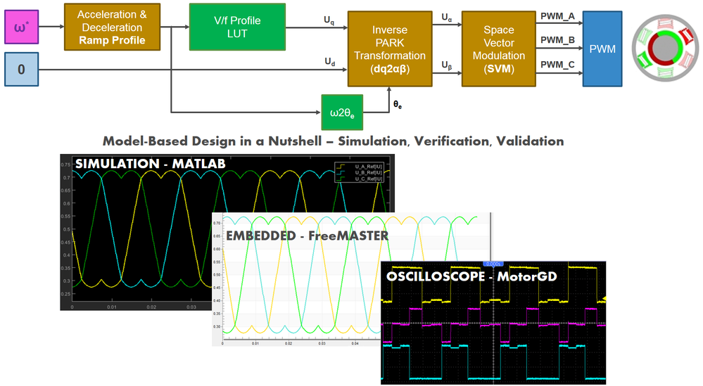

Fig. 3: V/F scalar control block diagram

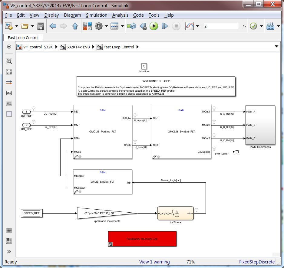

In order to maintain a similar topology with two control loops and similar data structures for the examples that we are going to use in this workshop, we are going to implement the V/F scalar control application based on:

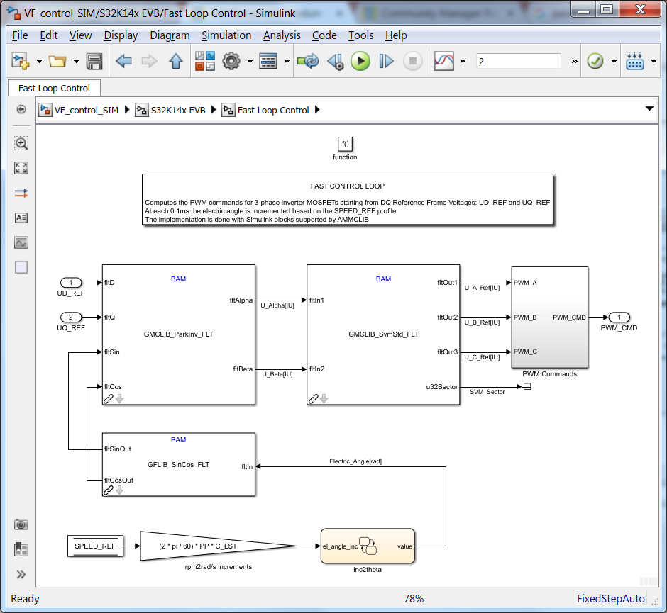

  • FAST control loop is executed at each 0.1ms and computes the PWM duty cycles based on Space Vector Modulation. The reference voltages for (dq)-axes and the motor electrical speed represent the inputs. The electrical angle needed for Inverse Park Transformation is computed based on electrical speed reference.

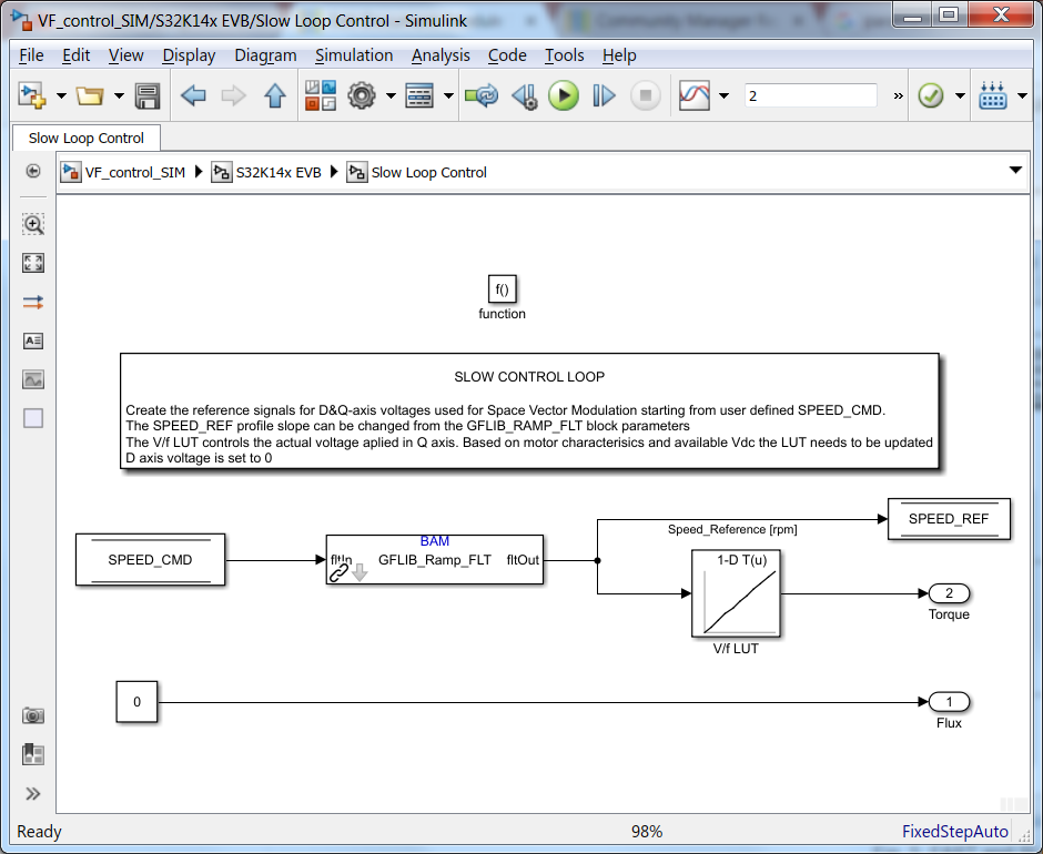

  • SLOW control loop is executed at each 1ms and provides the voltage references for Inverse Park transformation and the electrical speed profile. Inside this loop, the user commands are handled and based on a parameterisable Ramp Profile the appropriate control parameters are generated. The V/F profile is implemented via a tunable Look-Up-Table (LUT)

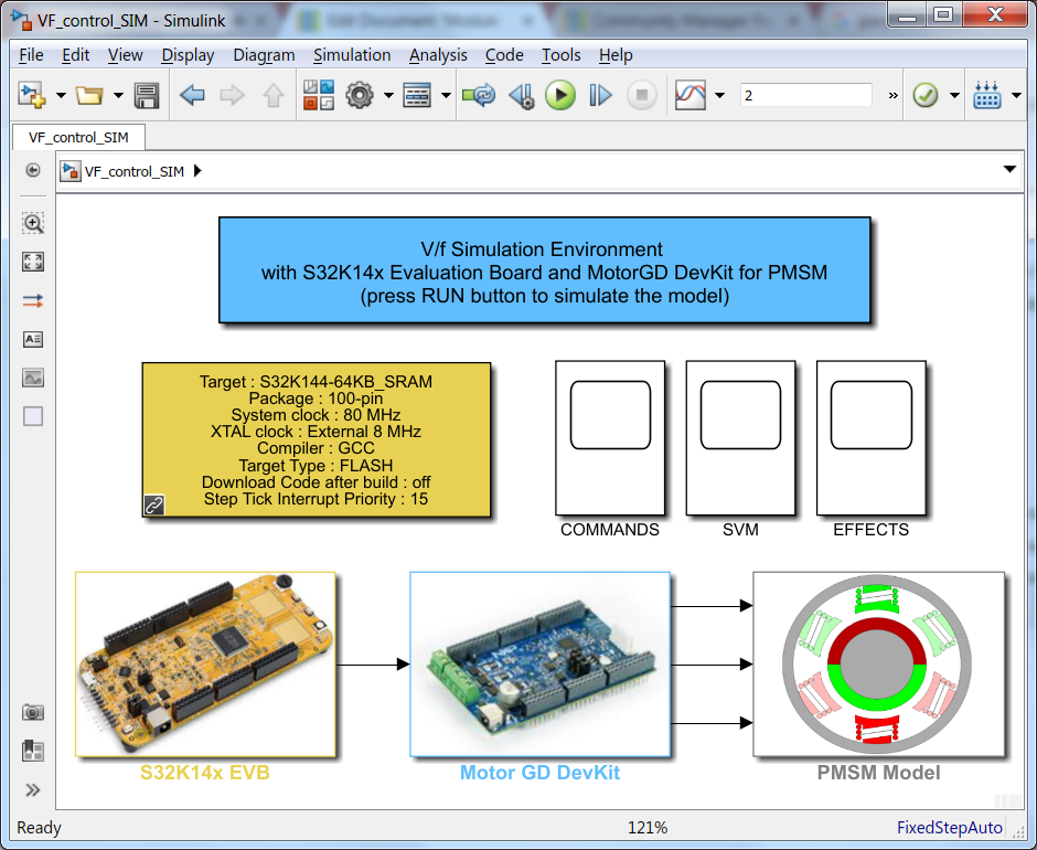

Fig. 4 shows the Simulink model we are going to use for V/F scalar control implementation, testing and validation. The model can be find attached at the end of this article.
Fig. 4: Simulink model for the entire plant: MCU-DC2AC INVERTER-PMSM
The model shown in Fig. 4 consists in three major subsystems that mimics the actual hardware arrangement, each one of them implementing a specific functionality:
  • S32K14x EVB - implements the S32K MCU logic that allows the control algorithm to compute the PWM commands for the power inverter;
  • Motor GD DevKit - implements a simplified model of power inverter that converts the PWM commands into high voltage continuous signals;
  • PMSM Model - implements a simplified PMSM motor model that replicates the behavior for the real LINIX motor.

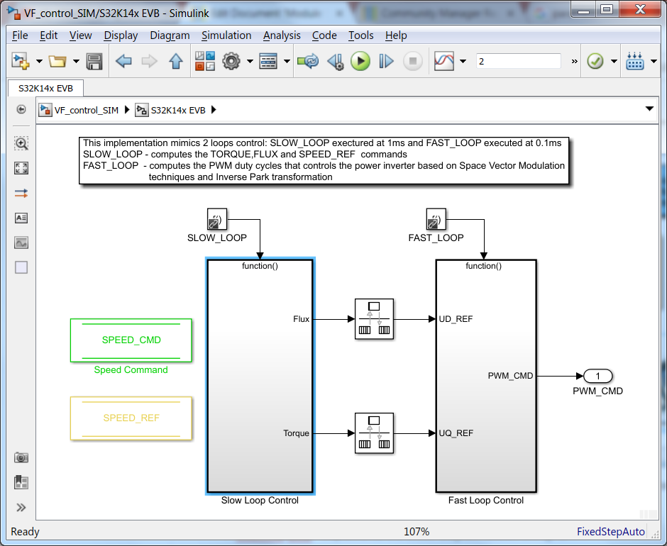

This is a discrete model that implements the V/F scalar control block diagram shown in Fig. 3. There are 2 subsystems that are triggered based on specific timing intervals. These 2 subsystem mimics the existance of the separated digital control loops: SLOW & FAST
Fig. 5: FAST and SLOW control loop model
The SLOW Loop Subsystem Fig. 6, updates the commands for the FAST Loop Subsystem shown in Fig. 7. Based on the SPEED_CMD set by the user as motor target speed, a trapezoidal speed profile is generated using a dedicated Simulink block exposed by the AMMCLIB Add-on. Based on this SPEED_REF the electrical angle used for Inverse Park transformation is going to be derived.
Fig. 6: SLOW control loop model

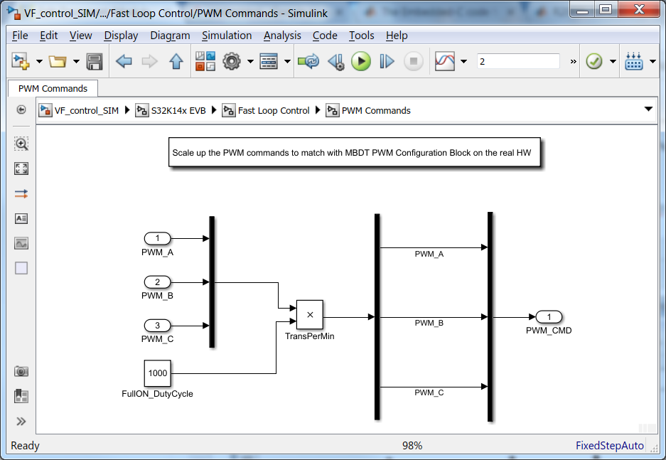

The quadrature voltages alpha-beta are computed based on the electrical angle and the (dq) reference voltages obtained in SLOW Loop. In case of UD_REF the value is set to 0 just to emulate the theory behind FOC and in case of UQ_REF the value is obtained from a Look-Up-Table (LUT) that implement the concept of V/F scalar control.
Fig. 7: FAST control loop model
At each 0.1ms the PWM commands are computed and updated based on AMMCLIB specialized Simulink block that implements and optimized Space Vector Modulation with 3rd harmonic injection. These PWM commands are then passed to the next subsystem that emulates the operations for power inverter.

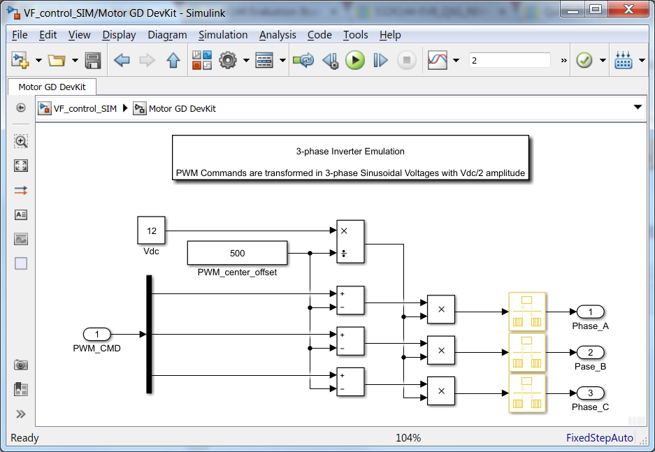

MotorGD DevKit Subsystem

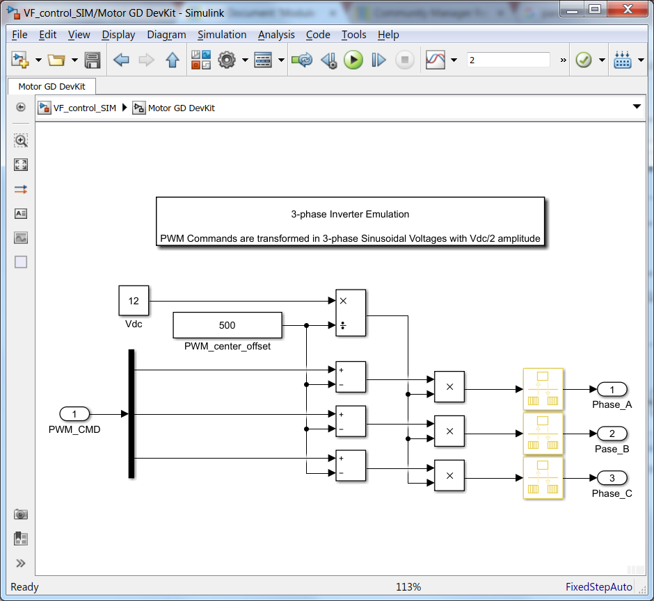

This subsystem implements a basic model to emulate the DC2AC power inverter. The PWM commands are converted into high voltage signals (depending on the Vdc value selected) that are then applied to the motor windings.
Fig. 8: Simplified Power Inverter model

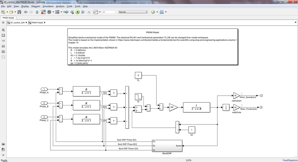

PMSM Model Subsystem
The Simulink model consists in standard 3-phase PMSM motor equations shown in Module 2: PMSM and FOC Theory. Within the model you can easily identify:
  • stator windings electrical model
  • electro-mechanical model
  • sinusoidal back-EMF model
Fig. 9: 3-phase PMSM model
Note 1: we are not going into details about PMSM modelling since this is not the purpose of this module. Feel free to follow the link indicated in the model to get more details. As usual, if you have any questions about it, feel free to ask.

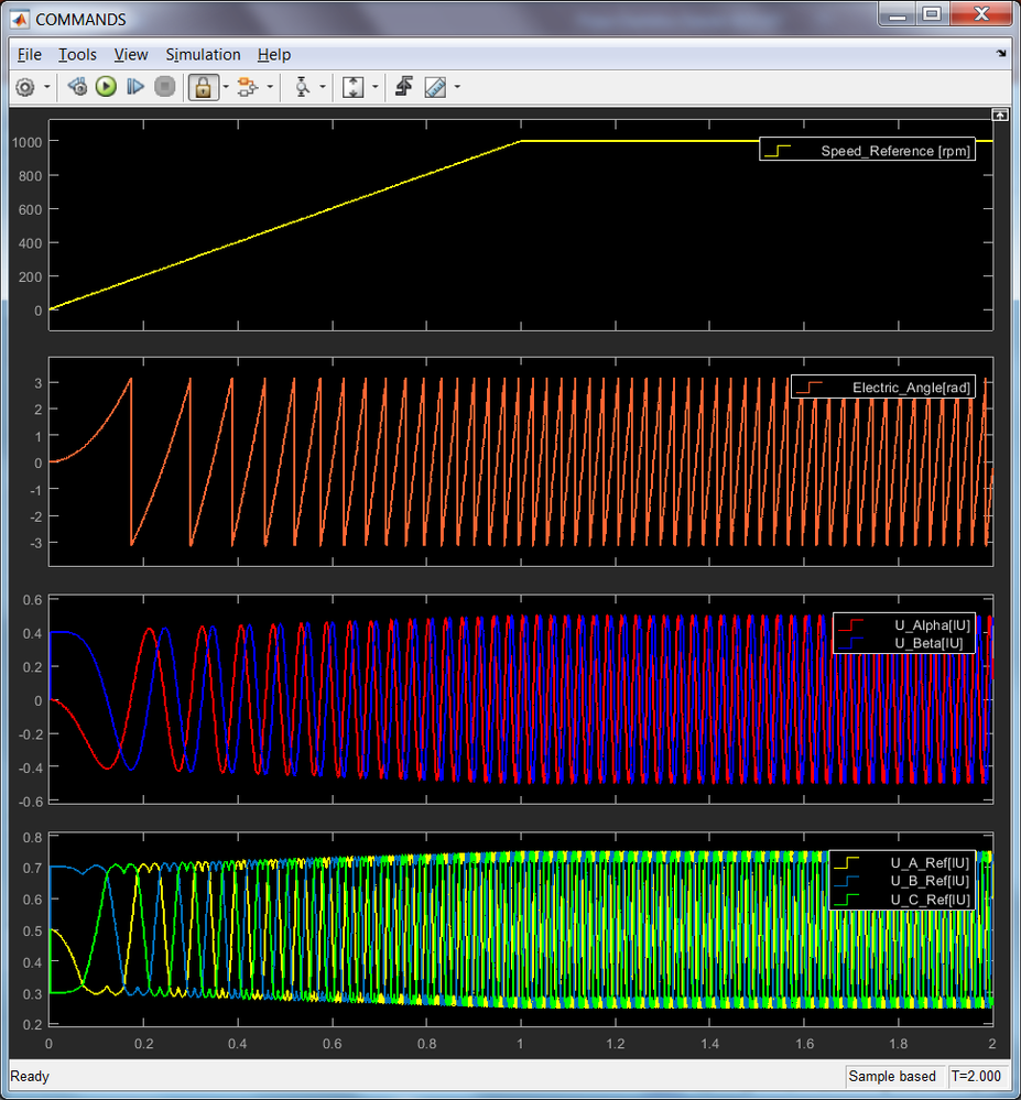

MATLAB SIMULATION OF THE PLANT
The entire V/F scalar control algorithm (...and not only) can be validated using this simulation environment provided in MATLAB/Simulink. This way we can validate the Space Vector Modulation, V/f scalar control and PMSM motor dynamic responses even without having the actual hardware setup. For those of you planning to use NXP hardware in the future, this approach might be useful in getting familiar with motor control.

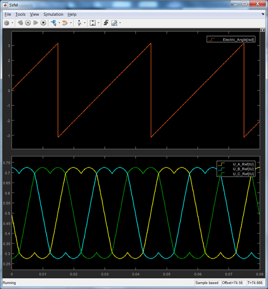

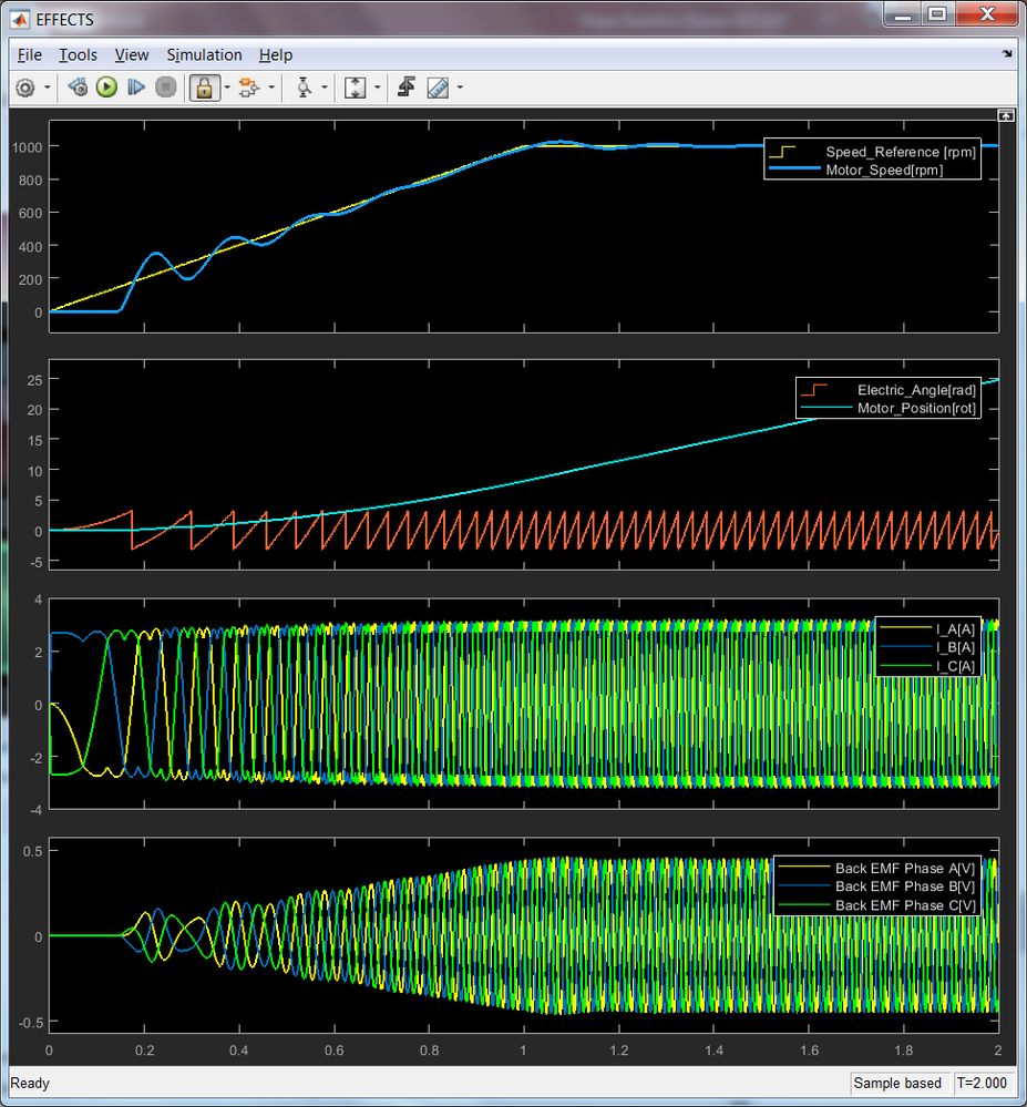

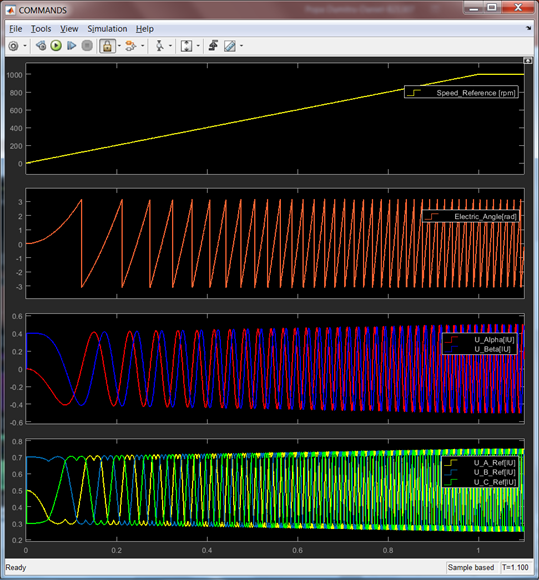

Fig. 10, 11 and 12 show the main control signals and outputs for each subsystems discussed earlier. At this point we can investigate various quantities that might not be easily accessible on the real plant.
Fig. 10: V/F scalar control commands in case of start-up ramp:
(1) Speed Profile, (2) Electric Angle, (3) quadrature voltage references and (4) 3-phase stator voltages references

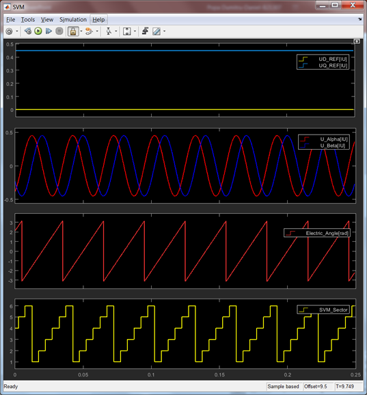

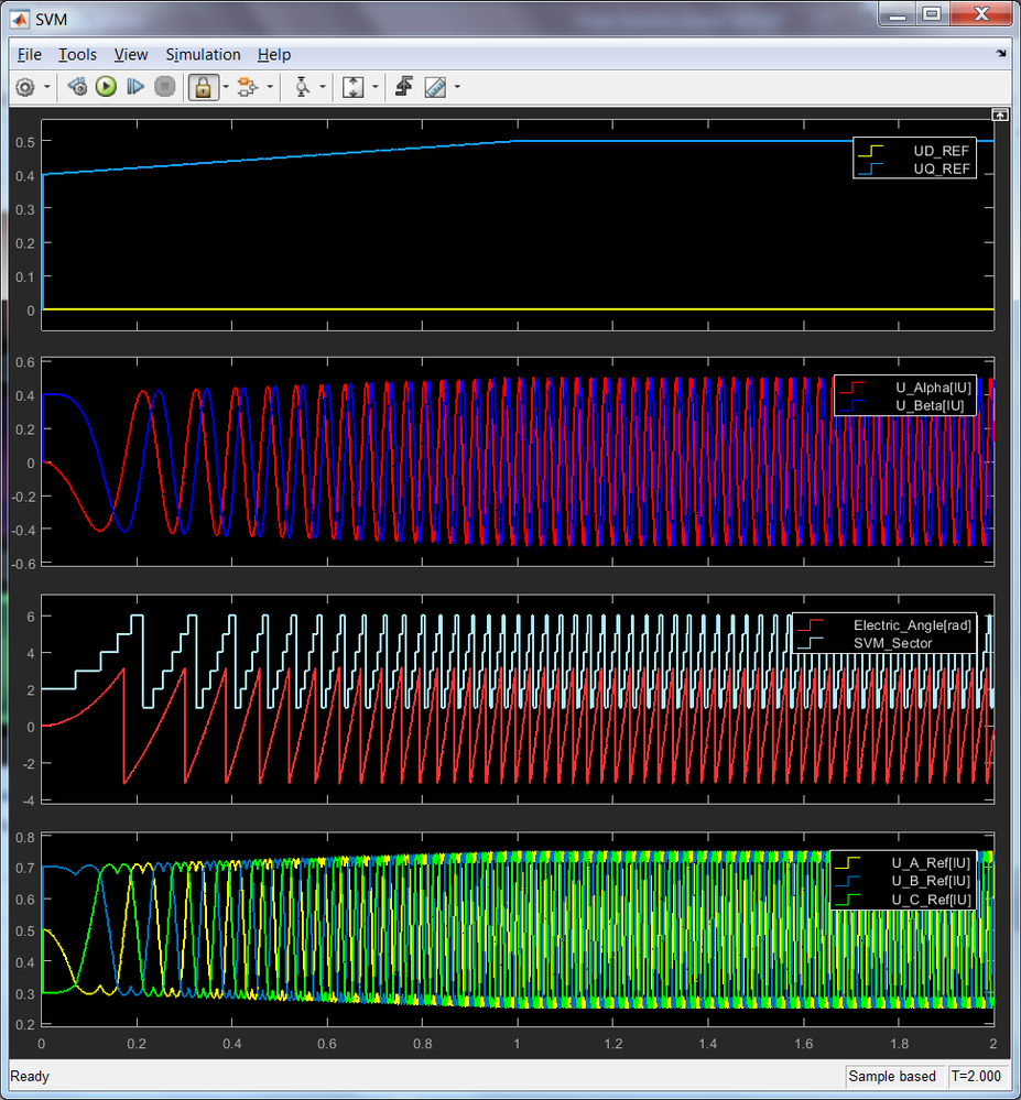

Fig. 11: Space Vector Modulation verification: Inputs & Outputs
Fig. 12: PMSM Model Responses in case of start-up sequence:
(1) Command vs. Actual Motor Speed, (2) Rotor angle vs. Rotor position, (3) Stator Currents and (4) Back EMF voltages
As can be seen there is a good match between the results obtained in simulation and the PMSM motor theory. Now that we have built confidence in the results it's time to move on to next stage.

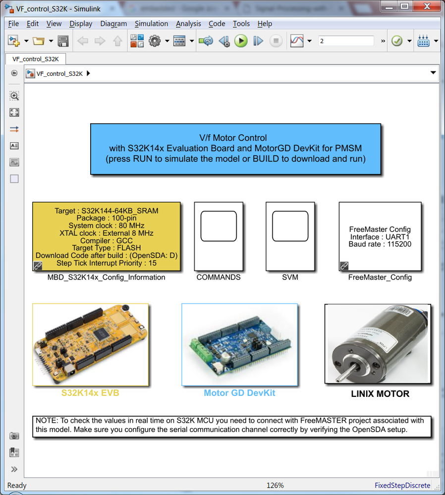

Since the modelling and simulation phases are completed with satisfactory results, it is time to convert the Simulink model and adapt it for Code Generation. The Fig. 13, shows the actual model that we are going to use the Code Generation.
Fig. 13: Simulink model for S32K embedded target code generation
The model depicted in Fig. 13 is derived from the one shown in Fig. 4 and almost 90% of it share the same similarities. To have the model suitable for code generation there are a few modifications that needs to be done:

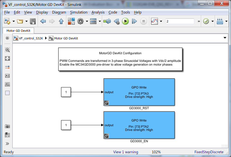

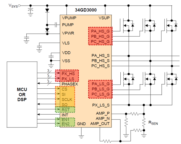

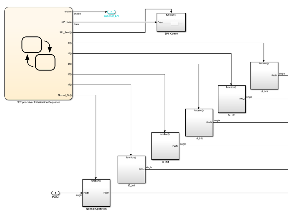

MC34GD3000 Pre-Driver Enablement
The MC34GD3000 is a field effect transistor (FET) pre-driver designed for 3-phase motor control and similar applications. The IC contains three high-side and three low-side FET pre-drivers. Three external bootstrap capacitors provide gate charge to the high side FETs. The IC interfaces to a S32K MCU via six direct input control signals, an SPI port for device setup and asynchronous reset, enable and interrupt signals. As it is shown in Fig. 14, the MC34GD3000 MOSFET pre-driver needs to be enabled before PWM signals generation.
The pre-driver can be configured over SPI communication to enable various features. Please check the MC34GD3000 for details. In this module we are not going to use this feature.
After IC initialization phase is complete, the device goes into the enable mode and operates normally. Normal operation continues in this mode as long as both enable pins EN1/EN2 and RSTB are high.
Fig. 14: MC34GD Pre-driver pins

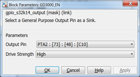

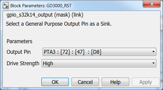

Add S32K dedicated peripheral blocks for GPIO to enable the MC34GD3000 pre-driver normal operation and remove the existing simplified simulation model blocks.
Fig. 15: MotorGD subsystem: on the left - simplified inverter Simulink block diagram, on the right - S32K GPIO peripherals that set EN1/EN2 and RST pins to high
Fig. 16: GPIO Configuration for Enable and RST signals

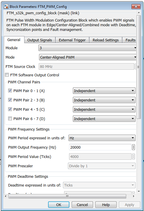

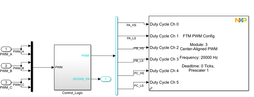

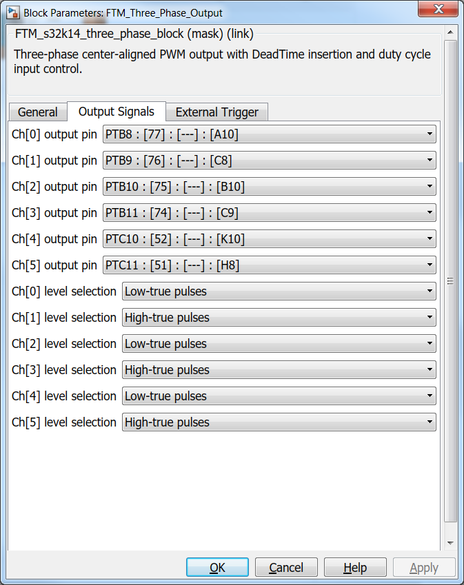

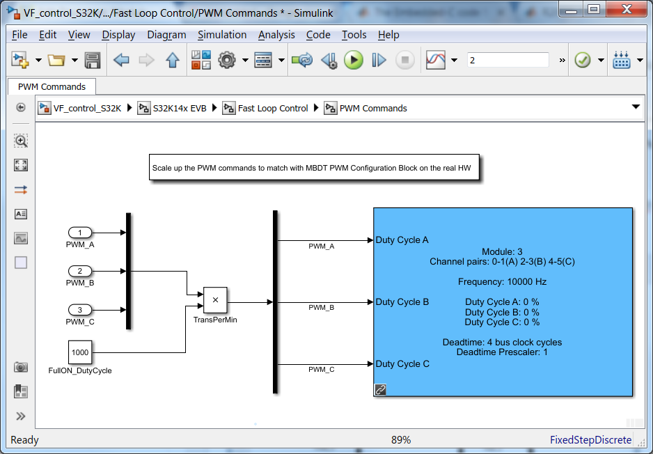

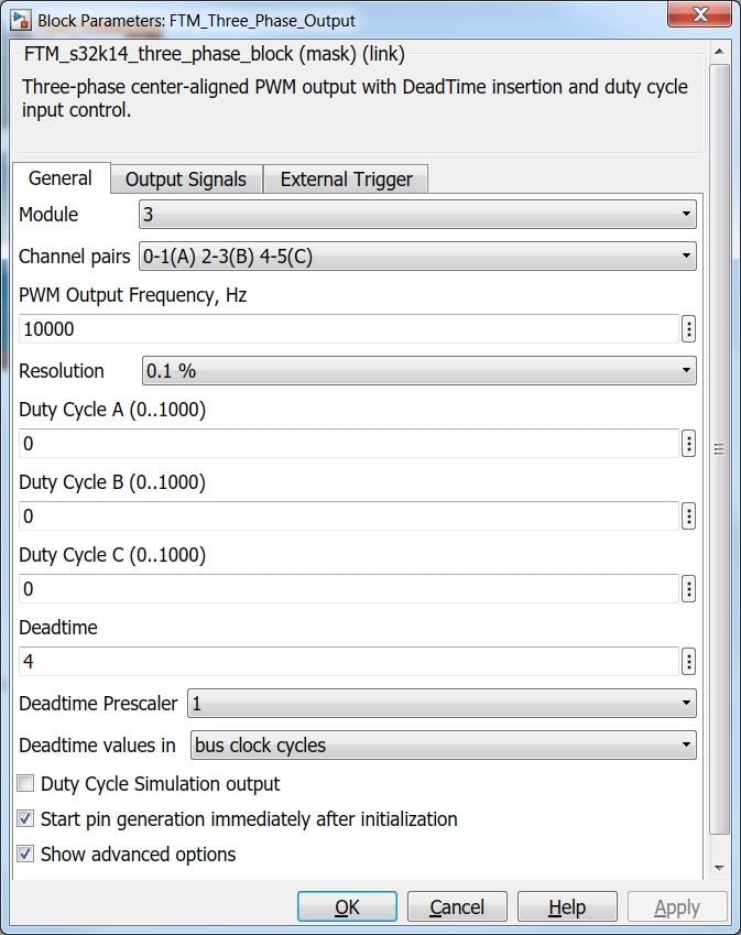

The most important aspect of the whole application is to be able to generate the PWM signals based on the Space Vector Modulation technique and pass these signals to MC34GD3000 pre-driver. NXP's Model-Based Design Toolbox for S32K1xx address this issue in a very simple and convenient way by providing a S32K dedicated peripheral block for FTM as shown in Fig. 1
Fig. 17: PWM generation in Simulink modelling vs. PWM generation used for code generation on S32K
The FTM Simulink block is configured to initialize the FTM3 module since the output signals from that specific module are routed on the PCB to control the actual power inverter MOSFETs. The schematic for the MotorGD DevKit Fig. 18, shows the actual signal routing.

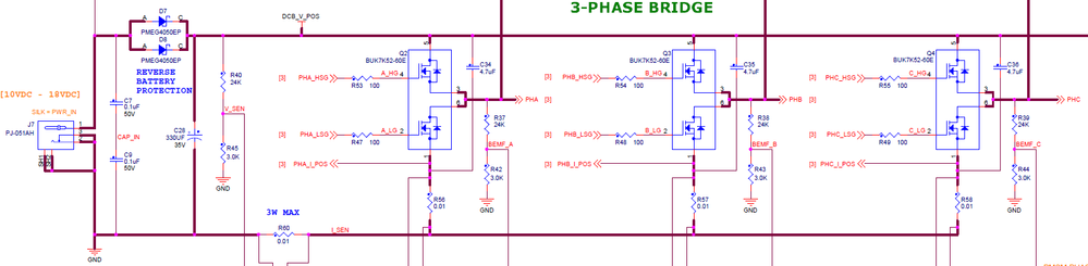

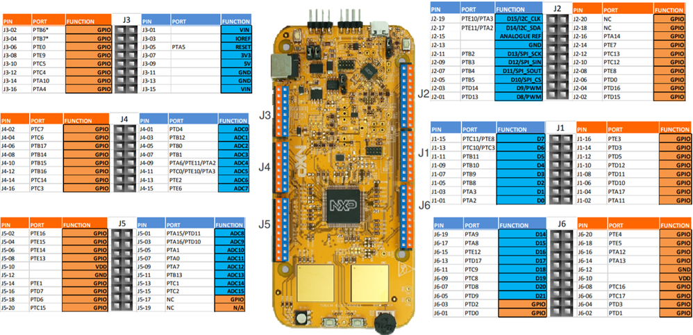

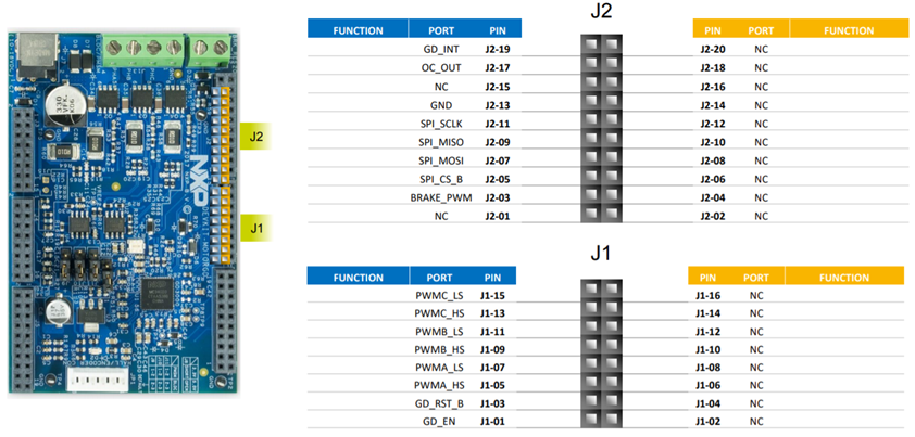

The MotorGD DevKit was designed to be compatible with Arduino shields, therefore only some specific signals are available on the pin-headers. In case you design your own power inverter you might need to reconfigure the actual pins that controls the MOSFETs.
Fig. 18: MC34GD3000 and MotorGD DevKit Power Inverter signal routing
Based on the pins assignment on both MotorGD DevKit Fig. 19 and S32K14x EVB  Fig. 20, we can configure the actual FTM peripheral as shown in Fig. 21.
Fig. 19: MotorGD DevKit Pin Assignment
Fig. 20: S32K144 Evaluation Board Pin Assignment
Fig. 21: FTM Peripheral Block Configuration for controlling the power inverter from MotorGD DevKit

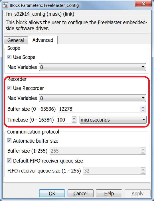

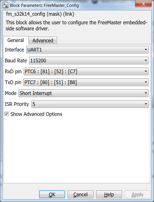

Before generating the C-code for the application and deployment on the hardware, we need to enable and configure the FreeMASTER embedded driver to allow us the visualize the data in real time. Since most critical part of the V/F control algorithm is done in the FAST loop that is executed at each 0.1ms, we will need to configure the FreeMASTER to capture the data in that specific routine.
NXP's Model-Based Design Toolbox lets you configure and call the FreeMASTER anywhere in your model. For this application, since the goal is to check the real hardware data against the ones obtained from Simulink simulation we are going to configure the FreeMASTER as shown in Fig. 22.
Fig. 22: FreeMASTER configuration
Please note that we have configured the FreeMASTER to work in Short Interrupt mode, with a relative high priority - less than the ones needed for actual motor control loops and we have enabled the Recorder option for a timebase of 0.1ms. All these settings and the actual function call for the FreeMASTER Recorder (Fig. 23) are needed to make sure you capture the data in the FAST loop - otherwise we might read wrong data.

EMBEDDED TARGET VERIFICATION AGAINST SIMULINK SIMULATION

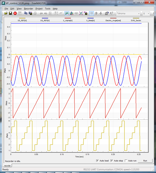

At this point we can run the application on the embedded side and verify the results against the ones obtained in simulation. Since we want to verify the algorithm behavior prior to running the actual motor, then for these kind of tests, we do not have to power on the MotorGD DevKit. This verification step can be done using PIL co-simulation as well but for getting closer to the final application setup, I've choose to run the application completely independent of MATLAB environment. In this case the real time data from S32K are obtained and visualized via FreeMASTER in RECORDER mode. The FreeMASTER project used in conjunction with Simulink model shown in Fig. 13 is attached at the end of the article.

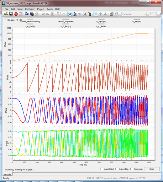

First, we will check the correct generation of the commands for SVM and the PWM duty cycles waveforms associated with these commands. In the next figures, on the left hand side we can see the waveforms generated with MATLAB/Simulink environment in SIMULATION mode while on the right hand side the same data are RECORDED with FreeMASTER on real hardware S32K MCU for the same scenario. As you can see there is a remarkable similarities between these sets of data, giving us confidence that once the PMSM will be connected the motor will behave as predicted in SIMULATION environment.
Fig. 24: SIMULATION vs. REAL Start-up Sequence
(1) Speed Reference Profile, (2)Electric Angle Transformation, (3) Fixed Frame Quadrature Voltages,
(4) 3-phase PWM duty-cycles for each PMSM phase
Fig. 25: SIMULATION vs. REAL Space Vector Modulation in Steady State Regime
Inputs: (1) DQ Frame Voltages, (2) Fixed Frame Quadrature voltages, (3) Electric Angle for 500[rpm] equivalent
Output: (4) SVM Sector Identification

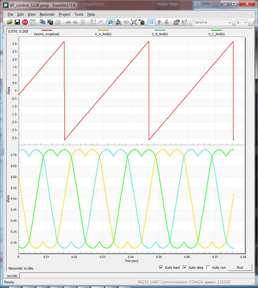

Fig. 26: SIMULATION vs. REAL PMSM Steady State Zoom
(1) Electric angle variation for 500[rpm] motor speed and equivalent (2) SVM 3-phase voltage references

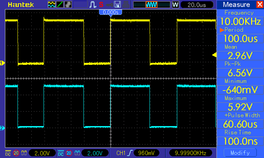

We start with PWM signal generation. The scope of this verification is to check the correct waveform generation (polarity and frequency) and signal integrity (rising/falling slopes, signal levels, dead-time). For this test we are going to use an oscilloscope to scope the digital signals directly on MotorGD DevKit PCB.
Fig. 27: PWM High (yellow) and Low (cyan) Commands
Note PWM HIGH and LOW are configured to be complementary but due to HW restrictions the low side PWM signals are active LOW.
As can be seen in Fig. 27, the PWM signal generation is done correctly with 10KHz frequency and correct polarities based on the settings from Fig. 21.

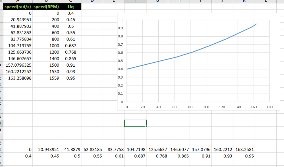

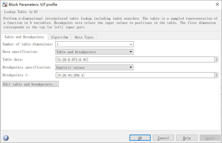

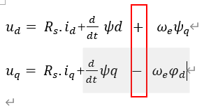

StevZhan
Hi Daniel,
I try get eq3 from eq1, but the result seems should be as follows
the opertion sign before 3rd item is different from eq3, Am I wrong, or is there something wrong in eq1 or eq3 ?  I'm fresh on PMSM theory. Could you pls confirm that? thanks.

Jimny
hello, Daniel
Would you please to explain why the inverter initializing sequence in Control_Logic will execute only once after the reset?
The Control_Logic is in the FastLoopControl subsystem, and it is invoked by function-call, so I think every time the FastLoopControl subsystem is invoked, the Control_Logic will be executed, which means the inverter initializing sequence will be executed.

Jimny
I have a question about the v/f profile LUT. The original data for the LUT is shown below.
I use excel to make these numbers more intuitive.
Since n_rpm = (30 * w_radpersec)/(pi * pp), so 209.4rad/s is equal to 30*209.4/(pi*2) = 1000rpm. And from the plot, it shows the rpm and uq_ref is linear.
From another perspective, the motor (model: 45ZWN24-40) has a rated voltage of 24V and rated speed of 4000rpm. Does it mean that if v/f scalar control method is used and 24V voltage is applied, then the speed will reach 4000rpm? If yes, does it mean the motor will reach 2000rpm when 12V voltage is applied?
What confuses me is that the model outputs 95% of the 12VDC voltage, however the reference speed is only 1000rpm. Should it be 1900rpm? Like the plot shown below.
139,130 Views
hossam_yonis
Hello dumitru-daniel.popa‌,
Thank you for your note, I didn't notice the speed reference.
I updated the LUT, from Uq = 0.45 to Uq = 0.95 and speed from 0 to 1599 rpm.
My questions are:
  1. Why the motor doesn't feel anything under 0.45 Uq ?
  2. I noticed that the motor speed isn't smooth after 1599 rpm, Do you know why ?
  3. Why the Maximum phase voltage is Udc/2  (6 V not 12 V in my case) ?
  4. To reach rated speed, I need to increase the voltage to motor rated voltage and re-figure the LUT , right ?
Thank you.
139,130 Views
Daniel_Popa
Hi [email protected]‌,
I'll try the best I can to explain, but keep in mind that some of my statements are assumptions based on my observations. So, here we go:
We have about 10 motors in our storage, and I've noticed a variation in terms of mechanical and electrical parameters. I think this is an entry-level motor hence some variation is expected.
Furthermore, this is a 24V BLDC motor (the Back EMB is trapezoidal) and we are trying to control it as a PMSM with PWM sine-waves.
If you try to rotate the motor by hand, you will notice a high cogging torque. On top of that, I think there is also some friction that needs to be considered.
Nonetheless, I would expect to have it going with about 0.2Uq@12Vdc which is more or less in the ball parc of such methods.
The motor rated speed is 4000rpm @ 24V (line-to-line). If we can only apply the maximum 12V(line-to-line) then it is safe to consider that we could achieve 2000rpm rated speed if the upper transistors are 100% open. In order to measure the phase currents we need some time to open the lower transistors hence the maximum duty cycle that we can push for with the upper transistors might be ~95% - hence the theoretical max speed decreases to 1900rpm.
Anyway, in closed-loop we are able to drive the motor up to 2000rpm and a bit above in no-load scenario, therefore, I presume the V/f characteristic might play a role in your case. Perhaps you need to make it a bit sharper at the end. Just monitor the Ud - if that increases towards the upper speeds domains, it means the rotor is losing the synchronism.
Typically, you need to consider that sqrt(ud^2+uq^2)<Vdc for stable control
This might take longer to explain - but it is related to the 3-phase inverter theory of operation since you need to create +/- sine-wave. I think you will find the explanation in any power electronic book that describes the inverters. FYI, here is a quick link that I hope will help you clarify the context: https://subjects.ee.unsw.edu.au/elec9711/Section%207%20-%20Inverters.pdf
In the end, the line-to-line voltage will be 12V and this is what matters the most, this voltage drives the motor.
I think so, please see the second answer. Keep in might to verify the Ud and Uq all the time. Ud should be kept at 0. Any voltage drop on D-axis means the rotor angle is not correct, the rotor is no longer aligned with the reference system and you start losing magnetic flux. Basically you are doing flux weakening, hence less torque, more chances to lose the synchronism.
Hope this helps!

I have a question regarding the LUT, and please pair with me a bit :smileygrin:.
You said there are three regions (Compensation, Linear and Field weakening), How this is implemented on the LUT you added - cause I see it's a ramp and not like the image.
and from a theoretical way, how to determine the f_cutoff and f_nominal ? and Is the max F and V (of region three) are the maximum values of the motor ?
another point is to calculate the ratio V/F, Do I need to calculate the ratio based on Vmax and Fmax(speed max) or How to start on this ?
I hope I didn't ask too many questions :smileygrin:

the motor transfer function here is R/(Ls+1)
Is the actual value equivalent to 1/(Ls+R)?

aniket_bagade
Hi  dumitru-daniel.popa
 In FTM Configuration Why do you select PWM Pair 0-1(A) in independent mode and not in Complimentary Mode.
PWM signal to High side and Low side Mosfet Should be Complementary to each other. How Do you Producing Complementary Signal from Channel_0 and Channel_1?
How do you Introducing Deadtime between Mosfet Switching? beacause in FTM PWM Configuration you select Deadtime=0 ticks.
is there any relation of all this settings with PWM_LOGIC subsystem which contain Driver Initialization routine
can you please give detail of how do you generate Complementary signal with Dead time with reference to attached Model.
Aniket
