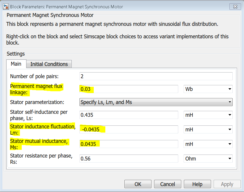

The Simulink model consists in standard 3-phase PMSM motor equations shown in Module 2: PMSM and FOC Theory. Within the model you can easily identify:
  • stator windings electrical model
  • electro-mechanical model
  • sinusoidal back-EMF model
Fig. 9: 3-phase PMSM model
Note 1: we are not going into details about PMSM modelling since this is not the purpose of this module. Feel free to follow the link indicated in the model to get more details. As usual, if you have any questions about it, feel free to ask.
Note 2: I've choose to implement this simplified model to avoid the usage of other MATLAB toolboxes. If you have access to Simscape Power System you could use one of the motors from there.

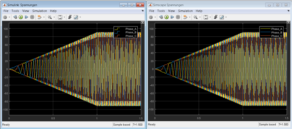

Fig. 10, 11 and 12 show the main control signals and outputs for each subsystems discussed earlier. At this point we can investigate various quantities that might not be easily accessible on the real plant.
Fig. 10: V/F scalar control commands in case of start-up ramp:
(1) Speed Profile, (2) Electric Angle, (3) quadrature voltage references and (4) 3-phase stator voltages references
Fig. 11: Space Vector Modulation verification: Inputs & Outputs
Fig. 12: PMSM Model Responses in case of start-up sequence:
(1) Command vs. Actual Motor Speed, (2) Rotor angle vs. Rotor position, (3) Stator Currents and (4) Back EMF voltages
As can be seen there is a good match between the results obtained in simulation and the PMSM motor theory. Now that we have built confidence in the results it's time to move on to next stage.

Hi Leon,
That would be the way to go - but i do not have a license to for that toolbox. That is why a built a model using standard blocks - someone suggested that in a different topic and i wanted to highlight how you can check the simulation against the real things.

Here is the comparison of the effects (left old simulink model, right new simscape model):
Please not the Parameters of your Motor:
Here the yellow marked values are not clear for your Motor.
Standard values in the help are:
permanent magnet flux linkage: 0.03 Wb
Ls = 0.0002H = 0.2mH
Lm = -0.00002 H = -0.02mH (which is -1/10 of Ls, so I configured -0.0435mH)
Ms = 0.00002 H = 0.02mH (which is 1/10 of Ls, so I configured 0.0435mH)

The comparison between simulink and simscape voltages deliveres the same result:
The comparision of the old PMSM Simulink model (left) with the new Simscape model (right)

In the simscape pmsm block I've found These Parameters, which are not clear for me ?
Maybe you could explain them ?
Parametrization with Ls, Lm, Ms
- Stator inductance fluctuation, Lm
--> help: Amplitude of the fluctuation in self-inductance and mutual inductance of the stator windings with rotor angle.
- Stator mutual inductance, Ms
--> help: Average mutual inductance between the stator windings.
Parametrization with Ld, Lq, L0
- Stator zero-sequence inductance, L0
--> help: Zero-sequence inductance
