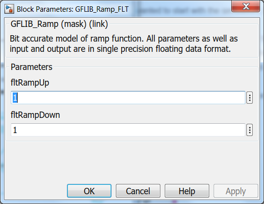

The SLOW Loop Subsystem Fig. 6, updates the commands for the FAST Loop Subsystem shown in Fig. 7. Based on the SPEED_CMD set by the user as motor target speed, a trapezoidal speed profile is generated using a dedicated Simulink block exposed by the AMMCLIB Add-on. Based on this SPEED_REF the electrical angle used for Inverse Park transformation is going to be derived.
Fig. 6: SLOW control loop model
The quadrature voltages alpha-beta are computed based on the electrical angle and the (dq) reference voltages obtained in SLOW Loop. In case of UD_REF the value is set to 0 just to emulate the theory behind FOC and in case of UQ_REF the value is obtained from a Look-Up-Table (LUT) that implement the concept of V/F scalar control.
Fig. 7: FAST control loop model
At each 0.1ms the PWM commands are computed and updated based on AMMCLIB specialized Simulink block that implements and optimized Space Vector Modulation with 3rd harmonic injection. These PWM commands are then passed to the next subsystem that emulates the operations for power inverter.

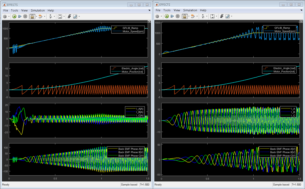

MATLAB SIMULATION OF THE PLANT
The entire V/F scalar control algorithm (...and not only) can be validated using this simulation environment provided in MATLAB/Simulink. This way we can validate the Space Vector Modulation, V/f scalar control and PMSM motor dynamic responses even without having the actual hardware setup. For those of you planning to use NXP hardware in the future, this approach might be useful in getting familiar with motor control.
Fig. 10, 11 and 12 show the main control signals and outputs for each subsystems discussed earlier. At this point we can investigate various quantities that might not be easily accessible on the real plant.
Fig. 10: V/F scalar control commands in case of start-up ramp:
(1) Speed Profile, (2) Electric Angle, (3) quadrature voltage references and (4) 3-phase stator voltages references
Fig. 11: Space Vector Modulation verification: Inputs & Outputs
Fig. 12: PMSM Model Responses in case of start-up sequence:
(1) Command vs. Actual Motor Speed, (2) Rotor angle vs. Rotor position, (3) Stator Currents and (4) Back EMF voltages
As can be seen there is a good match between the results obtained in simulation and the PMSM motor theory. Now that we have built confidence in the results it's time to move on to next stage.

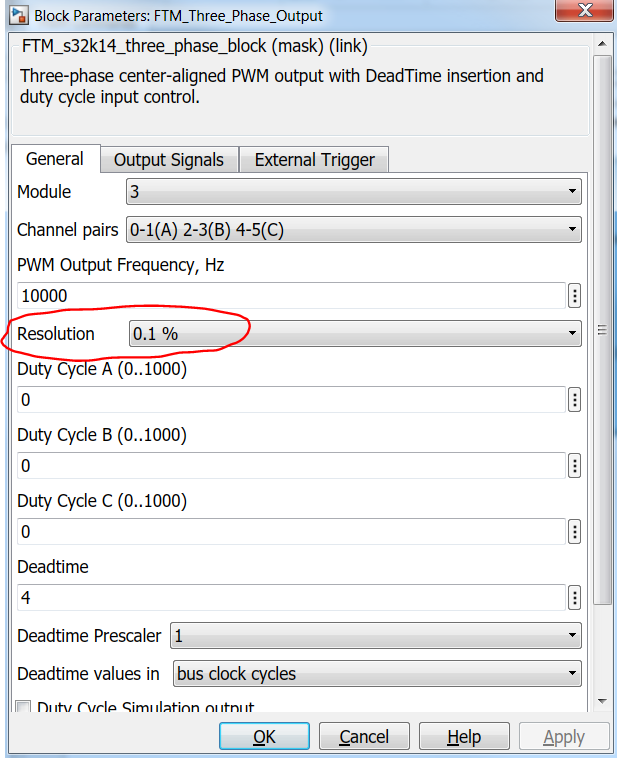

The most important aspect of the whole application is to be able to generate the PWM signals based on the Space Vector Modulation technique and pass these signals to MC34GD3000 pre-driver. NXP's Model-Based Design Toolbox for S32K1xx address this issue in a very simple and convenient way by providing a S32K dedicated peripheral block for FTM as shown in Fig. 1
Fig. 17: PWM generation in Simulink modelling vs. PWM generation used for code generation on S32K
The FTM Simulink block is configured to initialize the FTM3 module since the output signals from that specific module are routed on the PCB to control the actual power inverter MOSFETs. The schematic for the MotorGD DevKit Fig. 18, shows the actual signal routing.
The MotorGD DevKit was designed to be compatible with Arduino shields, therefore only some specific signals are available on the pin-headers. In case you design your own power inverter you might need to reconfigure the actual pins that controls the MOSFETs.

Fig. 21: FTM Peripheral Block Configuration for controlling the power inverter from MotorGD DevKit

Hi dumitru-daniel.popa‌
I want to make a second post with your pmsm, which I atteched.
Instead of my Simscape model with my owm Motor here the Simulation with a fixed step solver works.
So it has to do with the Parameters of the pmsm block why this don't work with my Motor.
The structure of the model is the same like obove.
Here is the comparison of the effects (left old simulink model, right new simscape model):
Please not the Parameters of your Motor:
Here the yellow marked values are not clear for your Motor.
Standard values in the help are:
permanent magnet flux linkage: 0.03 Wb
Ls = 0.0002H = 0.2mH
Lm = -0.00002 H = -0.02mH (which is -1/10 of Ls, so I configured -0.0435mH)
Ms = 0.00002 H = 0.02mH (which is 1/10 of Ls, so I configured 0.0435mH)

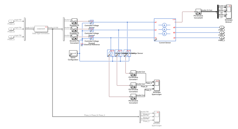

I've tried something with Simscape Power Systems Toolbox. I know this is not the right place for questions about this but maybe you could help anyway.
first I get this error with a fixed step solver so I switched to a variable step solver, which leads to very Long Simulation time. so is there an Option to use the fixed step solver again ?
Here's the overview:
And the "Simulink2Simscape" Subsystem:
Here the Simulink Signals are converted with the Controlled Voltage Sources.
The comparison between simulink and simscape voltages deliveres the same result:
The comparision of the old PMSM Simulink model (left) with the new Simscape model (right)

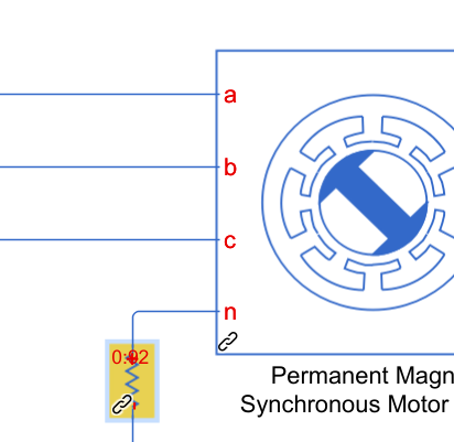

12,493 Views
lethuer
Contributor V
Hi again !
I found the Problem why the Simulation with a fixed step solver did not work.
For this the Solver profiler was very helpful like it is desribed here:
https://de.mathworks.com/help/releases/R2017a/simulink/ug/examine-solver-behavior-using-solver-profi...
After having a look into the tab "solver Exceptions" I found that the resistor on port n of pmsm causes many solver exceptions.
After simply deleting this block the Simulation with fixed step solver works.
Kind regards
Leon
12,471 Views

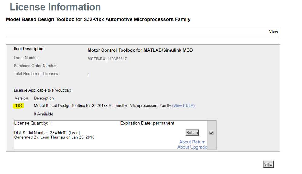

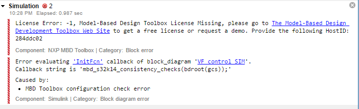

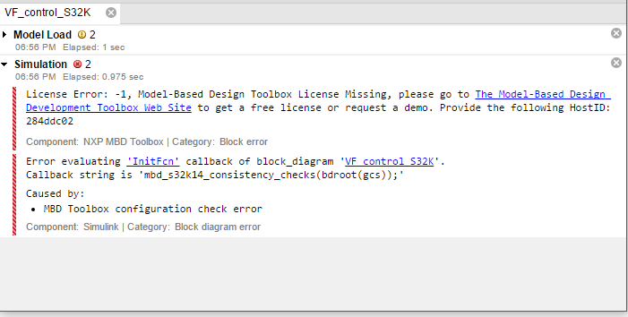

lethuer
Contributor V
sorry for asking again !
After installation the version 3.0.0 Model-Based Design Toolbox for S32K1xx Automotive MCU v3.0.0 I have some trouble with the license file.
I generated a new license file and saved it with the file extension .lic to this folder:
C:\Users\Username\Documents\MATLAB\Add-Ons\Toolboxes\NXP_MBDToolbox_S32K1xx\code\lic
But after simulating your PMSM Module 5 model I get this error:
I really don't know how to solve the problem...
Thank you !
12,521 Views

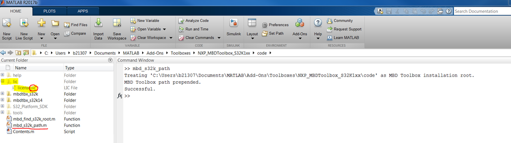

Daniel_Popa
Hi Leon,
That's strange!
You could try to RESET the MATLAB default paths to DEFAULT using the Set Path menu to remove all previous toolboxes from the path (how to here: https://community.nxp.com/thread/449904#comment-908457 )
Then you could simply run the mbd_s32K_path.m to add the S32K1xx into MATLAB.
All these actions are needed to make sure the MATLAB is using the correct paths to the latest toolbox you have installed.
Hope this will resolve the issue.
Thank you!
12,521 Views

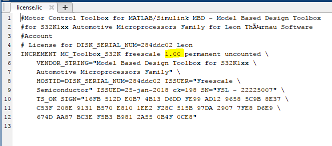

lethuer2
Hello dumitru-daniel.popa‌
also this didn't solve the problem...
Still this buil error:
In R2017b now only the S32K library is implemented.
The license file is saved as .lic and the path was prepended successful.
Here is the content of the license file:
I would excpect MC_toolbox_S32K freescale 3.0.0 ???
I had generated it here:
Thank you for help !
12,519 Views
Daniel_Popa
Hi Leon,
All the steps are OK. The license version is correct and keywords are correct.
Two thinks you could try:
#1: rename the license.lic -> license.dat
or/and
#2: add the lic folder manually to the Matlab paths.
If none of the above does not work - them i'm afraid i'm running out of suggestions.
Hope this helps!
12,518 Views
lethuer2
That was the solution !
#1 It doesn't madder the license file has the extention .lic or .dat.
#2 manually adding the lic folder to the matlab paths solved the problem !
Great job Daniel ! Thank you.
12,518 Views
lethuer2
Sorry, seems I was to fast.
Again I've the license error.
I really don't understand this issue.
As I replied last time I could simulate your 2017b model successfully.
After that I deleted the old S32K Version 2 and Matlab 2016a, which shouldn't have any influences.
So at the moment there is only R2017b and S32K Version 3 installed.
Again I tried to reset the matlab paths, renamed the license file in .dat or .lic, added the lic folder manually to matlab paths...
I'm really sorry for this topic but don't know what I could do...?!

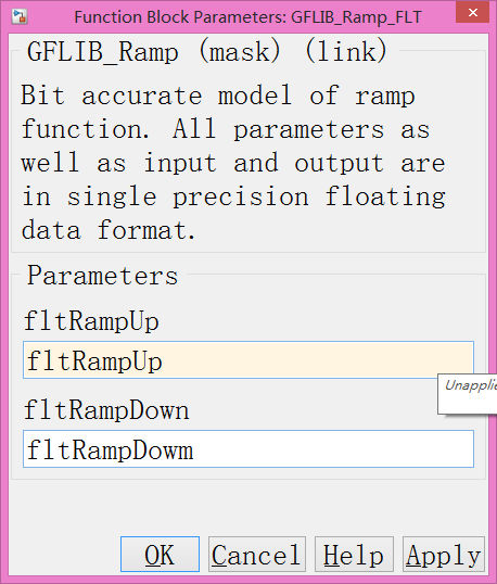

wangxuan
Hi,dumitru-daniel.popa
I really like this article, I downloaded the attachment M5 and wanted to start with the simulation, but when I clicked on VF_control_SIM.slx, I got the following question:
1, Undefined variable "fltRampUp" "fltRampDown" is used in VF_control_SIM / S32K14x EVB / Slow Loop Control / GFLIB_Ramp_FLT. Although other variables do not report an error, I want to know how you defined them.
2,  The floating oscilloscope, when I double-click it, there is a "reference to the non-existent field axes2" error, then double-click will never open.
These two problems have always existed, I do not know how to change, I use the matlab version 2014b.
If you have any possible help, please tell me, thank you
best regards,
wangxuan
12,578 Views
Daniel_Popa
Hi Wangxuan,
Please try to use the model attached ***_2014a (i've exported to this version but did not try it since i do not have such old version)
I think some of the issues are due to import operation.
I the original model the RAMP block is configured as:
You could define those parameters in the MATLAB workspace or Model workspace is case you need to parametrize them.
For the second issue - regarding the floating scope - i do not know what that might be. Again might be due to import from new->old version of MATLAB. Try the model i've added and if still happens then you could try to redue the scope or simple use a standard one to display the variables.
Thank you!

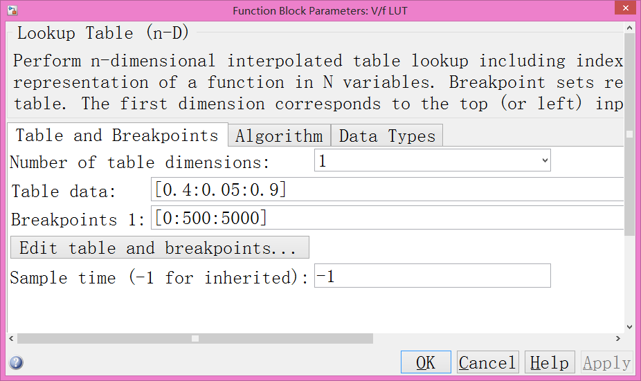

 As you suggested, I modified my model, removed the high version of the Floating scope, added new ones, and worked fine. According to your method, the parameters of the RAMP block have been defined in the MATLAB workspace and the problem has been successfully solved. After learning, I have a few questions to ask you because I am following this example to simulate my target HVP-KV46F150. Thank you very much.
1, UQ_REF the value is obtained from a Look-Up-Table (LUT) that implement the concept of V/F scalar control.but I do not know how the parameters are calculated, in relation to the derived equation u_d / f = (2π) ∙ (L_d i_d + ψ_PM). I want to use HVP-MC3PH, motor parameters are as follows (blue background), how to modify the parameters?

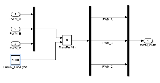

2, in the PWM Commands module, PWM_A / B / C * 1000 (FullON_DutyCycle), why is it to match the real
HW MBDT configuration?

Hi Wangxuan,
That equation is for justifying the mathematical model behing the V/F method and why it can work.
In practice the computations relies on the actual motor rated values for Voltage and Speed(aka frequency)
For your motor the rated values are:pastedImage_3.png
Keep in mind that via the Inverter we control the Phase Voltage.
Depending on your motor connection the relation between Line and Phase is:
  • Y(star) V_line = sqrt(3) V_phase
  • D(delta) V_line = V_phase
The "rated" frequency can be obtained from the rated speed
f_rated [Hz] = Speed_rated [rpm] * pp / 60
If you have a single pole pair configuration: f_rated[Hz] = 3000 * 1 / 60 = 50Hz
So, now you have the 2 values you need for Voltage and Frequency to build your LUT as shown in Fig. 2: V/F profile practical aspects
The zone 1 - needs to be determined experimental based on your particular setup.
Also, keep in mind that all Voltage values used for internal control computations must be scaled between -1 to 1 to avoid any overflows - so UQ_REF maximal value is 1. This corresponds to the maximal value of the Phase_Voltage that is supported by your motor.
For example in the model i've used the 0.9 corresponds to the maximal voltage i'm going to apply for the motor phase. Using a 12V DC power supply then the actual phase voltage allowed in this model is: 0.9 * Vdc/2 = 0.9 * 12 / 2 = 5.4 Volts.
Therefore, from the LUT - i'm going to apply 5.4V on phase if the desired speed is 5000rpm
To start the spinning i'm going to apply 0.4 * 12/2 = 2.4V
Keep in mind that you should only apply higher voltage ONLY when the motor spins. If the motor is not stared to spin and you apply high voltage from the start - then since there is no back-emf - you are going to have a huuuge current flowing thru the motor and inverter. There is a potential danger to destroy them.
The SVM block computes the duty cycles as values between (0 - 1) Normally this should be scaled to (0 - 100) to be used as output for FTM_Three_Phase_Output block
Since the FTM block is set to generate the PWM signal with a 0.1% resolution - then you need to multiply with 1000. This can be changed based on your particular needs.

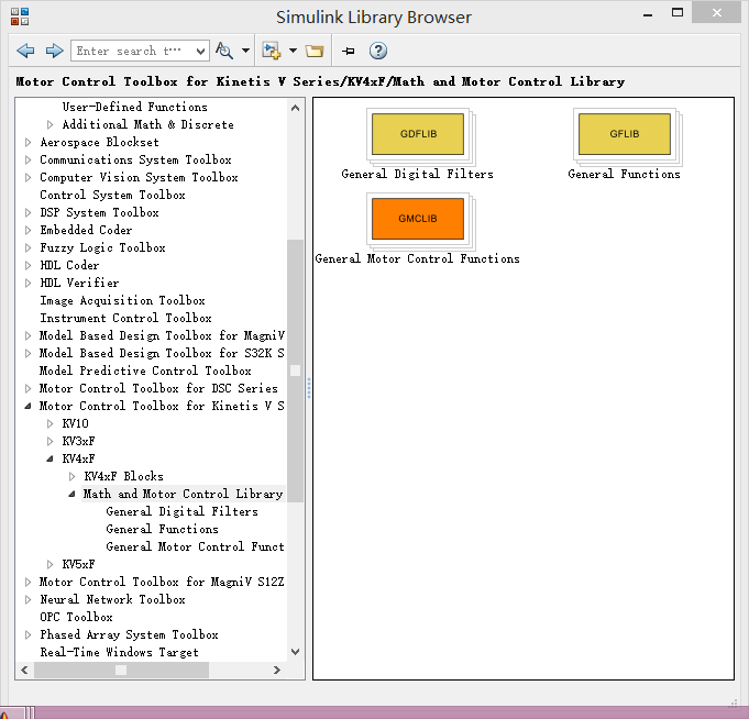

wangxuan
   I saw your reply I understand, very useful, thank you. I saw that the toolbox for Kinetis is really not as rich as K32, just as GFLIB_Ramp_FLT was not found in the KV4 library, how can I replace it? Also, why in the KV4 library,  the models are GFLIB _ **** _ F16, F16 represents the meaning of 16 bits? However, KV46 is 32 MCU, I do not know, thank you.
12,521 Views
Daniel_Popa
Hi Wang Xuan,
Since that is an older toolbox - it is not as rich as the S32K.
The GFLIB_Ramp function limits the rate of change of the input signal. If the desired (input) value is greater than the ramp output value, the function adds the
RampUp value to the actual output value. The output cannot be greater than the desired value.
If the desired value is lower than the actual value, the function subtracts the RampDown value from the actual value. The output cannot be lower than the desired value.
Functionality of the implemented ramp algorithm can be explained in this diagram:
You can easily implement this functionality with standard Simulink block by taking into account the model sample time.
F16 represent the notation for Fixed-point 16-bit fractional: <-1; 1-2-15> in Q1.15 format and with minimum positive normalized value 2^(-15)
