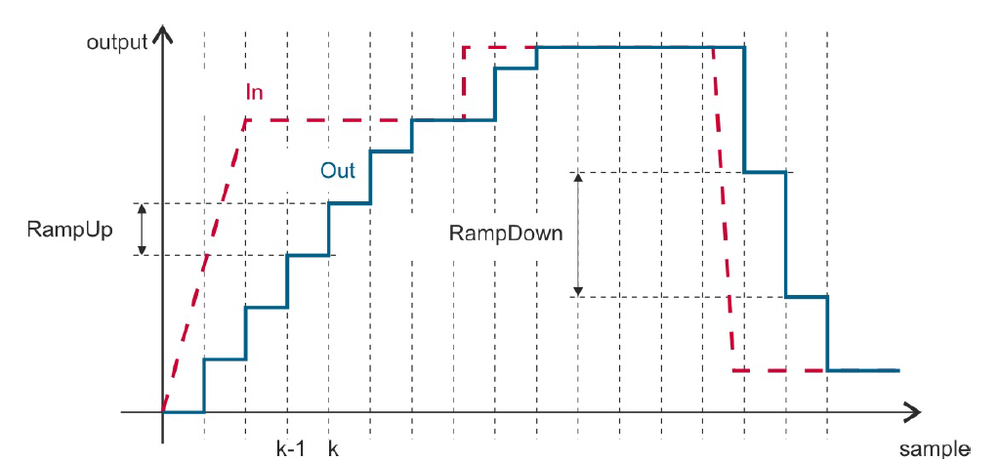

  • FAST control loop is executed at each 0.1ms and computes the PWM duty cycles based on Space Vector Modulation. The reference voltages for (dq)-axes and the motor electrical speed represent the inputs. The electrical angle needed for Inverse Park Transformation is computed based on electrical speed reference.
  • SLOW control loop is executed at each 1ms and provides the voltage references for Inverse Park transformation and the electrical speed profile. Inside this loop, the user commands are handled and based on a parameterisable Ramp Profile the appropriate control parameters are generated. The V/F profile is implemented via a tunable Look-Up-Table (LUT)

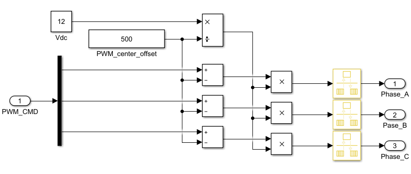

This subsystem implements a basic model to emulate the DC2AC power inverter. The PWM commands are converted into high voltage signals (depending on the Vdc value selected) that are then applied to the motor windings.
Fig. 8: Simplified Power Inverter model

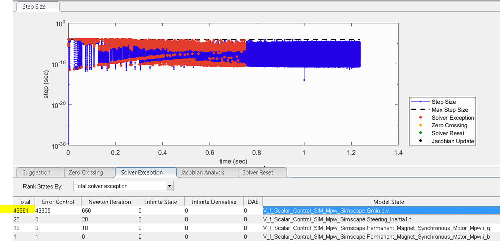

Hi Leon,
That would be the way to go - but i do not have a license to for that toolbox. That is why a built a model using standard blocks - someone suggested that in a different topic and i wanted to highlight how you can check the simulation against the real things.

Hi again !
I found the Problem why the Simulation with a fixed step solver did not work.
For this the Solver profiler was very helpful like it is desribed here:
https://de.mathworks.com/help/releases/R2017a/simulink/ug/examine-solver-behavior-using-solver-profi...
After having a look into the tab "solver Exceptions" I found that the resistor on port n of pmsm causes many solver exceptions.
After simply deleting this block the Simulation with fixed step solver works.
Kind regards
Leon

2, in the PWM Commands module, PWM_A / B / C * 1000 (FullON_DutyCycle), why is it to match the real
HW MBDT configuration?
The SVM block computes the duty cycles as values between (0 - 1) Normally this should be scaled to (0 - 100) to be used as output for FTM_Three_Phase_Output block
Since the FTM block is set to generate the PWM signal with a 0.1% resolution - then you need to multiply with 1000. This can be changed based on your particular needs.
KV4 GFLIB, GMCLIB, GDFLIB tool library and K32 can share?
No, the libraries are different - but there are same functionalities between these 2 toolboxes (the toolbox for Kinetis is a bit older). All you have to do is to re-implement the model this blocks for KV4 library.
I do not quite understand the three-phase inverter model, but it should be the output of the three-phase stator voltage reference value, right, 500 (PWM_center_offset) Why?
SVM defines 2 null vectors - see Module 4: Space Vector Modulation
When you need 0 voltage at the inverter legs - you set a 50% duty cycle of the PWMs that controls the upper and lower switches. Since i've used a 0.1% resolution for PWM duty cyles that means 500 represent the 0v.
Anything above mid-point is a positive voltage and anything below is a negative voltage.

   GFLIB_Ramp_FLT was not found in the KV4 library, how can I replace it?
The GFLIB_Ramp function limits the rate of change of the input signal. If the desired (input) value is greater than the ramp output value, the function adds the
RampUp value to the actual output value. The output cannot be greater than the desired value.
If the desired value is lower than the actual value, the function subtracts the RampDown value from the actual value. The output cannot be lower than the desired value.
Functionality of the implemented ramp algorithm can be explained in this diagram:
You can easily implement this functionality with standard Simulink block by taking into account the model sample time.
