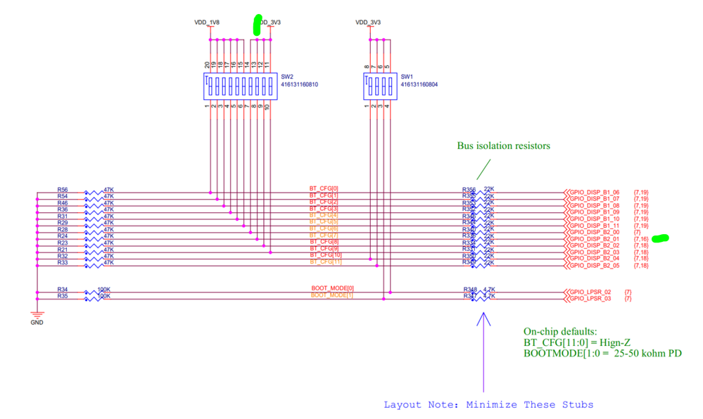

Hi NXP support,
We are working with IMXRT1176 and we are facing some issues.
Here is the context:
Using SAI1 on IMX1176, we are currently trying to use SAI1_RX2 to receive data from a tuner (SI47952) but we only get 0.
IMX is the master, and the tuner is slave.
GPIO DISP_B2_01 is configured as SAI1_RX2
If we monitor the connection, we can see that the signal is squeeze to 0 and almost 0V (see attached picture)
We have done the test of connecting the tuner to SAI1_RX0 (instead of SAI1_RX2) and it we did get the correct signal/data.
That means the issue is on the IMX side, we think this can be a pin config issue as the DISP_B2_01 is SAI1_RX2 and SAI1_TX2 but we don't know how to force RX mode.
Here some SAI1 registry dump during transfers
tcr1: 0x10 tcr2: 0x7000007 tcr3: 0x10000 tcr4: 0x10010f3b tcr5: 0xf0f0f00
rcr1: 0x10 rcr2: 0x47000007 rcr3: 0x40000 rcr4: 0x10010f1b rcr5: 0xf0f0f00
Do you have any idea to unlock this situation ?
Many thanks for your support.

kerryzhou
Hi @eric_delanghe ,
    Thanks for your effort.
  GPIO_DISP_B2_01 is also the BT_CFG[7], and in the MIMXRT1170-EVK board, it connect to the ground through the 47K resistor:
If no external input, it will be 0 in default.
Can you please test it like this:
   I. disconnect your external wave to connect the board,
  2  reset or POR,
   3. after it boot, then connect your external SAI1_RXD[2], and check the wave, whether your external SAI can input the data to the RXD[2]?
  If you still have issues, can you reproduce the issues on the NXP MIMXRT1170-EVK board, then I can help you to test it on my side.
Kerry

Aubineau_FAE
InTCR4, CHMOD bitfield to 0:
On my side I got full range then (3V3).
Vincent
20,105 次查看
eric_delanghe
Hello Vincent,
Yes it work ! I finally can heard FM coming from the Tuner
Thanks a lot for your investigation !
Delanghe Eric

mike_susen
Hi @LydieCDO
Can you share the schematic and code with configuration?
Mike
20,371 次查看
eric_delanghe
Hello everyone.
Thanks for taking this issue
Here the schematic:

are you sure that you not accessing the GPIO registers on this pin? It is not possible to have hard pull-down in this case.
Edit: DISP_B2_01 has internal PD turned on instedad of DISP_B2_06 which has HighZ mode. try to tune SW_PAD_CTL_PAD_GPIO_DISP_B2_01 SW PAD Control
Register (SW_PAD_CTL_PAD_GPIO_DISP_B2_01) to disable PD or switch to HighZ.

Can you confirm you see the signal disappearing if you do the measures on the 2 sides of the resistor, see below:
I have modified the SDK code and configured the pin as below:
 IOMUXC_SetPinMux(
IOMUXC_GPIO_DISP_B2_01_SAI1_TX_DATA02, /* GPIO_DISP_B2_01 is configured as SAI1_TX_DATA02 */
0U); /* Software Input On Field: Input Path is determined by functionality */
IOMUXC_SetPinMux(
IOMUXC_GPIO_DISP_B2_00_SAI1_TX_DATA03, /* GPIO_DISP_B2_00 is configured as SAI1_TX_DATA03 */
and measured the voltage on the switch:
And I see (logic analyser) no contention if I toggle the switch.
Did you check the IOMUX register is configured as expected with a JTAG probe?
Vincent
20,271 次查看
eric_delanghe
I just tried and get the same result on both side of R4261
Also I use gdb to check and registers are right.
Eric
