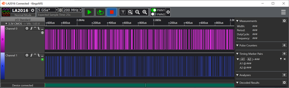

Using SAI1 on IMX1176, we are currently trying to use SAI1_RX2 to receive data from a tuner (SI47952) but we only get 0.
IMX is the master, and the tuner is slave.
GPIO DISP_B2_01 is configured as SAI1_RX2
If we monitor the connection, we can see that the signal is squeeze to 0 and almost 0V (see attached picture)
We have done the test of connecting the tuner to SAI1_RX0 (instead of SAI1_RX2) and it we did get the correct signal/data.
That means the issue is on the IMX side, we think this can be a pin config issue as the DISP_B2_01 is SAI1_RX2 and SAI1_TX2 but we don't know how to force RX mode.

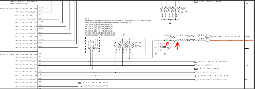

20,154件の閲覧回数
kerryzhou
Hi @eric_delanghe ,
    Thanks for your effort.
  GPIO_DISP_B2_01 is also the BT_CFG[7], and in the MIMXRT1170-EVK board, it connect to the ground through the 47K resistor:
If no external input, it will be 0 in default.

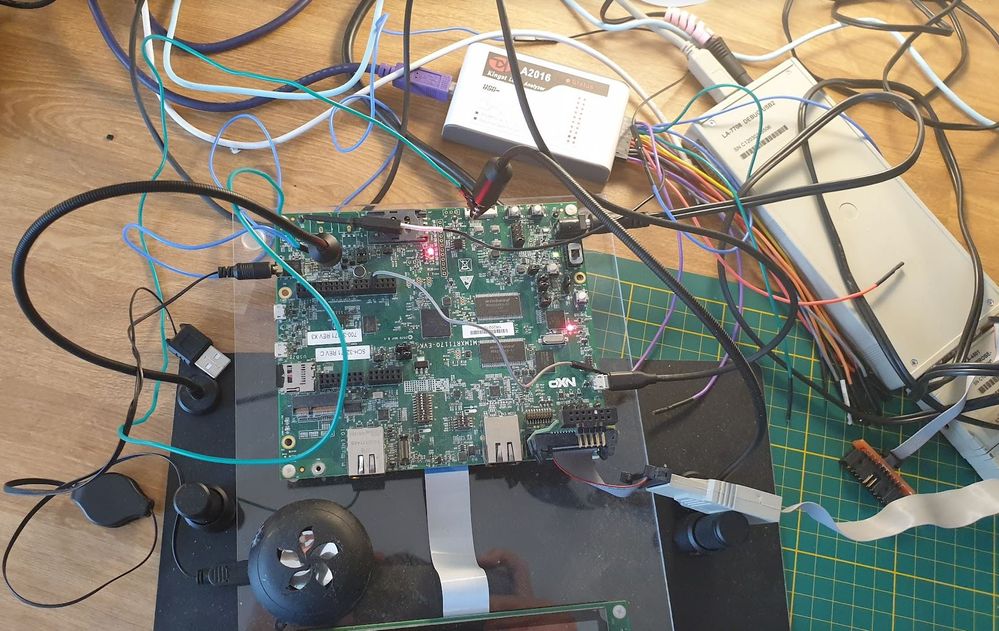

eric_delanghe
I successfully reproduced on EVK
I removed the jumper on J61 and connected a wire from the MCU side of R775 (SAI1_RXD[2]) to J61 on codec side (SAI1_RXD[0])
It mean that ADCDAT of WM8960 is connected to GPIO_DISP_B2_01.
I use the demo code from SDK "boards/evkmimxrt1170/demo_apps/sai/cm7" and do the following change

If I look with the oscilloscope, I get the same result, data is 0.3V when high
20,158件の閲覧回数
Aubineau_FAE
I confirm your code does not work on the EVK ("1. Record and playback at same time" used).
Instead please do the following init sequence:
 /* I2S mode configurations */
//SAI_GetClassicI2SConfig(&saiConfig, DEMO_AUDIO_BIT_WIDTH, kSAI_Stereo, 7);
SAI_GetClassicI2SConfig(&saiConfig, DEMO_AUDIO_BIT_WIDTH, kSAI_Stereo, kSAI_Channel0Mask);
saiConfig.syncMode = DEMO_SAI_TX_SYNC_MODE;
saiConfig.masterSlave = DEMO_SAI_MASTER_SLAVE;
saiConfig.channelMask = kSAI_Channel0Mask;
SAI_TransferTxSetConfigEDMA(DEMO_SAI, &txHandle, &saiConfig);
SAI_GetClassicI2SConfig(&saiConfig, DEMO_AUDIO_BIT_WIDTH, kSAI_Stereo, kSAI_Channel2Mask|kSAI_Channel1Mask);
saiConfig.syncMode = DEMO_SAI_RX_SYNC_MODE;
saiConfig.channelMask = kSAI_Channel2Mask;
SAI_TransferRxSetConfigEDMA(DEMO_SAI, &rxHandle, &saiConfig);
GPIO_DISP_B2_01 (R775) is toggling and I can hear noise in my loudspeaker:
  • Channel 0 -> SAI1_TX[0] (J9 pin 9)
  • Channel 1 -> SAI1_RX[2] (R775)
/Vincent

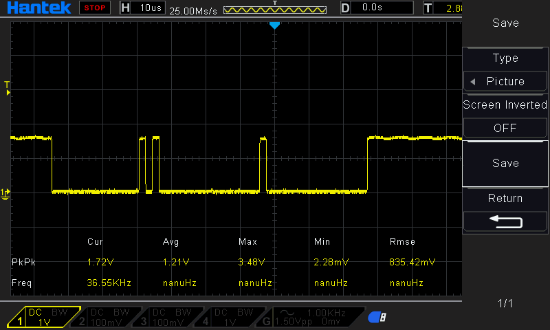

Aubineau_FAE
I did measure with an oscilloscope instead of a logic analyzer.
Actually the voltage level is #1.6V / #1.3V depending of the DSE.
I have the same behavior if I configure the pin as GPIO11_IO2 in output mode (so not 3V3):
We'll get back to you asap.
Vincent
20,104件の閲覧回数
Aubineau_FAE
InTCR4, CHMOD bitfield to 0:
On my side I got full range then (3V3).
Vincent

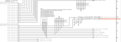

mike_susen
Hi @LydieCDO
Can you share the schematic and code with configuration?
Mike
20,366件の閲覧回数
eric_delanghe
Hello everyone.
Thanks for taking this issue
Here the schematic:
Tuner side:
IMX side:
Here the pin_mux from MCUExpresso config tools

Can you confirm you see the signal disappearing if you do the measures on the 2 sides of the resistor, see below:
I have modified the SDK code and configured the pin as below:
 IOMUXC_SetPinMux(
IOMUXC_GPIO_DISP_B2_01_SAI1_TX_DATA02, /* GPIO_DISP_B2_01 is configured as SAI1_TX_DATA02 */
0U); /* Software Input On Field: Input Path is determined by functionality */
IOMUXC_SetPinMux(
IOMUXC_GPIO_DISP_B2_00_SAI1_TX_DATA03, /* GPIO_DISP_B2_00 is configured as SAI1_TX_DATA03 */
and measured the voltage on the switch:
And I see (logic analyser) no contention if I toggle the switch.
Did you check the IOMUX register is configured as expected with a JTAG probe?
Vincent
20,266件の閲覧回数
eric_delanghe
I just tried and get the same result on both side of R4261
Also I use gdb to check and registers are right.
Eric
