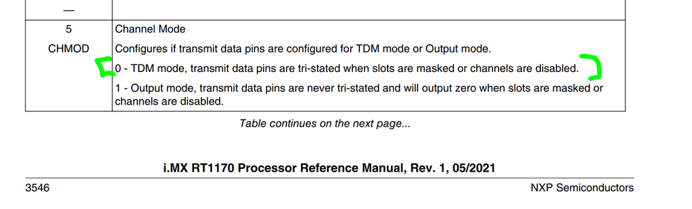

Setting TCR4[5]=0 (CHMOD) will affect SAI1.TX_DATA[0] function in some applications, for example as follow:
SAI1 data line can be configured to Stereo mode, MonoRight mode, MonoLeft mode.
If SAI1.TX_DATA[0] is configured to MonoLeft mode(right channel masked), and SAI1.RX_DATA[1] can receive PCM data(TCR4[5] =0), the right channel data state is determined by the last valid bit of left channel data.
So, I suggest you don't use the TX as MonoLeft mode, just to avoid the limit with CHMOD=0.

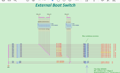

kerryzhou
Hi @eric_delanghe ,
    Thanks for your effort.
  GPIO_DISP_B2_01 is also the BT_CFG[7], and in the MIMXRT1170-EVK board, it connect to the ground through the 47K resistor:
If no external input, it will be 0 in default.
Can you please test it like this:
   I. disconnect your external wave to connect the board,
  2  reset or POR,
   3. after it boot, then connect your external SAI1_RXD[2], and check the wave, whether your external SAI can input the data to the RXD[2]?
  If you still have issues, can you reproduce the issues on the NXP MIMXRT1170-EVK board, then I can help you to test it on my side.
Kerry

eric_delanghe
I successfully reproduced on EVK
I removed the jumper on J61 and connected a wire from the MCU side of R775 (SAI1_RXD[2]) to J61 on codec side (SAI1_RXD[0])
It mean that ADCDAT of WM8960 is connected to GPIO_DISP_B2_01.

Aubineau_FAE
InTCR4, CHMOD bitfield to 0:
On my side I got full range then (3V3).
Vincent

eric_delanghe
Hello Vincent,
Yes it work ! I finally can heard FM coming from the Tuner
Thanks a lot for your investigation !
Delanghe Eric

mike_susen
Hi @eric_delanghe
I've checked configuration with Reference Manual and Pin tool and everything looks correct. Output from tuner has 3-state, Hi-Z, is there any internal pull-up inside tuner? it looks that there is greater pull-down what I see from oscilloscope image.
Mike
20,330 Views
eric_delanghe
Hello @mike_susen
I'll ask tuner team for this but I'm not sure if this is related because if we connect the DOUT0(tuner) on SAI1_RX0(imx) the transfer work correctly.
Eric
20,326 Views
mike_susen
Hi @eric_delanghe
are you sure that you not accessing the GPIO registers on this pin? It is not possible to have hard pull-down in this case.
Edit: DISP_B2_01 has internal PD turned on instedad of DISP_B2_06 which has HighZ mode. try to tune SW_PAD_CTL_PAD_GPIO_DISP_B2_01 SW PAD Control
Register (SW_PAD_CTL_PAD_GPIO_DISP_B2_01) to disable PD or switch to HighZ.

Aubineau_FAE
Can you confirm you see the signal disappearing if you do the measures on the 2 sides of the resistor, see below:
I have modified the SDK code and configured the pin as below:
 IOMUXC_SetPinMux(
IOMUXC_GPIO_DISP_B2_01_SAI1_TX_DATA02, /* GPIO_DISP_B2_01 is configured as SAI1_TX_DATA02 */
0U); /* Software Input On Field: Input Path is determined by functionality */
IOMUXC_SetPinMux(
IOMUXC_GPIO_DISP_B2_00_SAI1_TX_DATA03, /* GPIO_DISP_B2_00 is configured as SAI1_TX_DATA03 */
and measured the voltage on the switch:
And I see (logic analyser) no contention if I toggle the switch.
Did you check the IOMUX register is configured as expected with a JTAG probe?
Vincent
20,243 Views
eric_delanghe
I just tried and get the same result on both side of R4261
Also I use gdb to check and registers are right.
Eric
