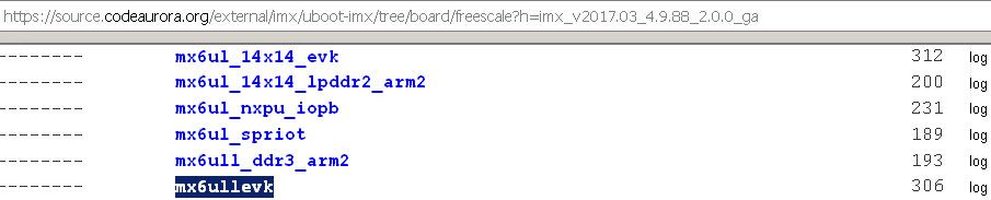

igorpadykov
Hi XH Low
from log it is not MCIMX6ULL-EVK but "MX6ULL 14X14 DDR3 ARM2" and it has
different uboot image:
igor

xhlow
Hi Igor,
May I know where to get this u-boot image?
Thanks.
XH Low
