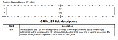

The GPIO_ClearPinsInterruptFlags(IN_GPIO, 1u << IN_GPIO_PIN); refers to GPIOx_ISR register:

EnableIRQ refers to enable the 72 IRQ.
GPIO_PortEnableInterrupts refers to GPIOx_IMR:
