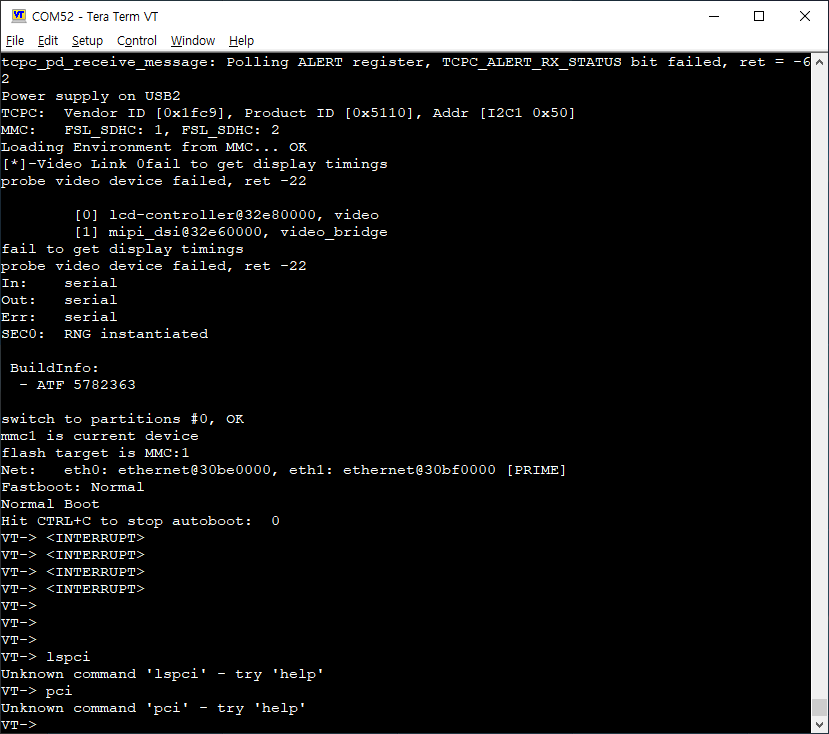

Hi Zhiming :
Currently, we can correctly scan the host through the patch, but when we use PCI enumeration, it seems we cannot scan other devices. How should we modify this part?
Hi.
I'm using i.mx8mp. Currently I can't use PCI related commands in bootloader.
If I apply this patch, will I be able to use PCI commands in bootloader?
Could you also tell me how to apply the patch?
