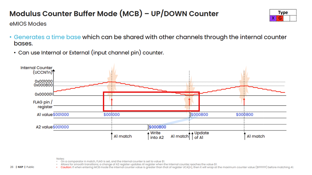

Use OPWMCB mode for complementary (center-aligned) PWM outputs and OPWMT for trigger at half the time high is not possible for the following reasons:
  • Triggering support is only available via flag generation.
  • Synchronization is only achievable for channels that share the same time base.
    • The OPWMCB mode needs to be clocking by another eMIOS channel (MCL driver) in MCB_UP_DOWN_COUNTER, as time base.
    • The OPWMT mode needs to be clocking by another eMIOS channel (MCL driver) in MC_UP_COUNTER or MCB_UP_COUNTER, as time base.
Instead trigger at half the time high with OPWMT, it can be triggered by the MCB mode in UP/DOWN Counter, like the approach in [RTD400 LLD]K344 Center Aligned PWM Trigger ADC BCTU.
But consider following limitations:
  • For OPWMCB mode: it can be only implemented eMIOS channels type G (eMIOS0: ch1-7).
  • For MCB mode in UP/DOWN Counter: It has 2 flags, not only at the center.
For my part, I continue to recommend my previous suggestion.
