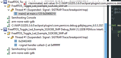

I am tying the FreeRTOS SMP example using S32K388-EVB-Q289. Rev B
I  am using PEMicro Debugger (interface : USB Multilink, port: embedded Multilink Rev A) and I don't have T32
But it seems that only the core master runs and the other smp core is not running if i only use the debug config given.
So i add one more debug config, set core M7_2, try to attach but  "Break at address "0x20402400" with no debug information available, or outside of program code."

I have raised a ticket to the internal team to ask for confirmation whether the example supports PEmicro configuration. As far as I know, the Lauterbach scripts included with the example are needed to start-up core2 and control the program's flow. I've shown how to run the project in this community post: Solved: S32K358 - freeRTOS SMP - NXP Community.
Please wait until I get a response from the corresponding team.

Sorry, talking with the internal team, it seems that FreeRTOS SMP code version running in SRAM does not meet customer requirements (multicore). Also, the FreeRTOS SMP version is a code drop version, so the code may have issues or problems.
For now, FreeRTOS SMP is not working correctly in multicore. Could you help me by entering a support case to continue this internally?
You can enter a support ticket through here: NXP Support.
