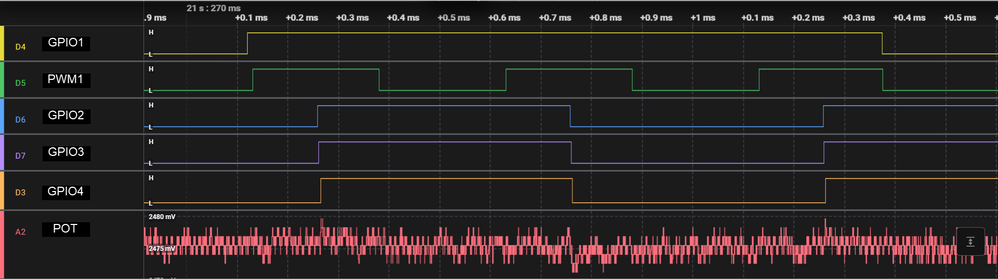

Clock Divider Value from MCL eMIOS_1, along with Compare Value from GPT eMIOS_1_ch_0 generates a time-out period. Once time-out is reached its Emios Notification toggles GPIO1. This allows us to observe in scope 2 events, which mark the start and the end of the signal sequence.
The eMIOS_0_ch_23 channel is configured as global counter bus A. In this setup, it can act as the time base for other eMIOS_0 channels, enabling synchronization between other channels—there is just one PWM in this case. This synchronization ensures that channels share the same time base, thereby defining a common period for their operation.
The emios_0_ch_1_g channel is configured as OPWMT mode, which offer more flexibility for triggering. An interrupt is requested on every flag event, during which GPIO2 is toggled—happens at half the time high in this case. This flag event, can be configured using Trigger parameter. For more details about eMIOS supported features please refer to S32M27x/S32K3 – eMIOS Usage.
The BCTU implements a list for parallel conversions using ADC0 and ADC1. Which is triggered by the eMIOS channel, and the resulting data is stored in FIFO1, as follows:
  • ADC0: VREFH_ChanNum55 -> BANDGAP_ChanNum48
  • ADC1: VREFL_ChanNum54 -> P7_ChanNum7 (POT)
For debugging purposed the GPIO3 is toggled every BCTU Trigger Notification. Additionally, the GPIO4 is toggled in BCTU Watermark Notification, which happens every time the number of active entries in FIFO exceeds the watermark level, and therefore the data is available for reading.
See full signal sequence in Figure 1:
Figure 1. Signals of example project

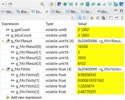

When you suspend debug session, in Expressions tab (Figure 2) you can observe results: g_fifo1Result, which corresponds to the BCTU list measurements, meanwhile g_fifo1Volts corresponds to the conversion in volts.
Figure 2. Expressions tab of example project
