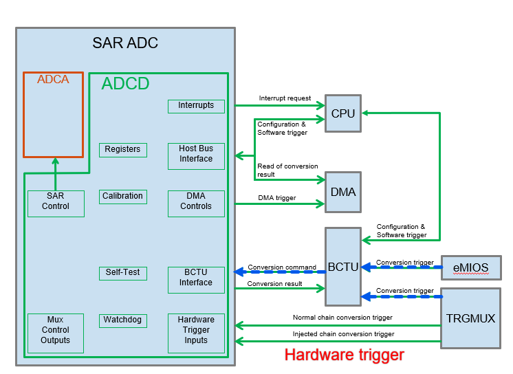

2. Center-aligned PWM center point trigger ADC principle
      Regarding the principle, there is no suspense about ADC. You can directly refer to the previous article on ADC software and hardware triggering:
[RTD400 LLD]K344 ADC SW+HW trigger
This is the structure shown in Figure 2. After configuring ADC, BCTU and select the triggered EMIOS channel. When the relevant flag of EMIOS is generated, BCTU will be triggered. After the watermark is reached, a notification will be generated to store all LIST ADC channel values ​​in the buffer, and then the ADC value can be printed out for easy viewing according to the situation.
  Fig 2
In the current working condition, the logic that needs to be concerned about is mainly: how to generate center-aligned PWM, how to generate a flag at the high-level center point, and use this flag to trigger BTCU sampling.

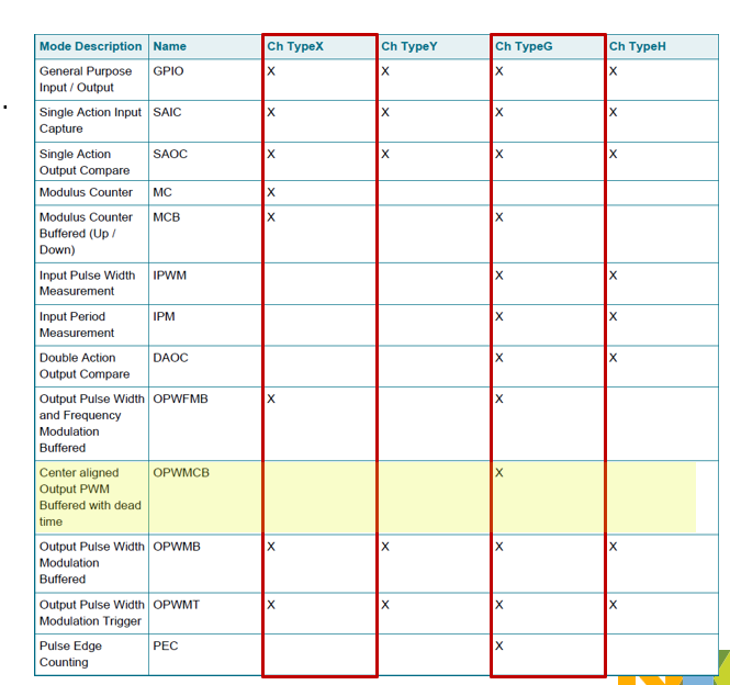

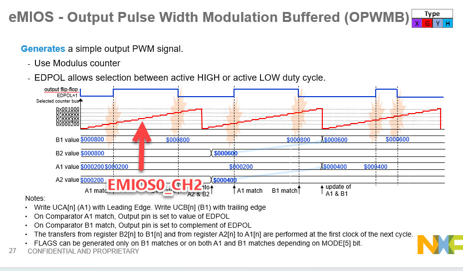

2.1 How to generate center-aligned PWM
     First, let’s take a look at the channel status of EMIOS and the channel status that supports center-aligned PWM.
 Fig 3

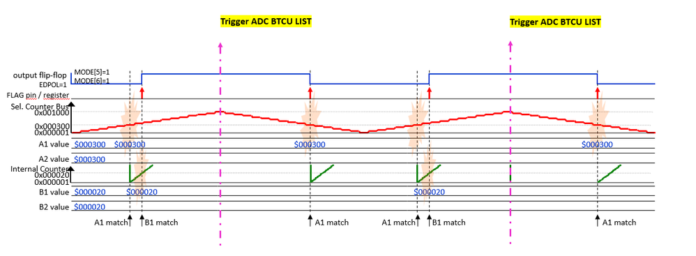

The center-aligned PWM mode is: OPWMCB
As shown in Figure 1, we can see that the counter count mode in this mode is up and down. Let's take a look at the channel types that support OPWMCB. We can see that there is only type G.
 Fig 4

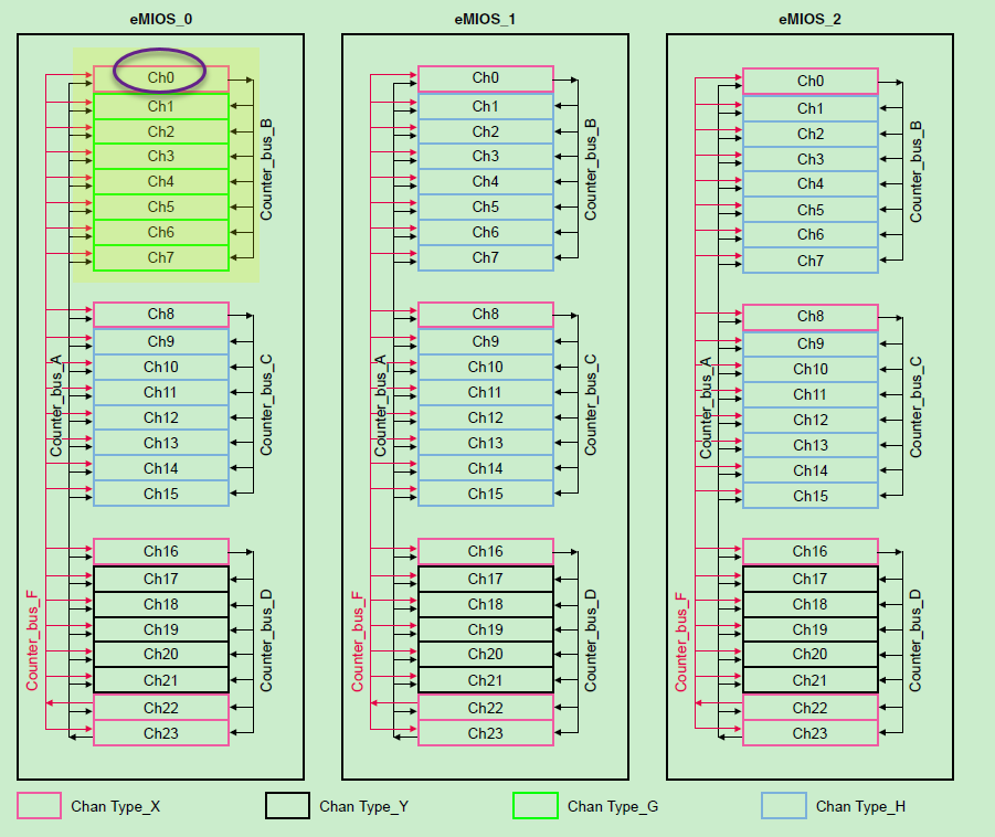

So, what are the channels supported by Type G? See the figure below:
 Fig 5
The mystery is solved. Only CH1-CH7 of eMIOS supports center-aligned PWM.
Well, then a new question arises. Can this mode directly generate a trigger signal at the center point of the PWM high level to trigger the ADC BCTU sampling? Answer: No!
The reason can be seen from Figure 1. In this PWM mode, there are two trigger flags generated when the up and down count comparison is completed. Therefore, if this mode channel is used to directly trigger ADC sampling, two triggers will be generated in one cycle, and both are on the edge of PWM.
Since OPWMCB cannot directly generate a trigger at the center point of PWM, how to achieve it?
In addition, open a dedicated channel, and the clock source is the same as OPWMCB, but that channel only counts to generate trigger flags and does not output any waveform.

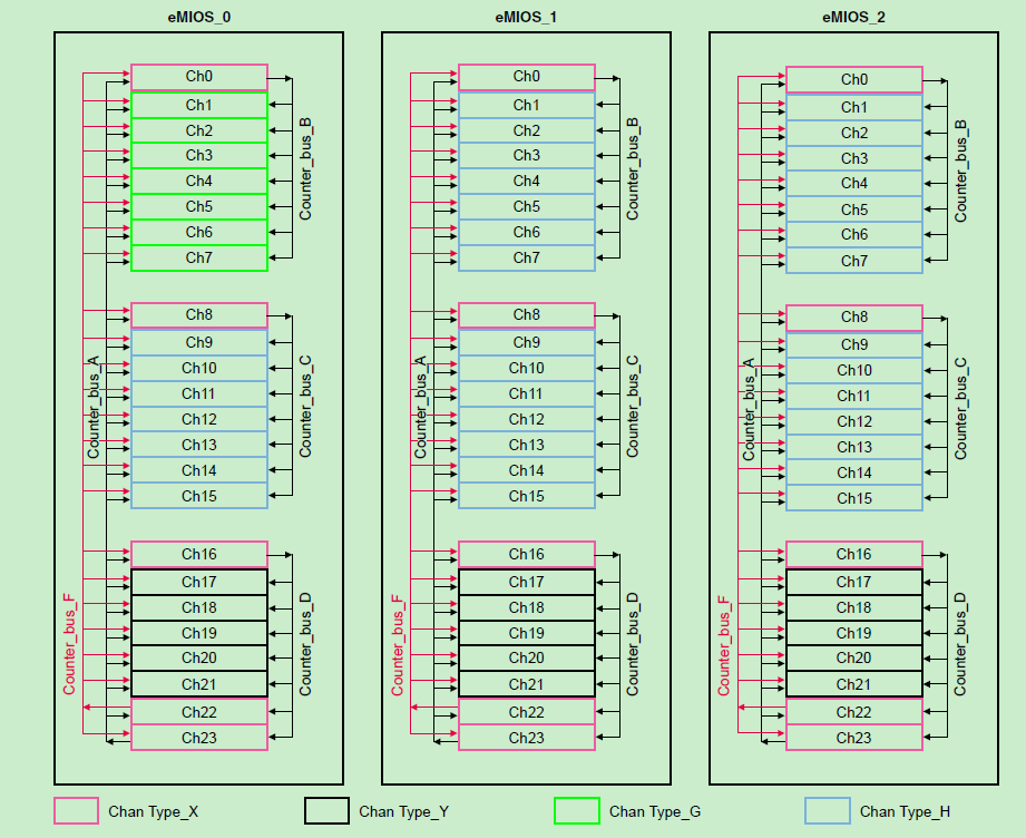

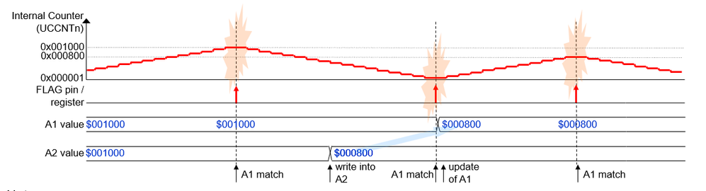

2.2 How to generate PWM center point trigger flag
  Key information: OPWMCB simultaneous clock source, only counting mode, or up and down MCB mode, only one channel is satisfied: ADC CH0, counter bus type also needs to be selected as counter_bus_B
 Fig 6
Let's take a look at the trigger flag of MCB:
 Fig 7
As you can see, it is perfect. The trigger mark is at the top of the upward and downward counting, which is exactly the center point of the high level of the same source PWM.
So, here, the specific channel arrangement has been determined in principle, two channels: EMIOS0_CH0 MCB mode pure counting and triggering the generation of flags to trigger ADC sampling; EMIOS0_CH1-CH7 is OPWMCB mode, simply outputting center-aligned PWM.

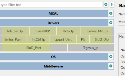

3.1 Demo CT  module configuration
First, you need to prepare a K344 demo, and then configure the pins, clocks, and peripheral modules. The following will explain the configurations. The modules used are: 2 GPIOs, ADC, BCTU, EMIOS clock, EMIOS PWM, LPUART for printing logs, PIT for timed printing, Trgmux is configured but not used in this article, so I won't talk about it!

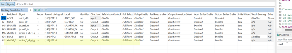

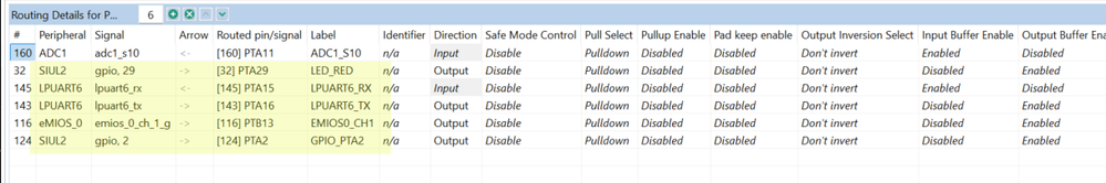

3.1.1 Pin configuation
      The pins used are as follows:
 Fig 8
The two GPIOs are used to toggle in BCTU trigger notification and BCTU watermark notification respectively, to test the waveform positioning. ADC1_s10 pin is used for ADC1, but this article mainly uses BCTU to combine ADC0. ADC0 does not add specific external pins, but uses internal signals. LPUART is used for printing, and EMIOS0_CH1 is used to generate center-aligned PWM waveforms.

3.1.3 Peripheral configuration
      The peripherals used mainly include the following modules:
 Fig 10

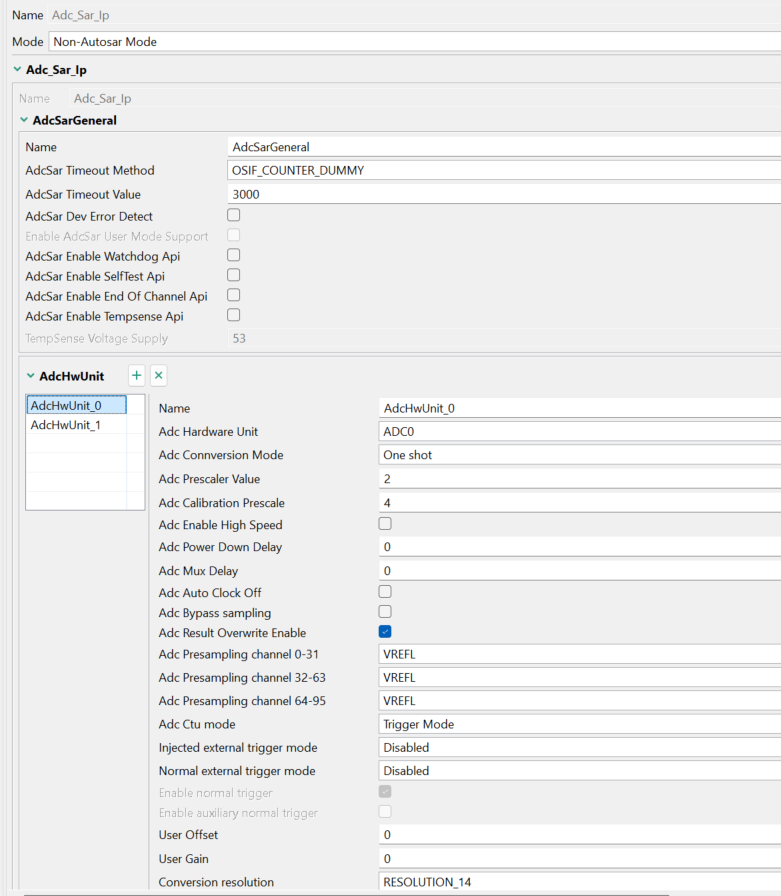

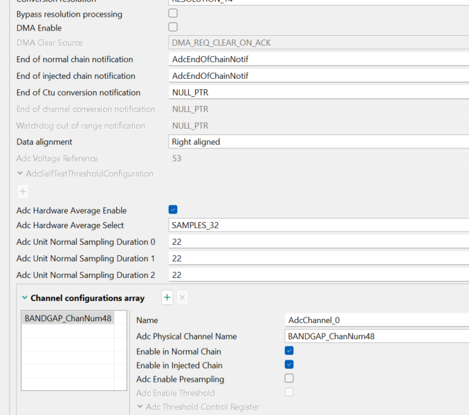

(1)Adc_Sar_Ip
The configuration of the ADC0 module uses the one shot mode, that is, one conversion is generated after one trigger. In this way, the timer EMIOS channel can be used to generate trigger conditions to trigger a conversion. Pre-sampling is enabled to prevent the residual charge of the sampled value of the previous channel from affecting the result of the current channel and causing deviation of the ADC value. The trigger mode uses BCTU. For the configuration of Adc prescaler value and calibration prescale, the frequency division requirements in RM need to be met. The final configuration is as follows:
 Fig 11

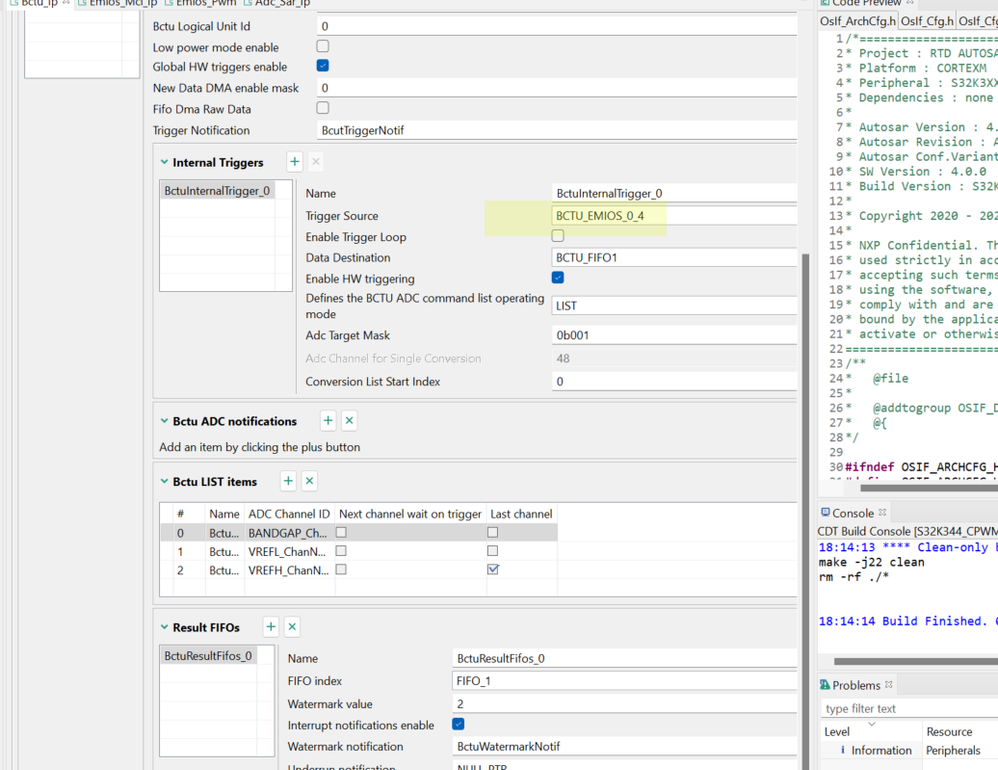

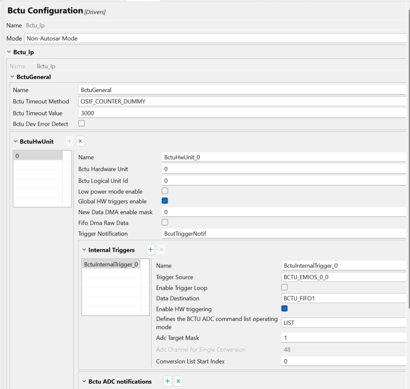

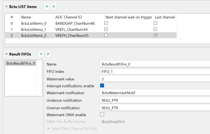

(2)Bctu_Ip
The configuration of Bctu_Ip needs to select the right EMIOS channel to use. From the above principle, we can know that EMIOS0_CH0 is used, and then LIST mode is adopted. For ADC0, three internal channels are currently added to the LIST: BANDGAP, VREFL, VREFH. The specific configuration is as follows:
 Fig 13
 Fig 14

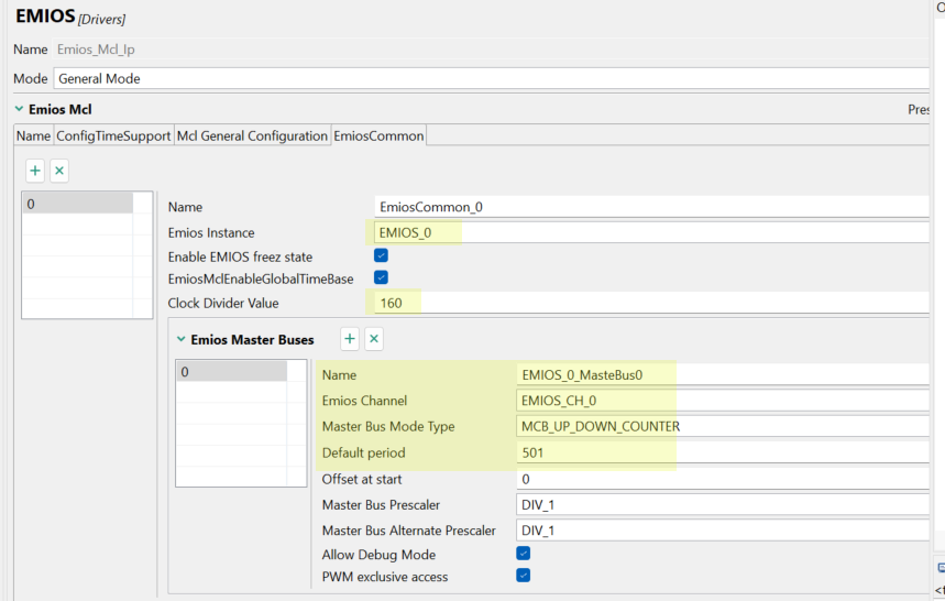

(3)Emios_Mcl_Ip
Here we need to consider the PWM cycle that needs to be generated. The goal is to generate a 1Khz center-aligned PWM, so the EMIOS mode is the MCB up-down counting mode.
The clock cycle formula for MCB is: (2 x AS1) – 2.
So for the EMIOS0 clock source of 160Mhz, what is the corresponding 1KHZ counter? First do 160 divide to get 1Mhz, and then calculate according to (2 x AS1) – 2:
(2 x AS1) – 2 = 1Mhz/1KHZ=>AS1=1000/2 +1= 501.
The configuration is as follows:
 Fig 15

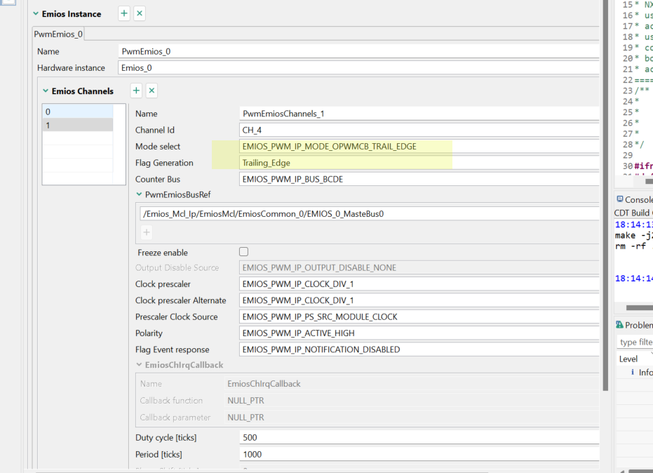

(3)Emios_Pwm
The previous principle analysis shows that the PWM uses the OPWMCB center-aligned mode PWM, the clock comes from the counter bus B of EMIOS CH0, then the period is 1khz, and the duty cycle is 50%. The specific configuration is as follows:
 Fig 16

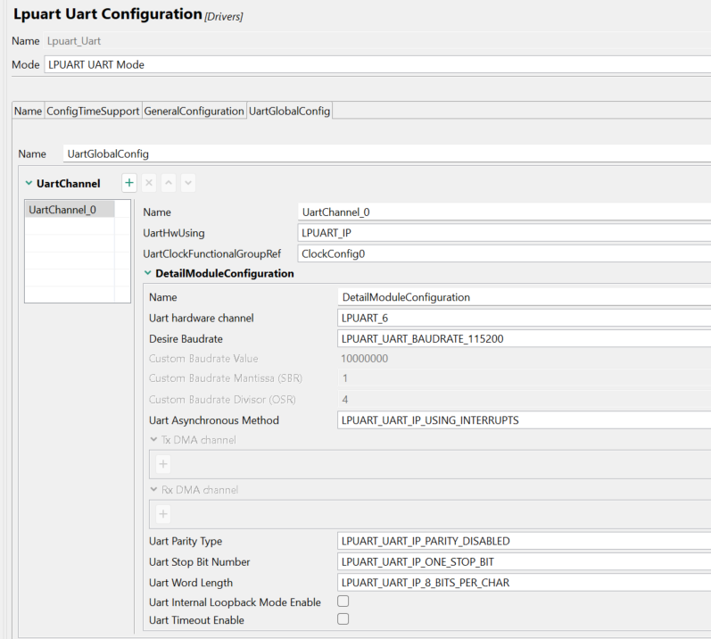

(4)Lpuart_Uart
Configure UART6 clock baud rate to 115200.
 Fig 17

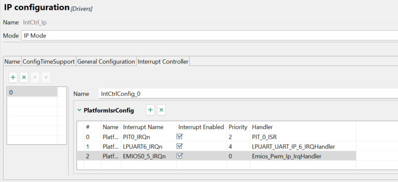

(6)IntCtrl_Ip
The interrupt configuration is as follows, and it can actually be configured via code.
 Fig 19

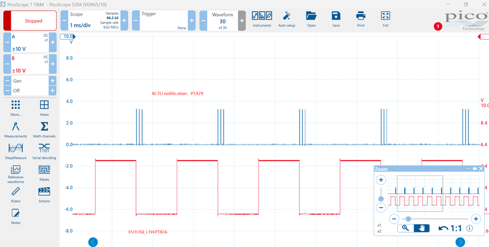

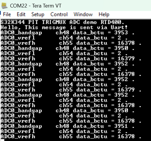

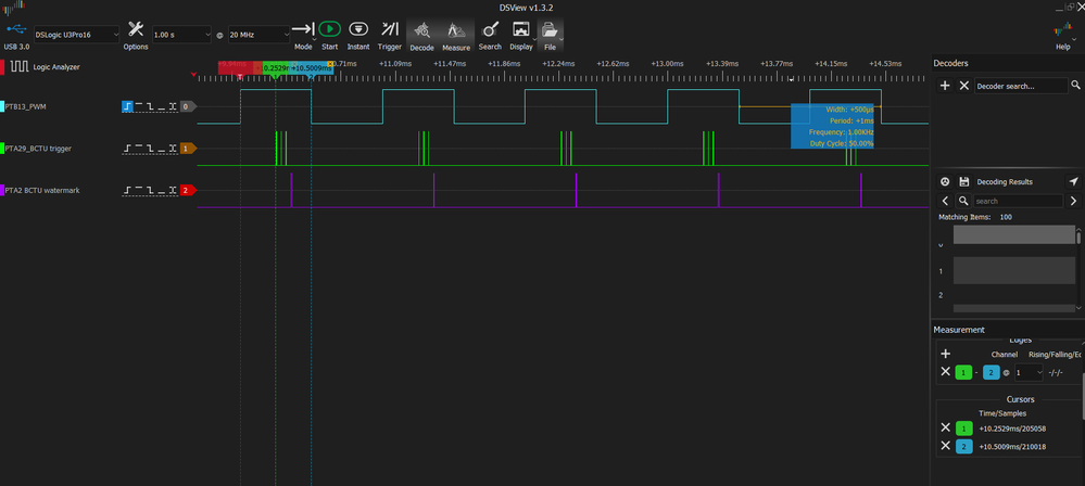

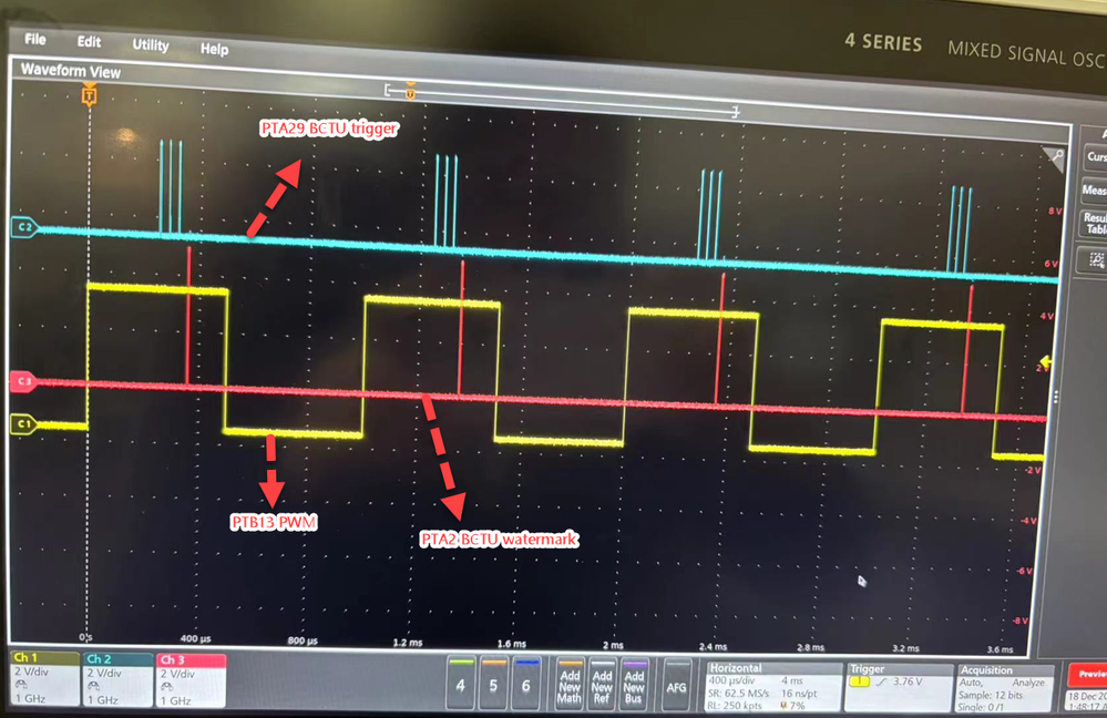

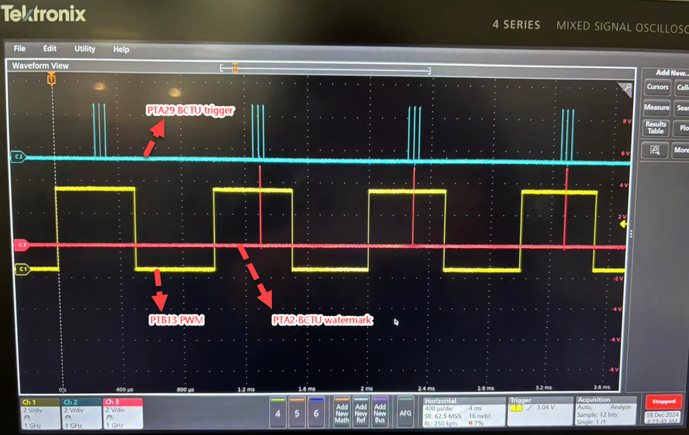

3.3 Test result
   The test results include two parts: the printed results show the ADC sampling value, and the relationship between the PWM output and the BCTU trigger position. The printed results are as follows, and you can see that the values ​​of the three different ADC channels are correct:

PWM wave test result is:
Ch1:PTB13 PWM
Ch2:PTA29 BCTU trigger notification
Ch3: PTA2 BCTU watermark notification
  Fig 21
From the figure, we can see that the first BCTU trigger is at the center point of the PWM high level, and the BCTU watermark notification is used to store data after the ADC sampling is triggered three times.
Here is another waveform to view the PWM cycle:
 Fig 22
It can be seen that the PWM period is 1Khz, the duty cycle is 50%, and the first trigger of BCTU is at the center of the PWM high pulse.

The trip encountered were my own configuration problems. At the beginning, I mistakenly thought that the watermark configuration value was consistent with the number of LIST channels. In fact, the watermark trigger is triggered only when the watermark value is exceeded. Therefore, if it is a 3-channel LIST, the watermark needs to be configured as 2, not 3. If it is 3, the test waveform is as follows:
Fig 23
As you can see, the watermark notification is actually generated after it is triggered 4 times.
Therefore, remember to match the FIFO number of the watermark.

3. Another method of center trigger: MCB_Counter up.
Emios0_CH0 as the counter bus
EMIOS0_CH1 as the PWM output
EMIOS0_CH2 as the center trigger, but no PWM output, OPWMB
S32K344_NCPWM1k1_TRIGMUX_BCTUHWLIST_EMIOS_ADC_printf_RTD400.zip

Some customer need the EMIOS0_CH4 falling edge to trigger the BCTU LIST, the modification is:
Code is:S32K344_CPWM1k_TRIGMUX_BCTUHWLIST_EMIOSch4_ADC_printf_RTD400.zip
Add another type center trigger method, it is using the EMIOS CH0 MCB counter up as the counter bus, EMIOS0_CH1 as PWM output, EMIOS_CH2 OPWMB, trailing trigger.
The test result is:
code is: S32K344_NCPWM1k1_TRIGMUX_BCTUHWLIST_EMIOS_ADC_printf_RTD400.zip
