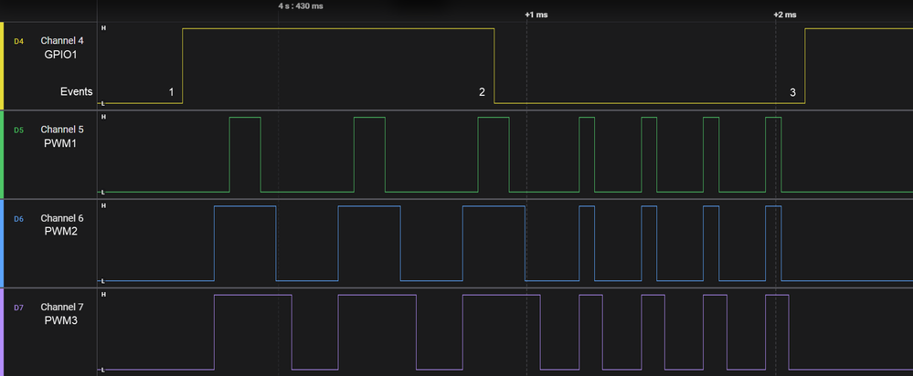

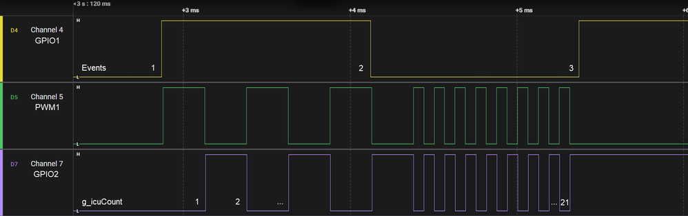

6.1 OPWMB example project
OPWMB generates a simple output PWM signal, using any channel types (X, Y, G and H).
This example implements one channel as GPI (for time reference in scope) and two channels in OPWMB mode initialized as follows:
  • MCL: eMIOS_1
    • Clock Divider Value (global prescaler): 200
  • MCL: eMIOS_0
    • Clock Divider Value (global prescaler): 1
  • MCL: eMIOS_0_ch_23 (Global bus A)
    • Master bus prescaler (UC internal prescaler): 1
    • Default period: 60,000 ticks
    • Master Bus Mode Type: MCB_UP_COUNTER
    • PWM exclusive access: Enable
  • GPT: eMIOS_1_ch_0
    • GptEmiosPrescaler (UC internal prescaler): 1
    • Emios Notification: Enable
    • Emios Channel Mode: EMIOS_GPT_IP_CH_MODE_CONTINUOUS
    • Compare Value: 750 ticks
  • PWM: eMIOS_0_ch_1
    • Counter Bus EMIOS_PWM_IP_BUS_A
    • Flag generation: Trailing_Edge
    • Polarity: EMIOS_PWM_IP_ACTIVE_HIGH
    • Period: 60,000 ticks
    • Duty cycle: 30,000 ticks
    • Phase shift: 0 ticks
    • Flag Event response: EMIOS_PWM_IP_INTERRUPT_REQUEST
  • PWM: eMIOS_0_ch_5
    • Phase shift: 7,500 ticks
    • Flag Event response: EMIOS_PWM_IP_NOTIFICATION_DISABLED
Clock Divider Value from MCL eMIOS_1, along with Compare Value from GPT eMIOS_1_ch_0 generates a time-out period. Once time-out is reached its Emios Notification toggles GPIO1. This allows us to observe in scope 3 events (see Figure 4) that will be described later.
The eMIOS_0_ch_23 channel is configured as global counter bus A. In this setup, it can act as the time base for other eMIOS_0 channels—specifically PWM1 and PWM2 in this case—enabling synchronization between them. This synchronization ensures that both channels share the same time base, thereby defining a common period for their operation.
Despite both channels being synchronized, phase shift feature is possible in this mode. Note PWM2 is phase shifted with respect to global counter bus A, and therefore with respect to PWM1.
An interrupt is requested on every flag event, during which GPIO2 is toggled. In this configuration, the flag is generated on the trailing edge—interpreted here as the falling edge, considering HIGH polarity. Alternatively, it can be configured to trigger on both the trailing and leading edges, allowing interrupts on both transitions.
The three events shown in Figure 4 are described as follows:
  1. Initialization of eMIOS_0 counter.
  2. Set new period for global counter bus A (which means frequency modulation). Set new duty cycle to PWM1 and PWM2. As well as set new phase shift value to PWM2.
  3. Set the state of output pin to LOW, deinitialization of both PWM channels and stop the GPT counter.

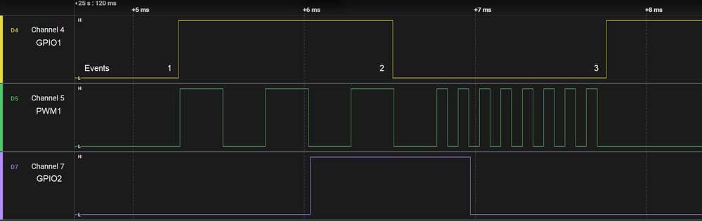

The three events shown in Figure 6 are described as follows:
  2. Set new period for global counter bus A (which means frequency modulation). Set new duty cycle to PWM channels. Set new Trigger placement value to PWM1. As well as set new phase shift value to PWM2.

The three events shown in Figure 7 are described as follows:
  2. Set new period for global counter bus A (which means frequency modulation). Set new duty cycle to all three PWM channels. As well as set new dead time value to PWM3.

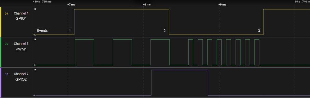

The three events shown in Figure 8 are described as follows:
  1. Initialization of eMIOS_0_ch_1 and eMIOS_0_ch_5 counters.
  2. Set new period and new duty cycle to each PWM channels (which means frequency modulation).

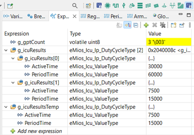

7.1. IPWM example project
IPWM determines the width of an input signal, using channel types G and H.
This example implements one channel as GPI (for time reference in scope) and one channels in OPWMB mode (PWM1) and one channel in IPWM mode (ICU1) initialized as follows:
  • MCL: eMIOS_1
  • MCL: eMIOS_0
    • Clock Divider Value: 1
  • GPT: eMIOS_1_ch_0
  • PWM: eMIOS_0_ch_1
  • ICU: eMIOS_0_ch_5
    • Icu Measurement Mode: ICU_MODE_SIGNAL_MEASUREMENT
    • Icu Signal Measurement Property: ICU_DUTY_CYCLE
    • Icu Sub Mode for Measurement: IPWM
Clock Divider Value from MCL eMIOS_1, along with Compare Value from GPT eMIOS_1_ch_0 generates a time-out period. Once time-out is reached its Emios Notification toggles GPIO1. This allows us to observe in scope 3 events (see Figure 9) that will be described later.
The eMIOS_0_ch_23 channel is configured as global counter bus A. In this setup, it can act as the time base for other eMIOS_0 channels—specifically PWM1 in this case.
ICU1 measures PWM1 twice in code and toggles GPIO2 once the results are available.
The three events shown in Figure 9 are described as follows:
  1. Initialization of eMIOS_0 counter, PWM channel and ICU instance. Additionally it start first signal measurement.
  2. Set new period and duty cycle to PWM1. As well as start second signal measurement.
  3. Set the state of output pin to LOW, deinitialization of PWM channel and stop the GPT counter.

When you suspend debug session, in Expressions tab (Figure 10) you can observe results: g_icuResults[0] corresponds to the first signal measurement meanwhile g_icuResults[1] corresponds to the second signal measurement.

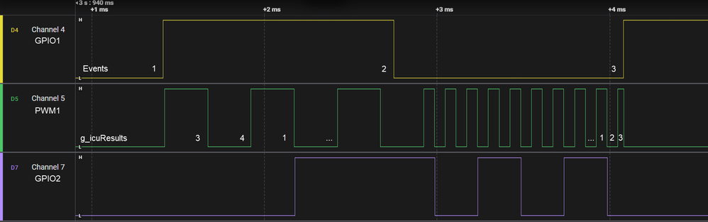

The three events shown in Figure 11 are described as follows:

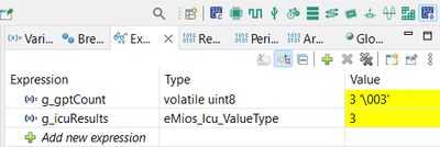

When you suspend debug session, in Expressions tab (Figure 12) you can observe results: g_icuResults[0] corresponds to the first signal measurement meanwhile g_icuResults[1] corresponds to the second signal measurement.

SAIC mode can emulate Pulse Edge Counting (PEC) mode using any channel types (X, Y, G and H).

The three events shown in Figure 13 are described as follows:
  1. Initialization of eMIOS_0 counter, PWM channel and ICU instance. Additionally it sets initial counter value = 2 and max counter value = 4, as well as enables edge count.
  3. Set the state of output pin to LOW, deinitialization of PWM channel, stop the GPT counter and gets edge counter measurement.
Application Software:
S32M276_RTD600_eMIOS_SAIC_Edge_Counter_Ip_example
S32K311_RTD600_eMIOS_SAIC_Edge_Counter_Ip_example
_Leo__7-1751954215826.png_Leo__7-1751954215826.pngFigure 13. Signals of SAIC Example Project – Edge Counter
When you suspend debug session, in Expressions tab (Figure 14) you can observe g_icuResults = 3, which correspond to edge count, after having overflowed 6 times.
Note: ICU is initialized after PWM, so first edge is not counted.
_Leo__11-1751954618542.png_Leo__11-1751954618542.pngFigure 14. Expressions tab of SAIC Example Project – Edge Counter
7.4. SAIC example project – Signal Edge Detect
SAIC mode can also generate an interrupt when detects an edge using any channel types (X, Y, G and H).
This example implements one channel as GPI (for time reference in scope) and one channels in OPWMB mode (PWM1) and one channel in SAIC mode (ICU1) initialized as follows:
  • MCL: eMIOS_1
  • MCL: eMIOS_0
  • GPT: eMIOS_1_ch_0
  • PWM: eMIOS_0_ch_1
  • ICU: eMIOS_0_ch_5
    • Icu Measurement Mode: ICU_MODE_SIGNAL_EDGE_DETECT
    • Icu Signal Notification: Emios0_Ch5_Notification
    • Icu Sub Mode for Measurement: SAIC
Clock Divider Value from MCL eMIOS_1, along with Compare Value from GPT eMIOS_1_ch_0 generates a time-out period. Once time-out is reached its Emios Notification toggles GPIO1. This allows us to observe in scope 3 events (see Figure 15) that will be described later.
ICU1 detect PWM1’s edges and generates an interrupt for each of them. At every interrupt, GPIO2 is toggled and g_icuCount is increased by one.
The three events shown in Figure 15 are described as follows:
  1. Initialization of eMIOS_0 counter, PWM channel and ICU instance. Additionally it enables edge detection.
  3. Set the state of output pin to LOW, deinitialization of PWM channel, stop the GPT counter and disable edge detection.
S32M276_RTD600_eMIOS_SAIC_Signal_Edge_Detect_Ip_example
S32K311_RTD600_eMIOS_SAIC_Signal_Edge_Detect_Ip_example
Figure 15. Signals of SAIC Example Project – Signal Edge Detect

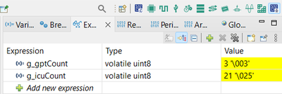

When you suspend debug session, in Expressions tab (Figure 16) you can observe g_icuCount = 21, which correspond to edge count.
Figure 16. Expressions tab of SAIC Example Project – Signal Edge Detect
