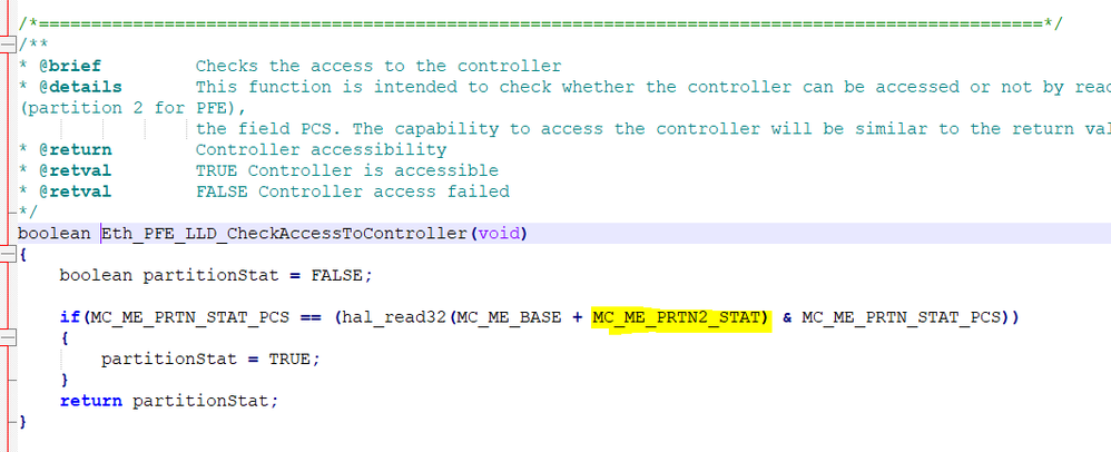

Hello All,
I am working on enable ethernet communication in our project. But Eth_43_PFE driver is not getting initialised. After debugging identified as if condition is not getting passed and partitionStat is not setting  to True. Please guide me to resolve this issue.
* brief Checks the access to the controller
* details This function is intended to check whether the controller can be accessed or not by reading clock partition enable bit (partition 2 for PFE),
the field PCS. The capability to access the controller will be similar to the return value.
* return Controller accessibility
* retval TRUE Controller is accessible
* retval FALSE Controller access failed
boolean Eth_PFE_LLD_CheckAccessToController(void)
boolean partitionStat = FALSE;
if(MC_ME_PRTN_STAT_PCS == (hal_read32(MC_ME_BASE + MC_ME_PRTN2_STAT) & MC_ME_PRTN_STAT_PCS))
partitionStat = TRUE;
return partitionStat;

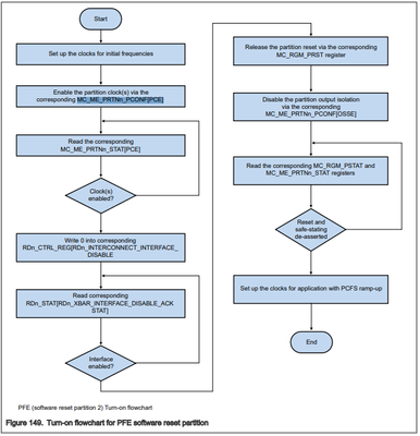

We are facing issues in MCU PFE Partition clock. Only PRTN_STAT0 Clock is active PRTN_STAT1 and PRTN_STAT2 are Inactive. Below the register value of PRTN2_STAT is zero. How can we set this to 1?
We have done MCU configuration. Any Port configurations are required to enable these clocks?
Please see the tresos configuration below.
4,542件の閲覧回数
Daniel-Aguirre
It is said on the S32G2 Reference Manual [Chapter 28.12.7, Page 1079, S32G2 Reference Manual, Rev. 6, 11/2022] that to enable the partition clocks, you should use the corresponding "MC_ME_PRTNn_PCONF[PCE]", is this being done inside the application? Image below:
Please, let us know.
4,417件の閲覧回数
Imsiya
MC_ME_PRTNn_PCONF[PCE] for Partition 0 is enabling from CMM script. We don't have application SWC component to enable the partition clock at the moment.
We tried to enable the Partition 2 clock (MC_ME_PRTN2_PCONF) from the CMM as similar to Partition 0. But still the clock is not activated.
Also we couldn't see the registers for enabling core 0 for partition 2 as similar for Partition 0. Could you please tell, can we enable the partition2 clock from the cmm ? If yes what is missing in our cmm?
